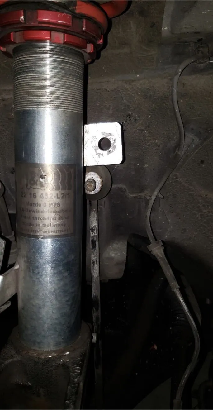

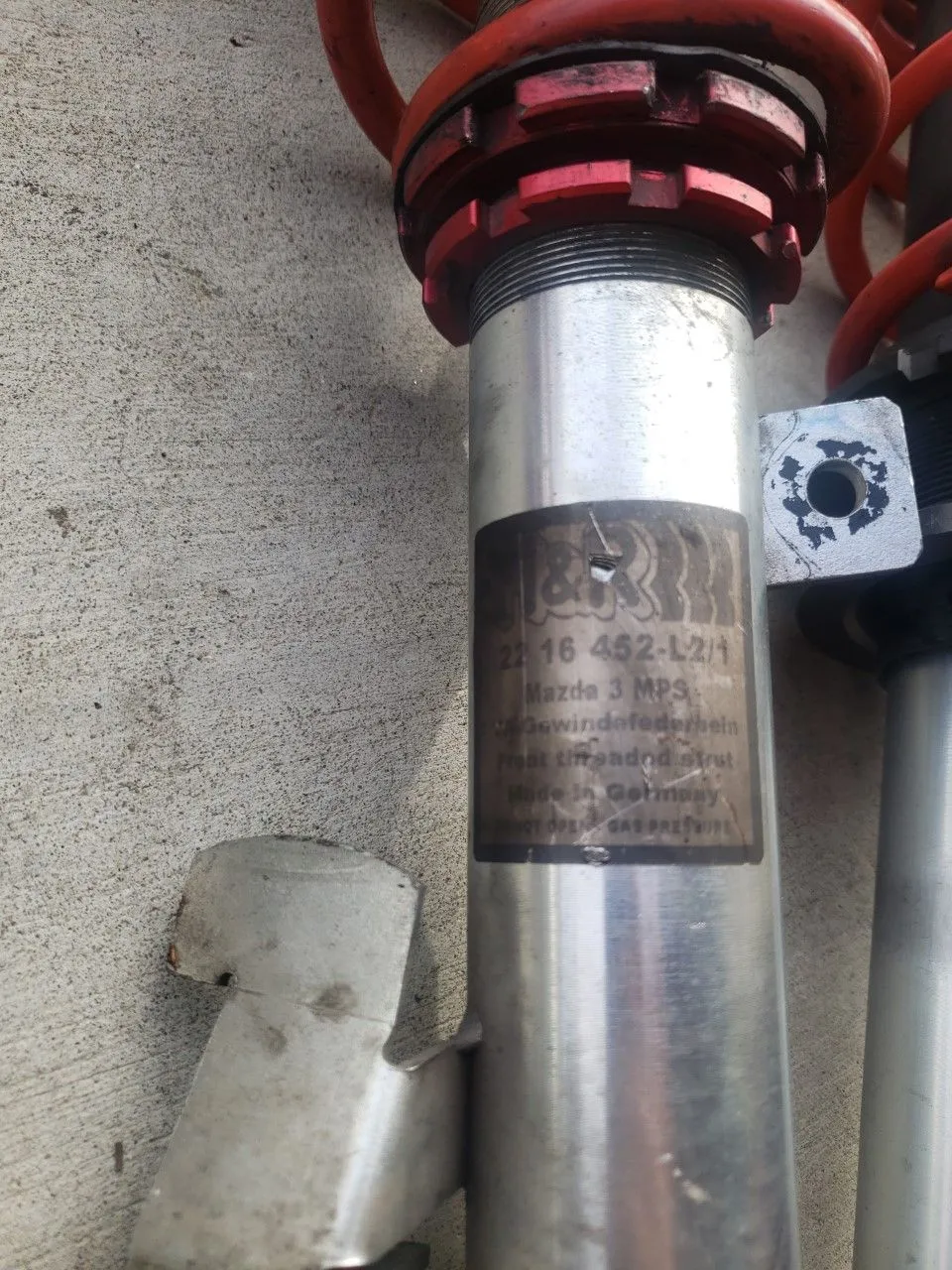

Hi Guys new to the page and looked through the 17 pages in the thread section when searching for H&R coilovers.
I recently got these H&R's that came off a 2008 Mazdaspeed 3 and now I'm trying to fit them on my car and it seems the Front sway bar links will not line up.... What am I missing ? all the other pics I've seen everyone seem to have no issue reusing the OEM swaybar links. could someone please help me out.

Likely the other side needs to be raised up for these line up, the bar works to keep both sides working together. If you have not done the suspension on the other side yet -do it then reattach the bar.
