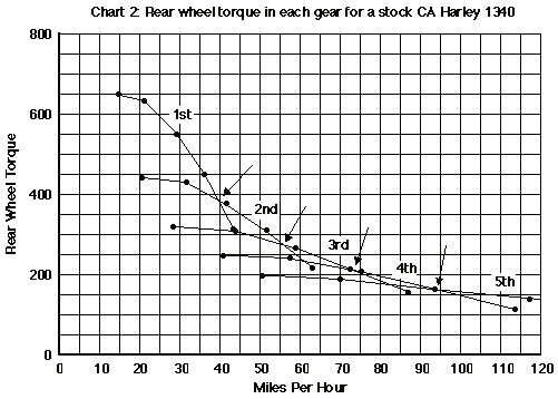

LOL! The gaps in the gears are too wide. Max. acceleration occurs when the shift is made at the intersection of the wheel torque curve of one gear and the next higher. The next higher gear has more available RPM *and* at least the same wheel torque.
Unsurprisingly, this H-D only needs 3 gears (1,3,5), but 5 or 6 sells bikes.
Max accel occurs with the system that has the MOST AREA under the curves. You posted a graph for an engine whose torque falls off massively with rpm. A poorly designed engine.
A perfect engine would have a torque curve that was perfectly flat, horizontal. A million gears still wouldn't make those curves intersect.
No. Acceleration is determined by wheel thrust (F=ma). Thrust is determined by wheel torque and tire friction.
The "area under the power curve" describes the quantity of *work* done, power times time.
You may want to call the H-D engine poorly designed, and I would fully agree, for other reasons, but its torque curve is typical for auto engines. The perfect engine you theorize cannot exist. Fixed ports in the head will necessarily cause a roughly arc shaped torque curve with torque falling once RPM causes flow to become high enough to be restrictive. The point where pressure drops below atmospheric at the intake valve, for instance. Variable intake ports/systems can help, but just make step changes and perhaps an M-shaped torque curve.
So, a real engine, will make the maximum thrust (acceleration) through all the gears when the torque curves intersect below the redline in the lower gear.
What you are literally saying here, is that the CX-5 would accelerate faster, if it's torque was LOWER than the dyno actually measured it. That's insane.
You could argue that if mazda put more, closer gears in the tranny, that the curves might intersect. Or if they put a turbo on the engine, and drastically improved low-rpm torque, that the curves might intersect. But you didn't do that. I guess you just don't have anything better to do?
LOL. I bet he had closer transmission ratios in mind when he made his statement.
A small gap between gears might actually be better than the gears intersecting for acceleration (especially in an automatic) because the momentum of the engine as it spins down during an up shift.
During a shift, the momentum of the engine gives the car a little extra torque kick, effectively moving the wheel torque up slightly on each up-shift.
I did not say anything like that. You fail to understand the concept.
What I said, in effect, was that the car would accelerate harder if it did not have an extra bog/pause at each upshift because there was a large step down in thrust (wheel torque) in each higher gear.
