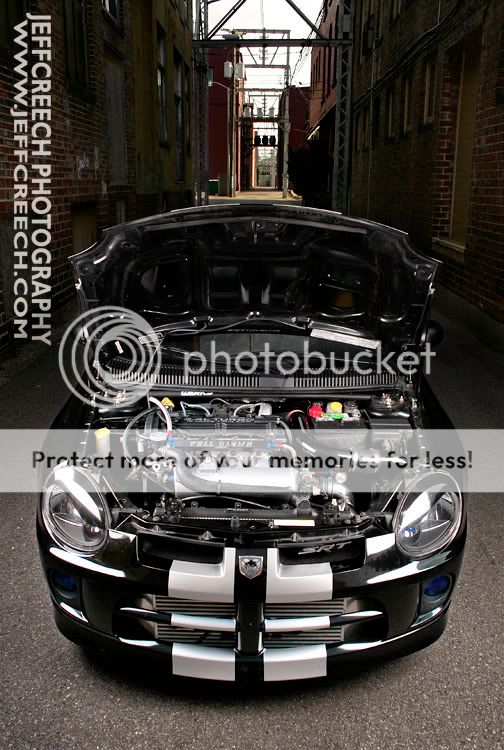

Here is my weekend track car.

thats 1 nasty srt4...my friend has a black acr with silver stripes but hes prob not puttin down the numbers you are thats a huge agp front mount
