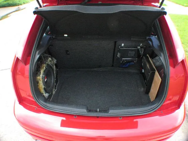

Some pictures of my Focus. Not the most current, but best looking. I never finished the trunk, but you can see my blacked headliner and pillars (use to be gray from the pillars up)
