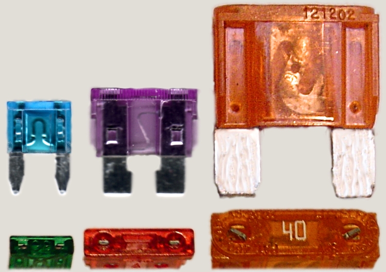

2012-2017 Mazda 5 uses low-profile mini fuses (seen at the lower-left corner of the following photo from wikipedia).
I am using a fuse tap to send power to the two USB dashcams via a step-down converter. The fuse tap has the same fuse type but it won't stay on because the elevated plastic frame surrounding the fuse socket prevents the bulky "head" of the fuse tap from getting the insertion depth it needs to stay on the socket.
