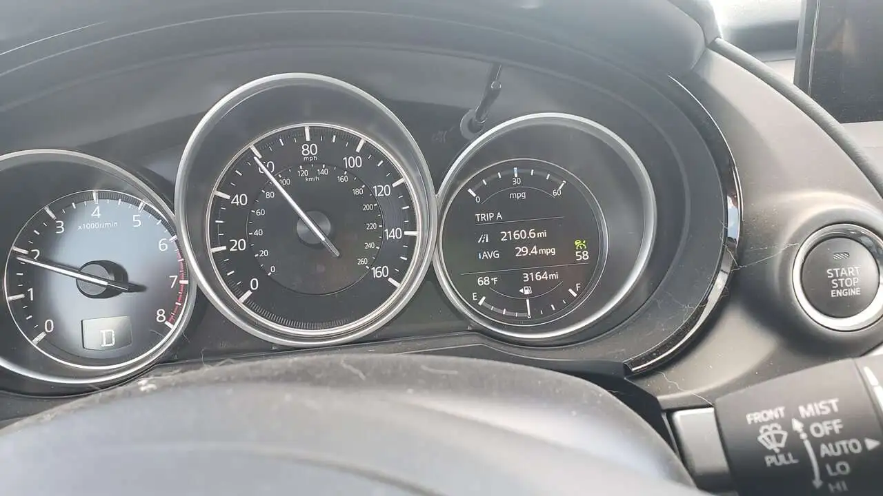

Cross country drive with 87 octane.
Fuel economy plumets above 60MPH in these things largely due to the final gear ratio causing the engine to rotate faster than the average 4 cylinder turbo.
