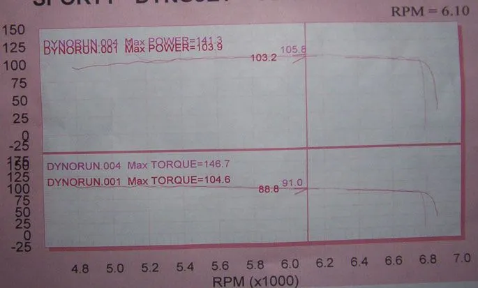

well...I have my dynos...and with intake and exhaust I had 105HP and 103TQ if I remember correctly...that sucks...only good torque.
People, alot of this power nonsense is just marketing..Its all crank HP..For instance. A PDA dyno measures it. Me and kooldino were fooling around with and back in the day my car did like 155hp @ the crank. People seem to not realize this. As for that motor, thats a 626 motor. I had the same thing in my 93 626..Those specs are basically what my motor has now in the DX. Also, just as a back up contingency in case I'm wrong..F is next to the letter D..could just be a typo.
