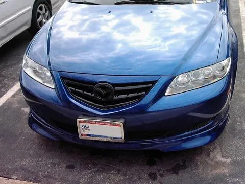

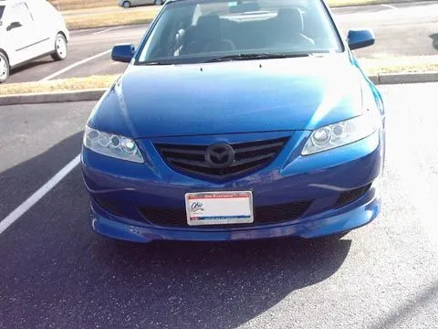

Well ... i switched mine easily took me 10 minutes max ... in your case, I think you should try either pulling and twisting it at the same time or pushing and twisting it at the same time ... also if you had placed it back in the opposite way, the tabs wouldn't have aligned so unless you forced it in, you should be able to pull it out eventually using the push/pull + twist method ... i changed mine to Silverstar 1157s so that it's blue in appearance but blinks amber (rei)
I have the tinted amber bulbs giving off a silver appearance to front end w/o giving off what bulb is blinker. Too bad they got discontinued :(
