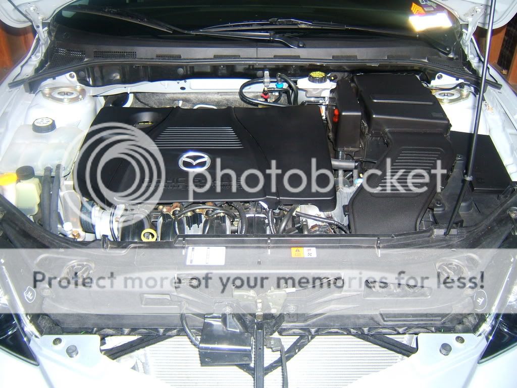

This might be a repost, but I was looking at the air intake for the TMIC and noticed this air passage 'blocked' off by mazda. Its clear that they intended for it to be open at some point or the hole wouldn't be there....but it has the 'blank' now....does anyone know anything about this?
It might be good to take out the blank increase air into the engine bay, VERY cold air while moving right to where the stock air box is intaking. Note I am not talking about leaving piece B uninstalled, I'm talking about removing article A, and reinstalling B. If you look at it closely, even with B reinstalled, it still gets alot of air going to there from front grill.
But I worry is this blanked off for important reasons? To much water while raining? road debris? etc?
Obviously this isn't any serious power increase, but everything helps, thoughts?

Yes very sorry, typo, fixed now. Also yes to the SRI proposal, thats what I'm getting at. You could even cut out those 'cross hatch' plastic pieces in there for further airflow. There is a similar hole on the opposite side, underneath the passenger side 'B' which is NOT blocked off from mazda, so I would assume that its ok to leave the driver side one open. I bet its blocked off for noise reasons, like the bend in the tube coming up off the stock airbox, and like 90% of other airboxes that have restrictors and resonators that just quiet the intake noise for grandma.
Ahh, found a pic of a normal 3 - looks like 'User Name' ^^^^ was right. Looks like the hole is for normal 3s and has a massive duct that 'cools the battery???' Can anyone explain that anyways, do the batteries actually need cooling, or is it just simply an elaborate vent, mazda sure goes to alot of trouble, even on the MS3 with the ducting from the TMIC over to the battery box. Also you would think the TMIC would increase that air temp before going to the battery dramatically.......

Well I decided that the plug is just there, I don't think it will hurt to remove it. In fact I decided to cut out a little of the extra restriction also. I am also thinking about enlarging the hole slightly.....Although I did decide to leave the center brace, in case it provides some type of structural integrity.....
Before/After:
If you put a light source behind the hole inside the engine bay, and then close the hood at night, you can see through the grill that there is definitely a large amount of air that would get through that passage while moving......Next step COBB SRI IMO.

Please read my first post completely, I only have that piece that routes air to the TMIC taken off for picture purposes, it is ABSOLUTELY reinstalled when done. I say this in the first description. But even with that piece installed, if you look under it, the top 2 holes in the front mazda grill feed up into the TMIC, the ones below it will feed directly into the radiator and the hole that I'm talking about being unblocked....

Maybe we're both misunderstanding each other, here are some pics just to clarify my statement, here is the air routing. I am in no way messing with airflow that goes to the TMIC, it is 100% stock. As the pictures indicate, the red holes, and the yellow hole is completely separate, it is very unlikely that my small change to the airflow pathing of the air that is coming in the yellow passage will make a measureable difference to the air which going through the red passages......we're talking wind tunnel measurements here at most, nothing. The only downfall that might occur, is that some air pressure that was originally forced across the engine(water) radiator core is now being allow through that unblocked passage....a worthwhile sacrifice IMO.
