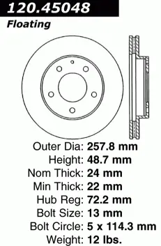

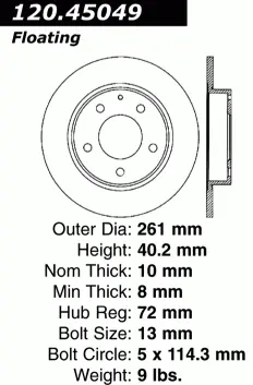

I'm digging this bad boy up because I don't think anyone answered the question, are the front and rear rotors the same size so we don't have to look for individual pairs?
5-lug front:
attachment.php
5-lug rear:
attachment.php
centric part numbers. i just ordered Centric Blank Non Coated Rotors from tri-point engineering (forum sponsor). they do not contain the small bolt hole that normally makes installation a breeze. pictured it would be the smaller top hole in the center. will have to break out hammer if removal of these rotors are necessary in any future project.
