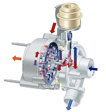

It makes sense, its rather easy to see after knowing how an engine makes power that if you add more air and fuel to the same cylinder, you are able to burn the extra fuel completely and this will result in a larger explosion in the chambermore force on the piston, more power at the wheels. First Ill explain how the turbine is built and works. Then Ill get into how it works for the engine.
Top is a picture of a Garrett T04Z. The Darker side (Iron or Hot Side) is where the exhaust is forced into the Exhaust Inlet.
(Square Flange)
After being forced through the "Hot Wheel" or "Turbine Rotor", it leaves out the round hole on the left of the second picture called the exhaust outlet.
This "Hot Wheel" is connected to a second turbine by a shaft supported by the center section of the turbo called the bearing housing.
This second turbine is housed in the lighter colour side (Aluminium or Cold Side)
It is where the air is taken and pumped at very high speed by the compressor wheel out the compressor outlet.
The turbine is required to spin very fast to pump, in the range of 50,000 RPM to 125,000 RPM.
(125,000 should be considered the point of failure or breakdown)
This shaft must be fed by oil from the engine at all time from a dedicated line from the lubrication system. Filtered oil is sent through the bearing housing and passes around and on the journal or ball bearing. This oil is subjected to massive heat and pressure resulting it the oil being transformed into a milky puss, the better the oil, the better it will stand up to this before breaking down. The oil returns to the lubrication system where it is filtered and pumped again. Most modern bearing housing are also liquid cooled to reduce the heat of the entire area prolonging oil and bearing life.
The Picture of the Bearing Cross section is the Attachment...
The Turbo is like a human heart. All the ports in it have to be hooked up for it to work. This is why it takes alot of time to build a kit from scratch or even bolt up a kit. You can't just install the manifold and wait till next weekend to do the rest.
The fact that a turbo is driven by exhaust gasses and not tied to the motor is its biggest plus. If designed well, a turbo will spool low on the power band and hold max boost all the way through the rev range. A short shift and a well set Blow-off valve will have you back at max boost as soon as you are in the next gear. The result is the engine is receiving full boost for the entire sweep unlike the supercharger that makes peak boost only just shy of redline. If Boost = HP gains, you quickly see how desirable this is. The second Pro for a turbo is that the energy used to turn it is simply a waste product from the internal combustion of the engine. If the turbo adds 100 HP to the engine, on paper you are getting 99 HP at the wheels. The loss is due to the backpressure that is imposed on the engine which can be a factor if the turbo is too small. The process of internal combustion is not perfectly efficient. If it were, all the energy released by the fuel would go directly to turning the crank, but there is heat and frictional loss. There is a lot of loss due to heat, some ends up in the block and is taken away by the coolant. The rest travels out the exhaust valves and expands into the exhaust manifold. This expanding gas spools the turbo as it leaves the car. A turbo reclaims some of that wasted energy to make the car more powerful. It is a real slick refined system.

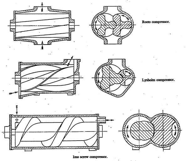

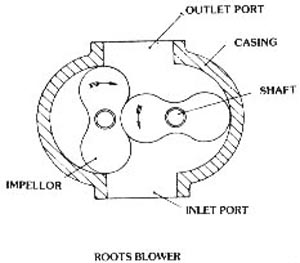

"Roots Supercharger"
Known more commonly as a Blower, Should be considered "Old Tech".
Used in Two Stroke Diesel Engines and many classic Hot rods that are true to their roots.
A large and relitively ineffecient type of supercharger (By Todays Technology). Normally a pair of "Gears" mesh at moderate speed to create positive pressure on the outlet side of the charger. This "Blower" is normalkly bolted directly to the intake manifold, makes very litttle heat in the process of creating boost and has no requirement for an intercooler.
From: http://en.wikipedia.org/wiki/Roots_type_supercharger
The Roots type supercharger or Roots blower is a positive displacement type device that operates by pulling air through a pair of meshing lobes not dissimilar to a set of stretched gears. Air is trapped in pockets between the lobes and carried between the intake side to the exhaust. The supercharger is typically driven directly from the engine's crankshaft via a belt. In order for most typical Roots superchargers to deliver air at greater pressure than atmospheric, they should be geared so that they turns faster than the engine. It is named for the brothers Philander and Francis Roots, who first patented the basic design in 1860 as an air pump for use in blast furnaces and other industrial applications. In 1900, Gottlieb Daimler included a Roots-style supercharger in a patented engine design, making the Roots-type supercharger the oldest of the various designs now available.
Out of the three basic supercharger types the Roots is considered the least efficient. However, it is simple and widely used and thus is invariably the most cost efficient. It is also more effective than alternative superchargers at developing compression at low engine rpms, making it a popular choice for passenger automobile applications. Peak boost can be achieved by about 2000 rpm. Much work has been done to improve the efficiency of the Roots type supercharger, but because it does not have internal compression (the design can be classified as just a "blower") it will never have the same potential as the twin-screw type supercharger, or the centrifugal type supercharger.
All supercharger types benefit from the use of an intercooler to remove heat produced during compression.
The Roots design is commonly used on two-stroke diesel engines, which require some form of forced induction since there is no intake stroke. In this application, the blower does not often
provide significant compression and these engines are considered naturally aspirated; turbochargers are generally used when significant boost is needed.
http://www.dipmec.unian.it/disegno/didattica/modelli/movies/SE Compressore Volumetrico.avi
Here is a link for a Video of a Roots Blower.

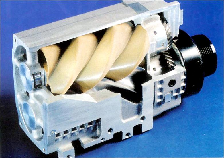

Now we are talking modern.
An Old design that has been refined that is broken down into two basic types.
Eaton Supercharger & Lysholm Supercharger
Eaton Supercharger
"Twin Opposed Counter Rotating Screws"
Like in the Cobalt SS
The screws are kept in time by a driveline. A set of gears normally suspended in oil or fed directly from the block. Being fed from the block will keep the temperature more stable as the oil is constantly being cycled and filtered through the engine.
Seen here attached to the intake manifold of a V8 is the Supercharger, Notice the large belt attached to the crank that drives the supercharger. The top Cover or scoop just helps along. This particular car is Fuel injected and Not Carburated, you can see the row of injectors that add the fuel that is required to power this car under boost.
"Counter Rotating Male and Female Screws"
The Lysholm supercharger looks similar to a helical Roots blower, but with rotors that are far more twisted, and have a conical taper. The result is that these "screw-type" compressors have an internal compression ratio, making them more efficient in high-boot applications. A Lysholm compressor will continue to compress air as long as it is being turned, even if a bypass valve allows that air to be recerculated. The only way to eliminate a Lysholm compressor's parasitic drag at cruise is to let it stop turning via a clutch. This makes it rather difficult to justify in a economy designed car. This should be only considered when high boost pressures with minimal heat and maximum power are needed. This style of Supercharger has a characteristic "Scream" under load.
Just on a side not this is the style I have selected for my 944 Project as I want High Boost with no heat and do not care about fuel consumption under load.
http://www.dipmec.unian.it/disegno/didattica/modelli/movies/SE Compressore.avi
Here is a link for a Video of a Lysholm Supercharger

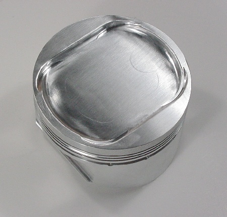

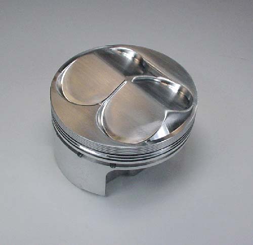

Compression Ratio
Taken from Wikipedia.
The Compression ratio is a single number that can be used to predict the performance of any internal-combustion engine. It is a ratio between the volume of a combustion chamber when the piston is at the bottom of its stroke, and the volume when the piston is at the top of its stroke. The higher the compression ratio, the more mechanical energy an engine can squeeze from its air-fuel mixture. Higher compression ratios, however, also make detonation more likely.
So based on this if you had three identical 2.0L motors all with different compression ratios, 8:1, 9:1, 10:1. They would all make different power. The 10:1 would be the most powerful but it would also be more prone to detonation. You could plan for and reduce the chance of detonation by changing the fuel, intake temperature, colder spark plugs, retarding timing etc...
The compression ratio is based on atmospheric pressure. Now when you pressurize the intake, the compression ratio does not change, but because there is more air in the cylinder to start with, you have effectively increased the compression ratio. The end result is air and fuel being compressed to a much higher pressure than before. This in itself makes more horsepower because there is more air and fuel to burn, but also, the compression in the piston is higher as well. It's wonderful; you get more power from two factors. The increase in pressure has brought the motor much closer to the detonation threshold. The Higher the boost, the more likely is to detonate. So just as before, changing the fuel, intake temperature, colder spark plugs, retarding timing are all factors. You can sacrifice in the design stage of a motor the base compression ratio for the ability to run a higher boost with the same safety margin in regards to detonation. You will loose off boost performance at low RPM compared to a Higher compression, however, as soon as that higher boost kicks in, you will never miss the lower end. This is a factor with turbos and lag.

Here is a High Compression Piston good for N/A Applications..
Low Compression More suited for Forced induction.
