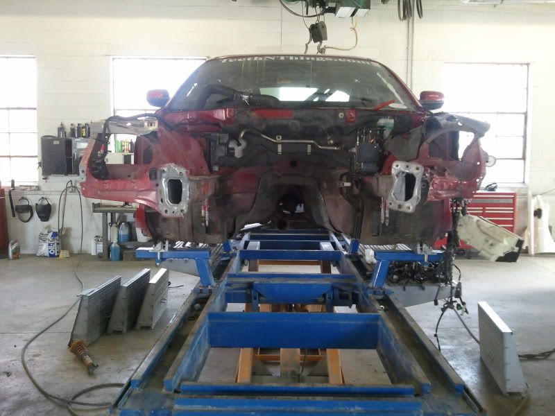

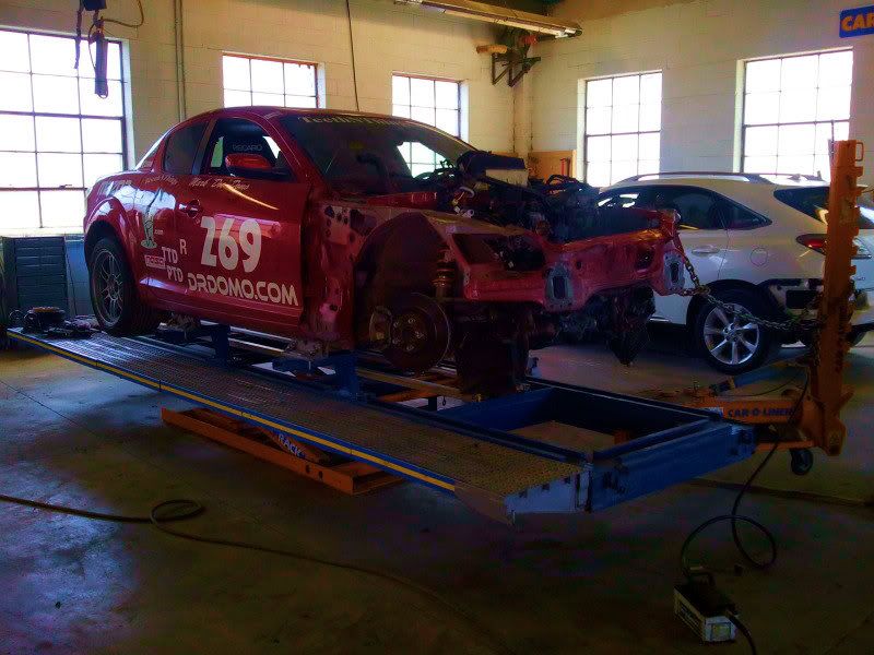

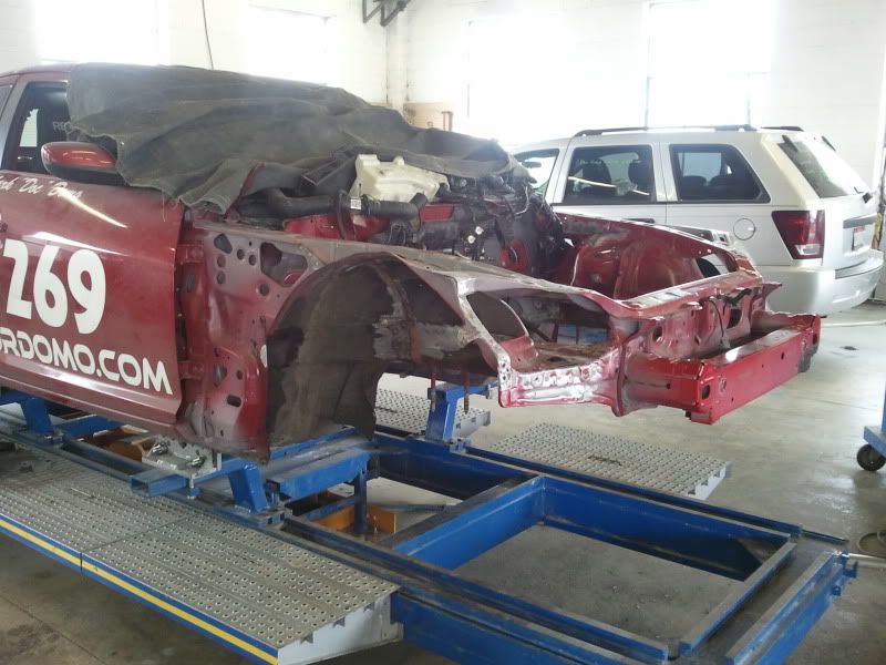

Doc dropped his RX-8 off at my shop last Monday for me to fix. Like my other body shop threads, I'll keep you guys updated on the process!

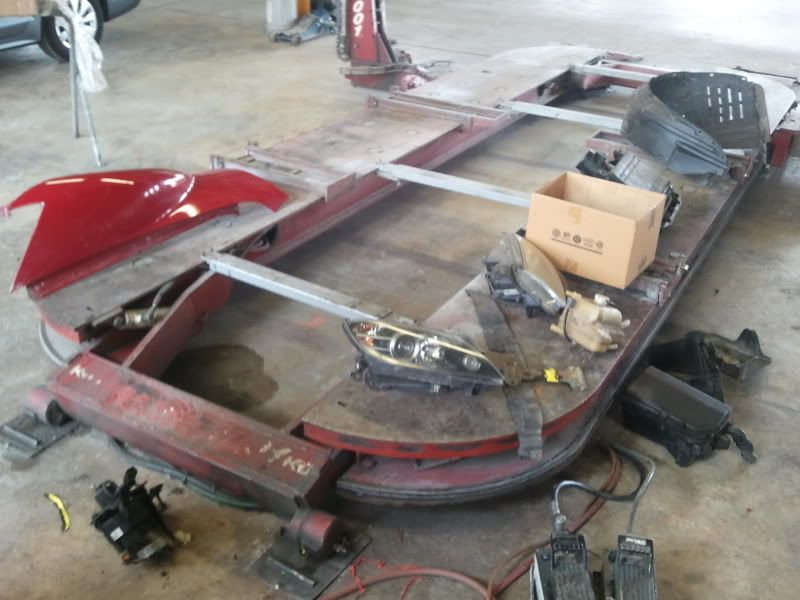

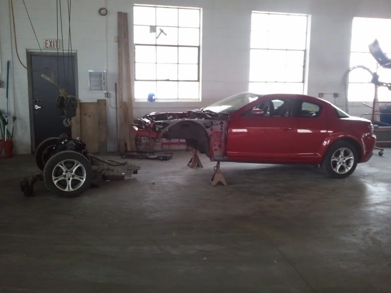

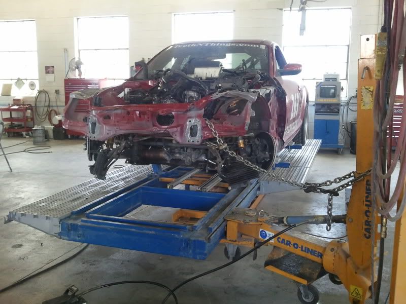

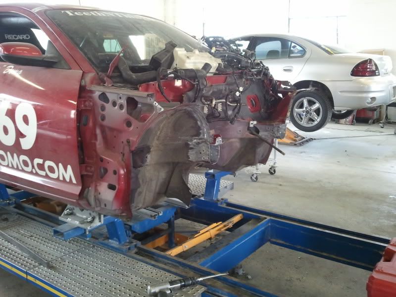

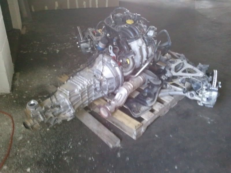

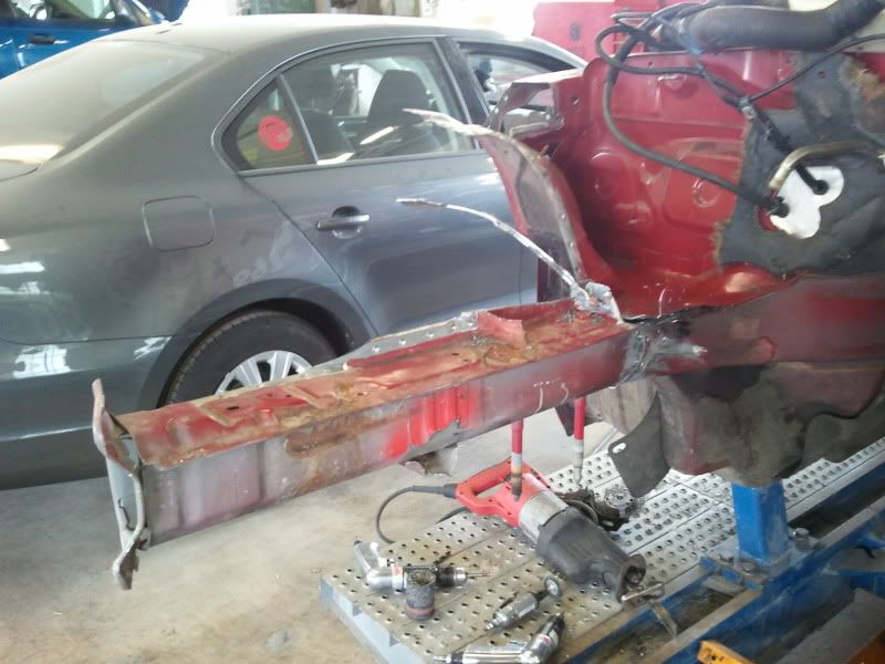

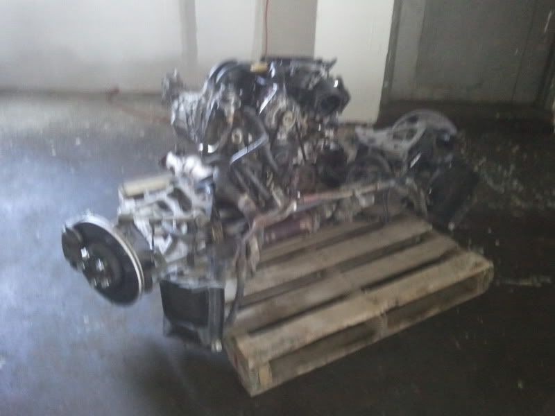

Had a free afternoon today, so I got it clamped down, rough pulled, and got the drivetrain out. It all needed to come out so I can access the frame rails to replace them.

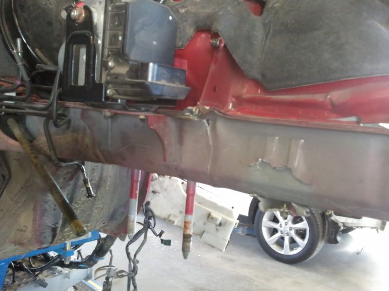

The driver side rail was so kinked, it started ripping when I pulled it back over. lol
Stay tuned!

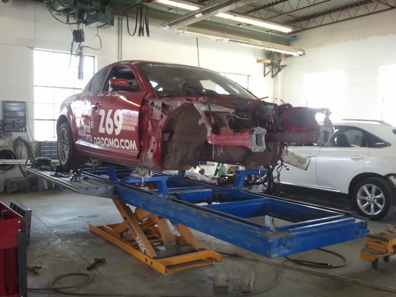

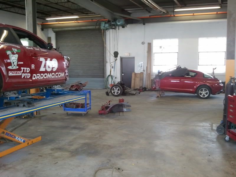

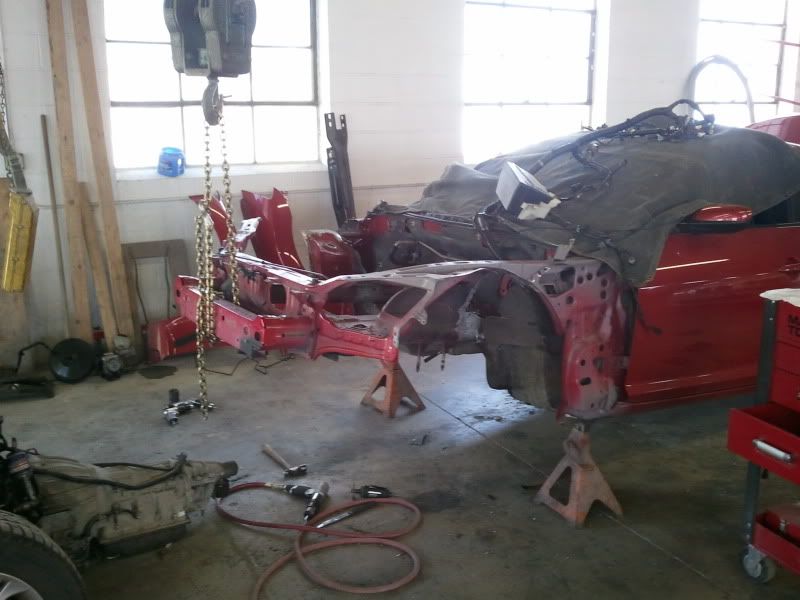

He hasn't dropped it off yet. We needed to make some rough pulls first, to see what kind of plan we were going with.

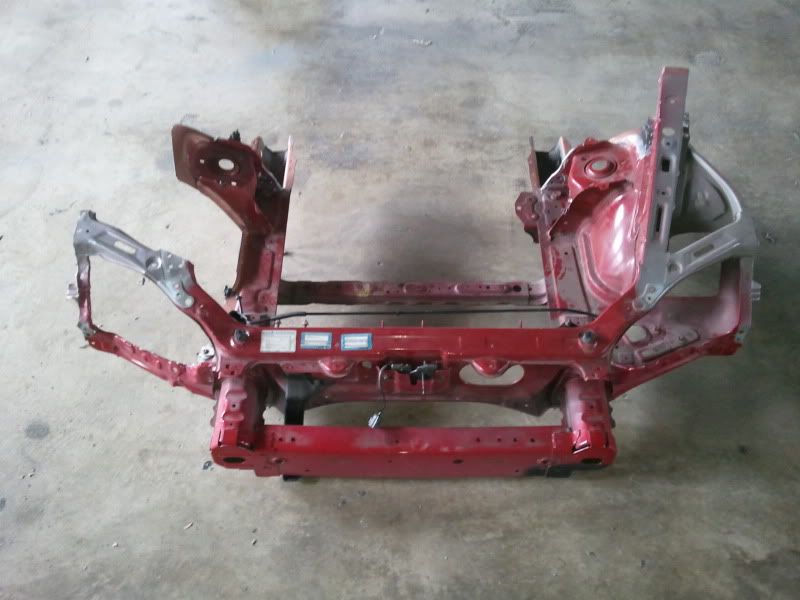

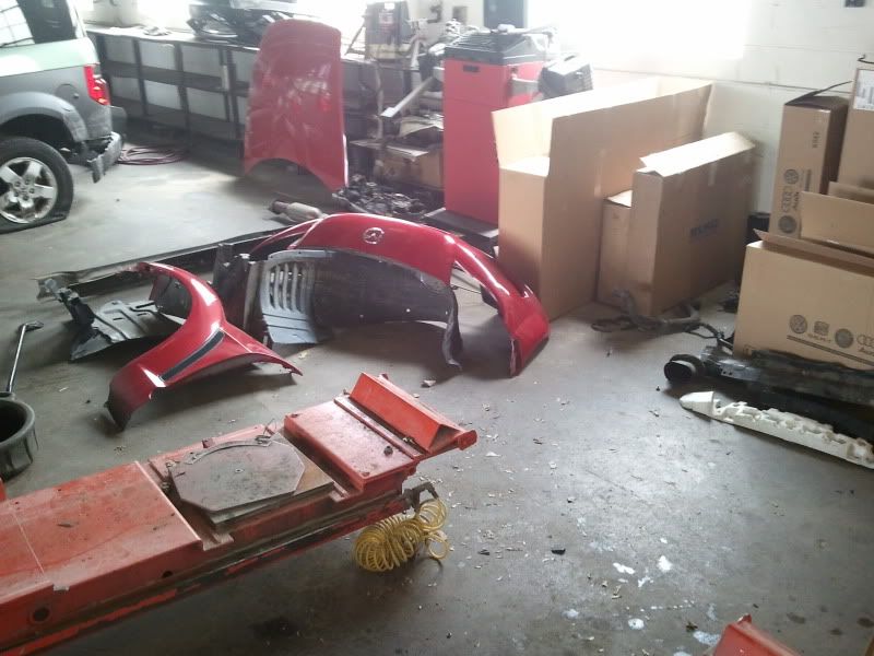

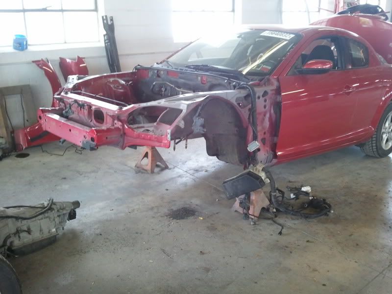

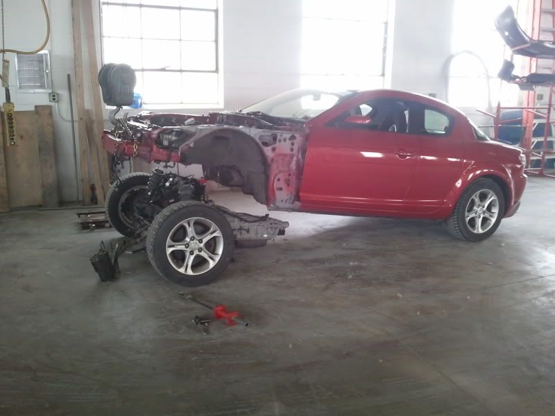

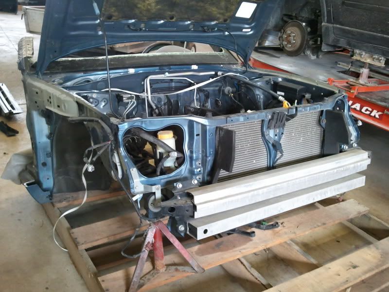

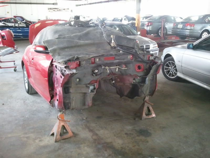

Got the donor car gutted this morning. :) Forgot to get before pics, but I'm sure you've all seen a stock RX-8. lulz
A little unorthodox, but hey....gotta work with what ya got!

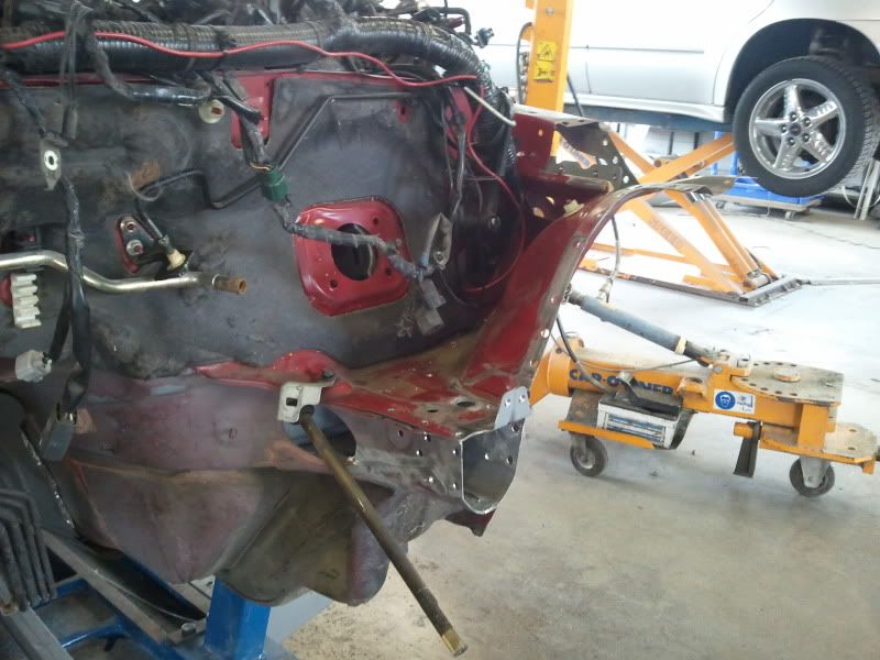

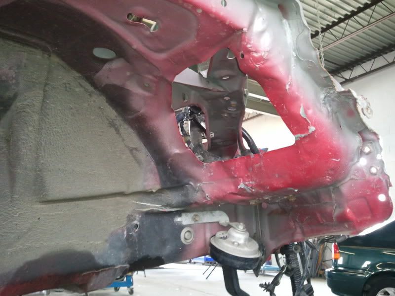

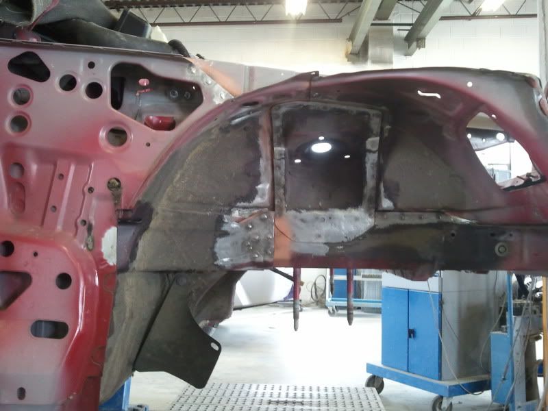

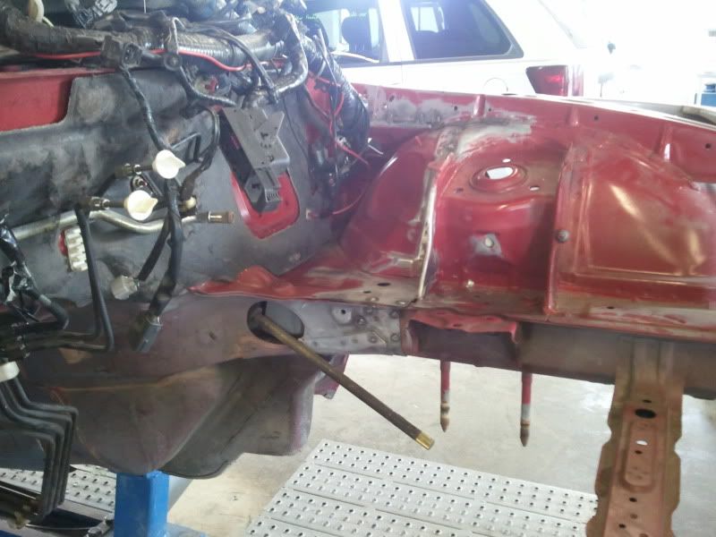

Also, found some damage behind the headlight that was just roughed out enough to get the headlight/fender/bumper to fit. I'll have to get with Mark to see what he wants to do with this.
Thanks to Marc for sticking around and lending a hand!
Maybe my untrained eyes are overlooking it, but what's wrong with the donor car? Other than that pass front headlight area.
Nothing. lol Well, it needed a good cleaning, and it wasn't in tip top running shape, but it was a perfectly good car.
The thing is, a front clip for this car would've cost at least $2500, and all it comes as is like this....
For what he has in this entire car, I can cut out what I need, he can part out the rest, and end up paying a fraction of the price of just a junkyard clip. :)

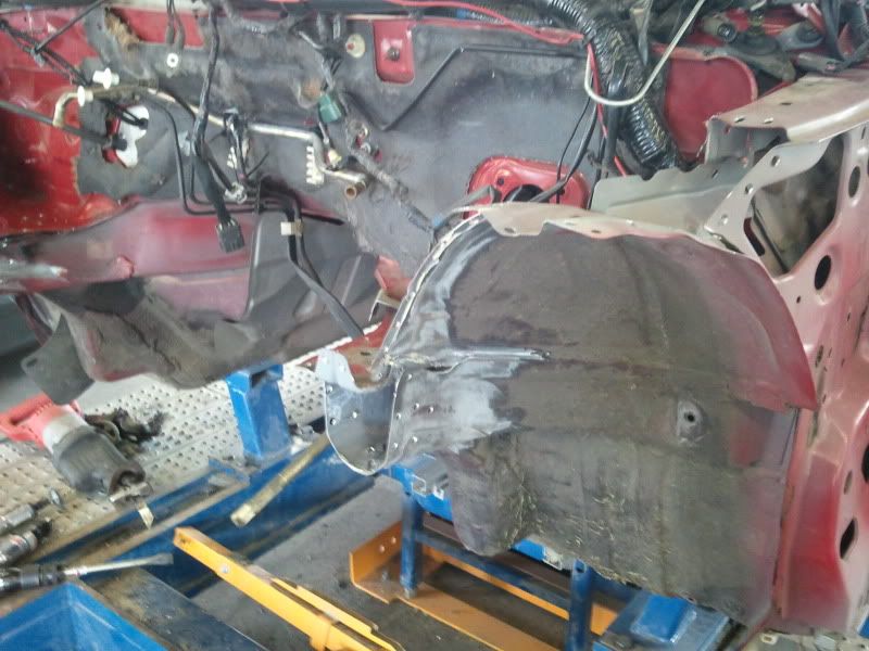

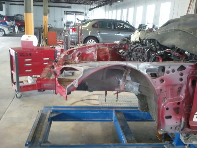

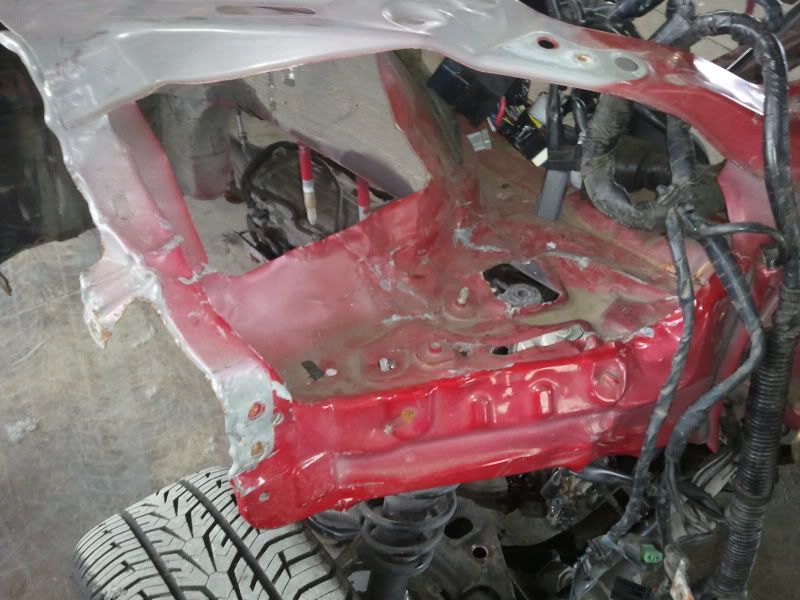

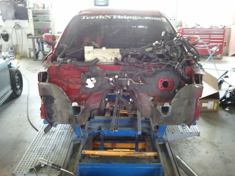

Got the poopie metal cut out...:)

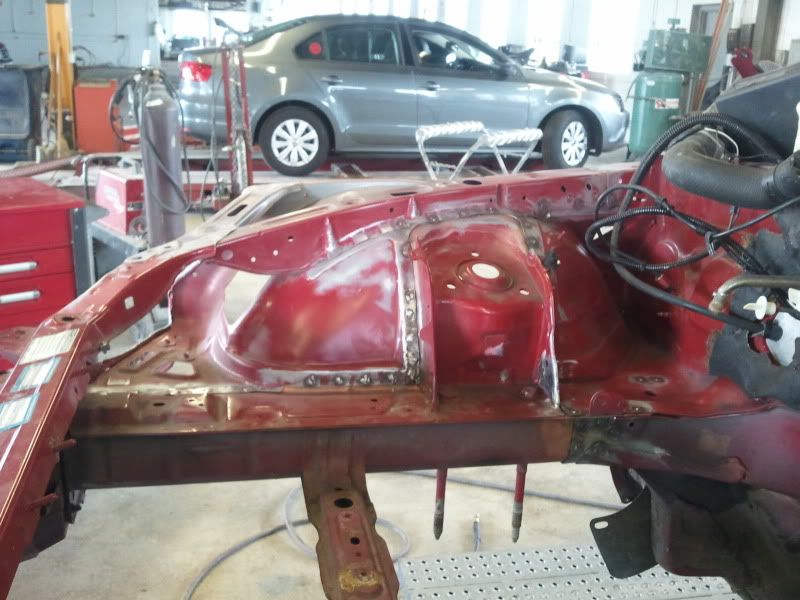

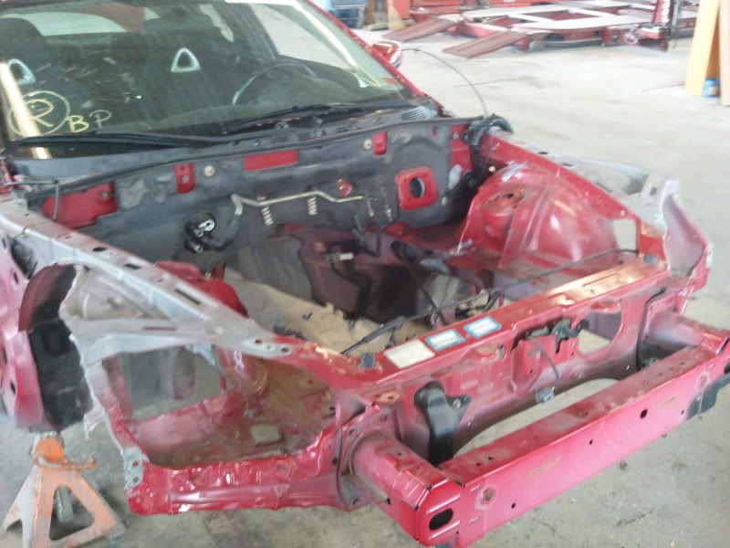

And got the rest of the stuff gutted from the donor, and cleaned out the seam sealer so I could see/get to the welds.
Put in a few hours this morning, to make up for all the time I missed this week. lol

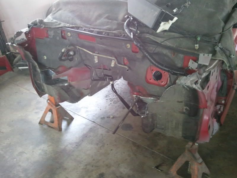

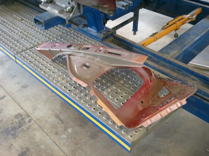

Prepped for fitment and welding.
Reusing his original passenger side apron and upper rail.
Sorry donor RX-8, I'm sure you had a good life....:(
