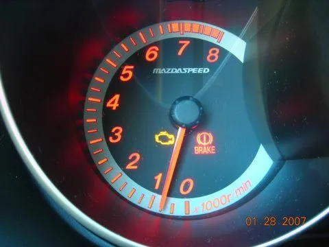

i had my intake manifold holes elongated about a month ago, untill this weekend there had been no more light. it's back on now, i hope its the gas cap this time. if its a new problem i'll post the info. i know we all know what the light looks like but here it is, it makes me sooooooo mad.

Elongating the manifold holes is the automatic first step. I've never heard of it working, but they do it anyway...maybe like my dealer - to stall until they could get the redesigned manifold valve thingy...
