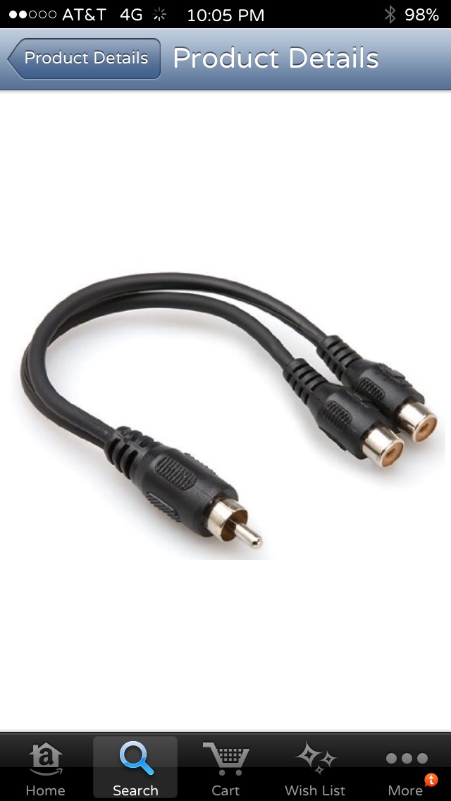

RCA cable

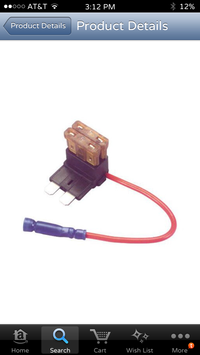

(1) fuse tap and some red 10A fuses

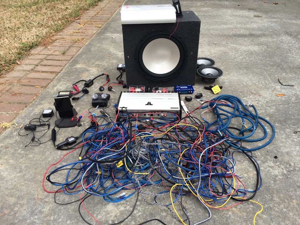

This is what I got to work with after I gutted my Civic that I traded in. No way was the stealership getting this beautiful mess!(cool) Of course, I didn't use ALL the wiring.

For your remote wire, take the fuse tap end with fuses installed and put into the 3rd fuse hole on the right bank, which is labeled #11.. Follow the directions on the fuse tap and install it correctly. This will power on your amp only when acc. or your CX-5 is on.

Connect an RCA cable from the LOC and once again tuck the RCA under the trim panels all the way back into the hatch.
