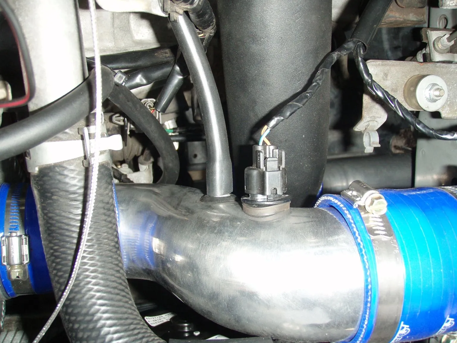

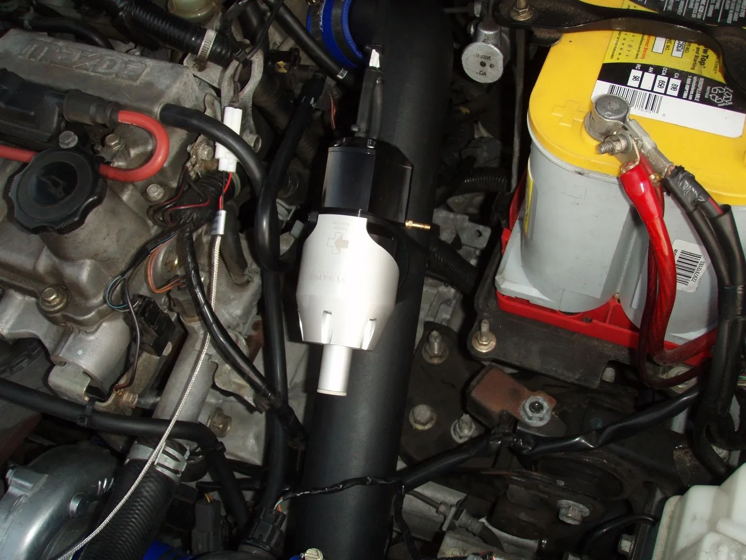

in the 3rd pic you can see how i had to drill holes for the IAT and the valve cover breather hose. for the breather hose i bought these badasse nipples vibrant makes, drill a hole, stuff the grommet in there and then stick the nipple in the grommet. i forget what size hole i drilled tho, but it's money.

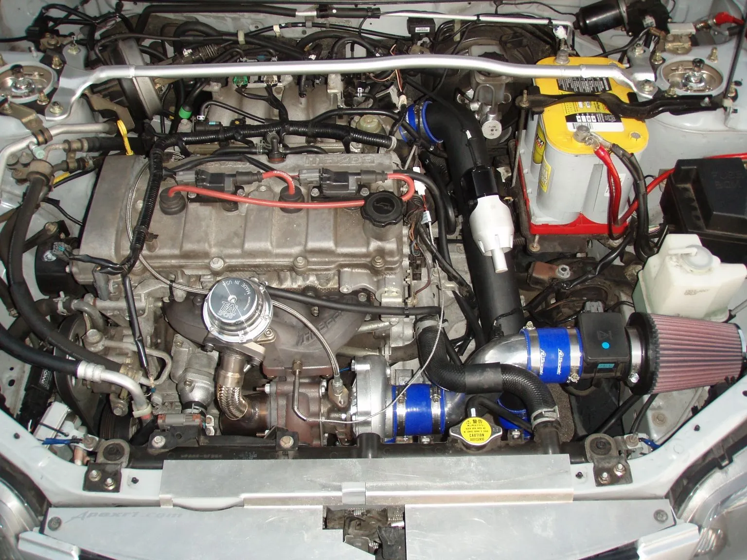

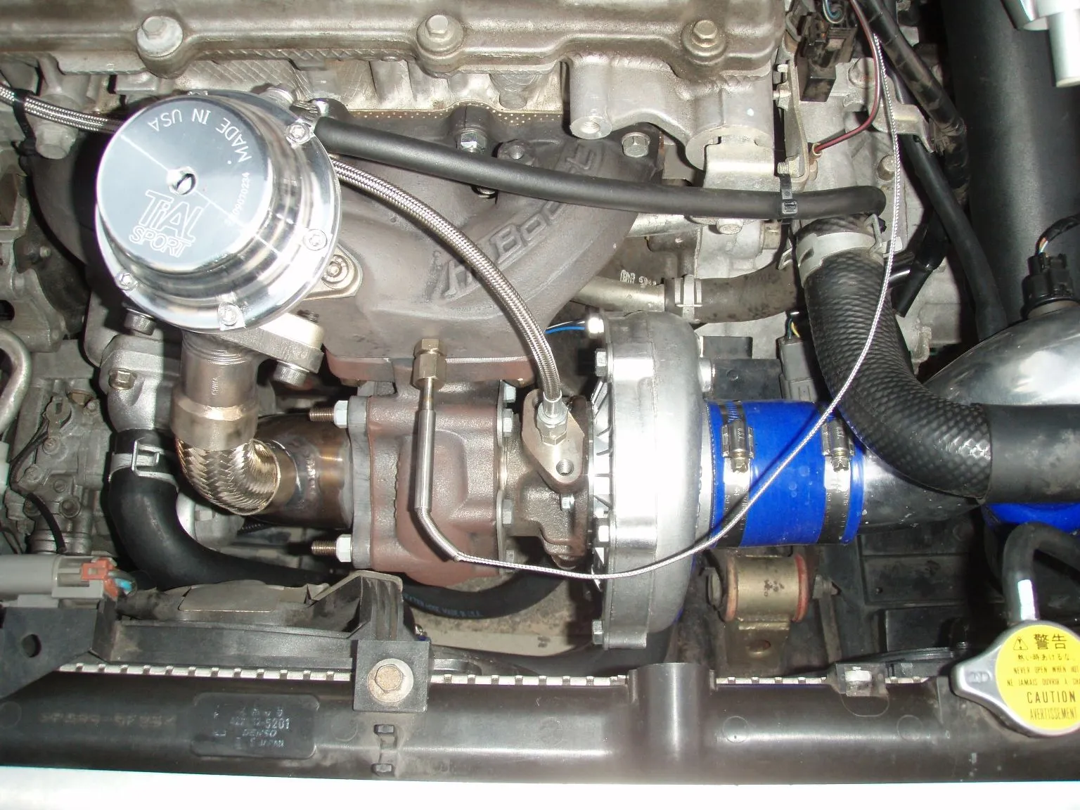

sweet, do you have any engine bay pics? I'm curious to see how the Hiboost kit looks..

thanks... yeah it's not a perfect tune yet, hit fuel cut around 6500rpms in first from maxing the MAF voltage so the AFRS bugged out. it'll do that every now and then. and the BOV is discharging to the atmosphere so it's goin crazy rich. i'll stall if i let off the gas while in boost and disengage the clutch. so i gotta make sure i'm in vaccum when i disengage. i'm also getting some crazy compressor surge... funny synapse engineering markets their BOV as eliminating it. guess i just need to adjust the preload.

i'll try to get some pics tomorrow. there is a good amount of custom work to be done to the hiboost kit if you wanna keep the car as stock as possible, as theres no provisions on anything on the kit. you will need a slimline fan and move the coolent tank to fit the filter. but thats easy, it's just moveing the brackets bottom hole to the top hole and only using one bolt. fits perfect. i also had to hack the **** out of the bumper. it looks like s*** because i'm a function over form guy. guess it was designed for the MP3/MSP/P5 bumpers. right now the only thing i don't have hooked up is my EGR pipe. i cut it and put a vaccum cap on it. and so far the only time i got a MIl about it was when i got really bad fuel cut, but then again i cleared my ECU of DTC's everytime the MIL came on so non of the monitors have had time to reset. so i'm keeping my fingers crossed.

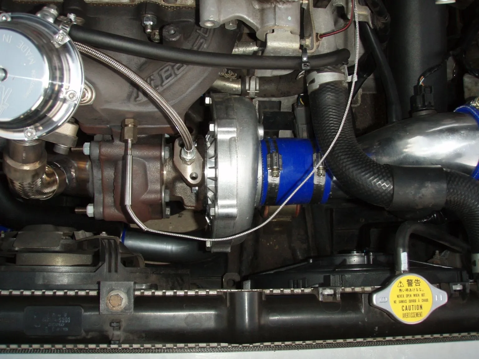

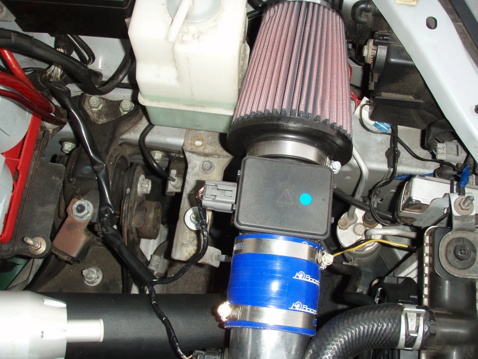

you can see how the filter fits and where i had to move the coolant tank using one of the mounting bolts. below the tank you can see the empty hole. theres another one up and to the right hidden by the tank. i put the bolt in that hole using the mounting position for the empty hole. fits great.
