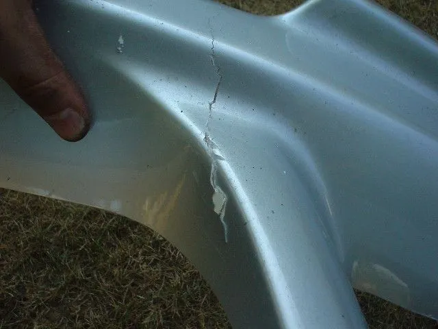

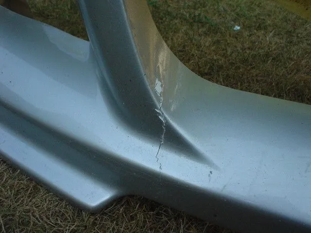

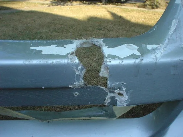

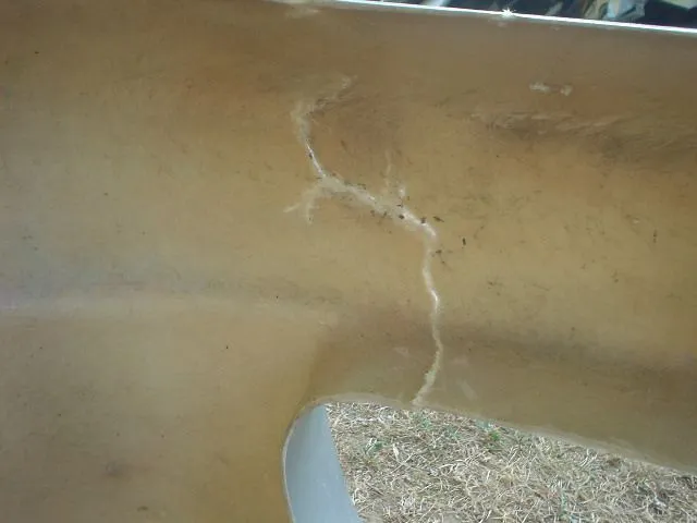

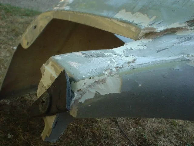

show us some pics of the problem...then we can instruct you on how to fix it
heres some good pics of the damage.

That looks rough...but to let you know...Its hard to tell what is what...Sometimes a full shot speaks soo much louder than close ups.
It is very rough but I think I could fix it....SO I say go for it...I know it can be fixed but if the one shot is of the piece of the bumper that goes between the grille and headlight..then I would start there and mold it back into one with the bumper installed on the car so that everything will line up.Once you get it back together there it could be removed and the rest of the bumper repaired.
yeah thanx, I just need to buy the resin, fibers, and bondo, and i guess take my time, Im just confused about what I should do to repair the chunk missing in the middle.
