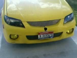

no orange sidemarker lights.. check www.flickr.com/photos/clauretano and search for a picture of my car on there (sorry I can't help more.. I'm at work, flickr is blocked)
you can kinda tell from this pic from a couple months ago:
Oh yah, thats right. I suppose it would be easyer to add the MSP lip later on as well. We will see how much shipping is. Thanks for the info though.
