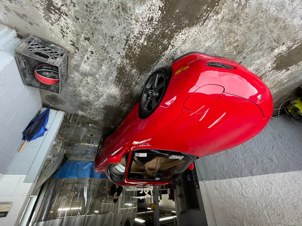

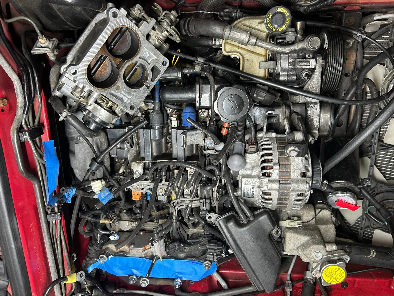

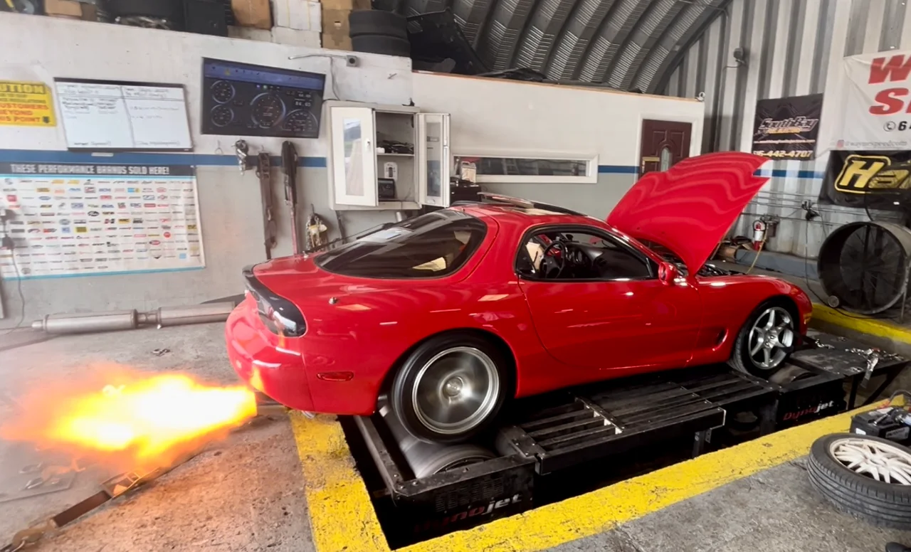

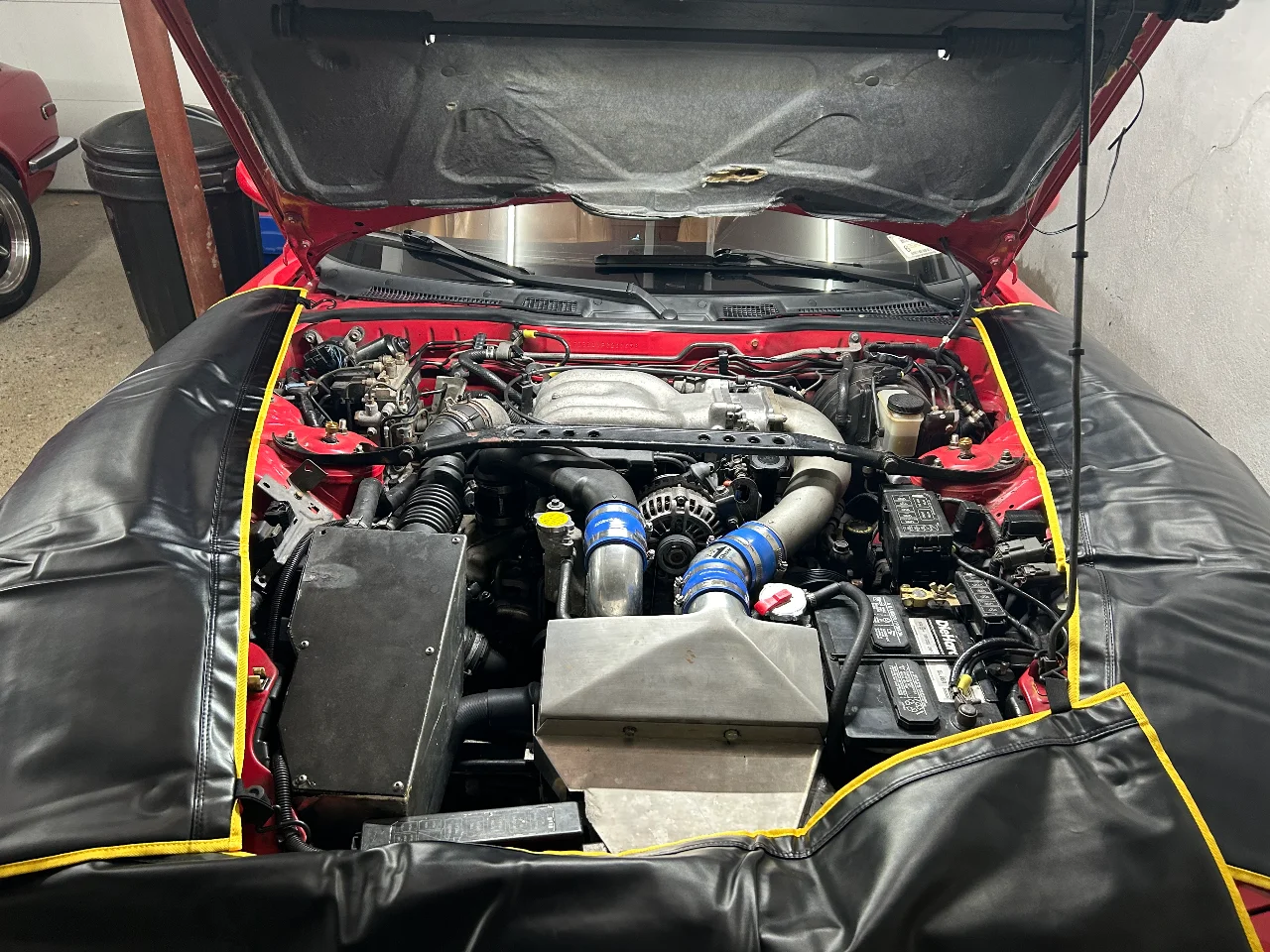

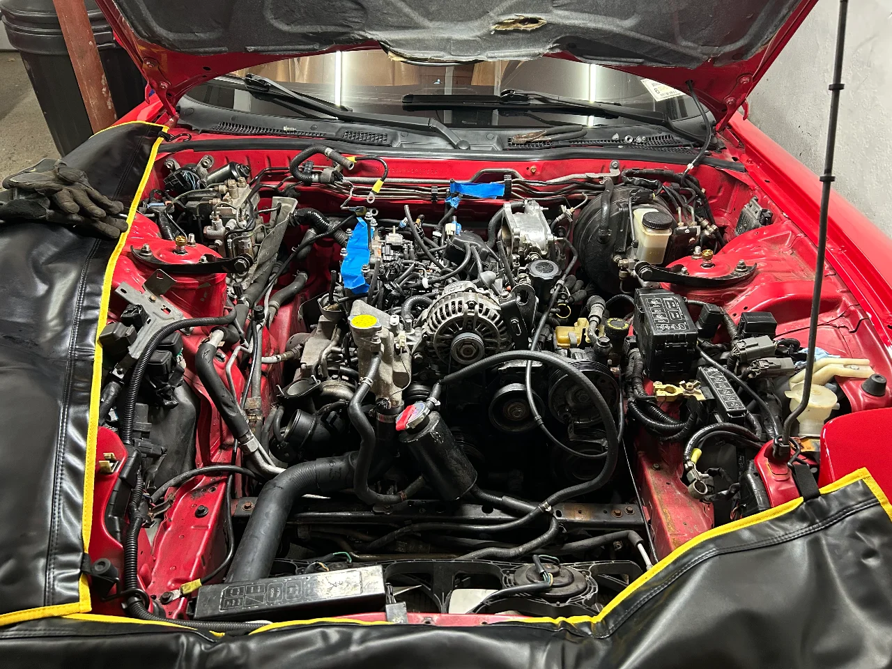

I’m in the process with my fd. Going single turbo route
Check the harness for heat damage
Refresh the rats nest
5th gear syncro is known to break
Upgrade the cooling system
No mods without a tune
That being said I have a bunch of stuff from the twin turbo setup and a power fc. Switched to haltech.
Rotary life is a love/hate relationship. Have 2-3x more cash on hand than you think and a friend with a trailer.
When it runs great it’s awesome. When it doesn’t it sucks.
