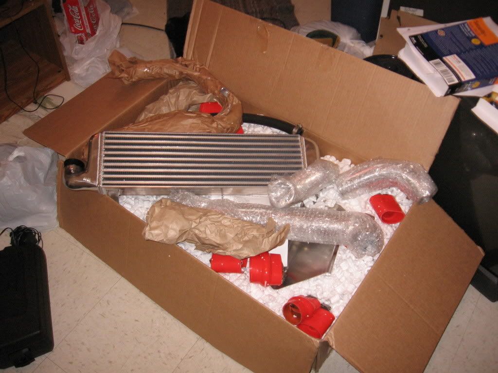

Install of Hiboost fmic, vibrant exhaust, and injen sri/cai - Literally a few weeks after i got the car... the dam mod bug kicked in
Then all of a sudden.... The mod bug struck again.

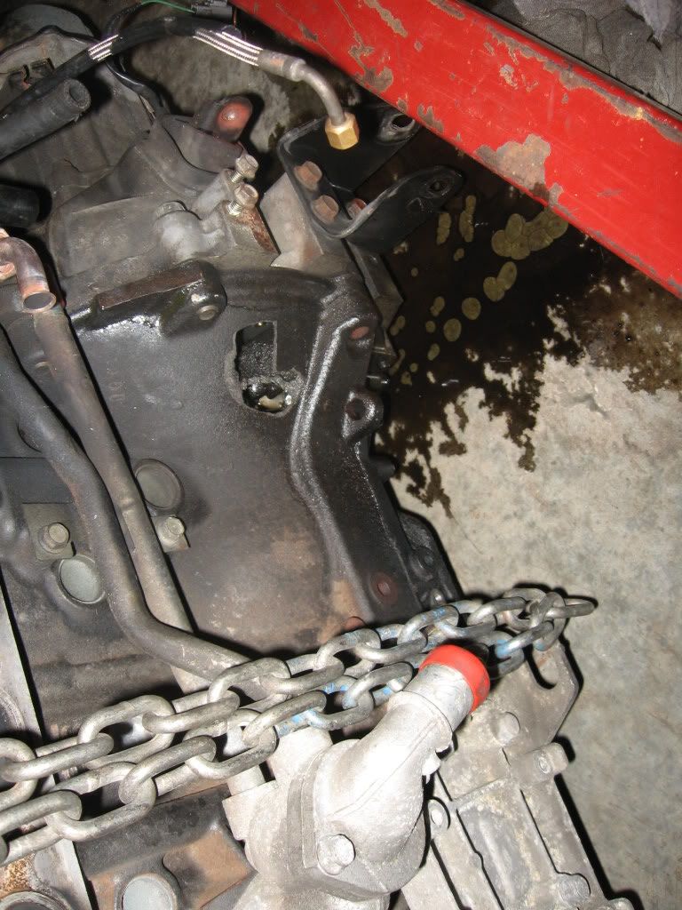

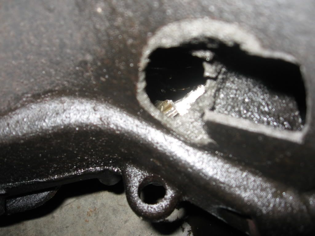

So a few weeks ago i popped my motor doing some spirited driving with a few of my friends. Just heard a boom and the sound of metal hitting my car and the road and lost all power. When i came to stop there was a nice trail of oil from behind my car. So i knew it was bad. So had to call a tow truck company and they had to come pick up my poor lil baby haha. Well when the tow truck driver gets there he is not driving a flat bed like they told me he would be driving. So he gets the car up in the air and reassures me that it will be fine. So in the pissed off mood i was in said ok, mainly cause i just wanted to get the bar and get (drunk) lol.

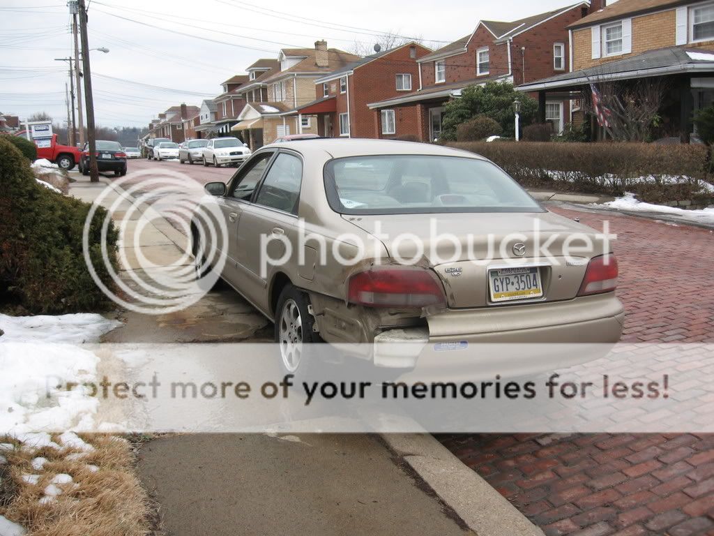

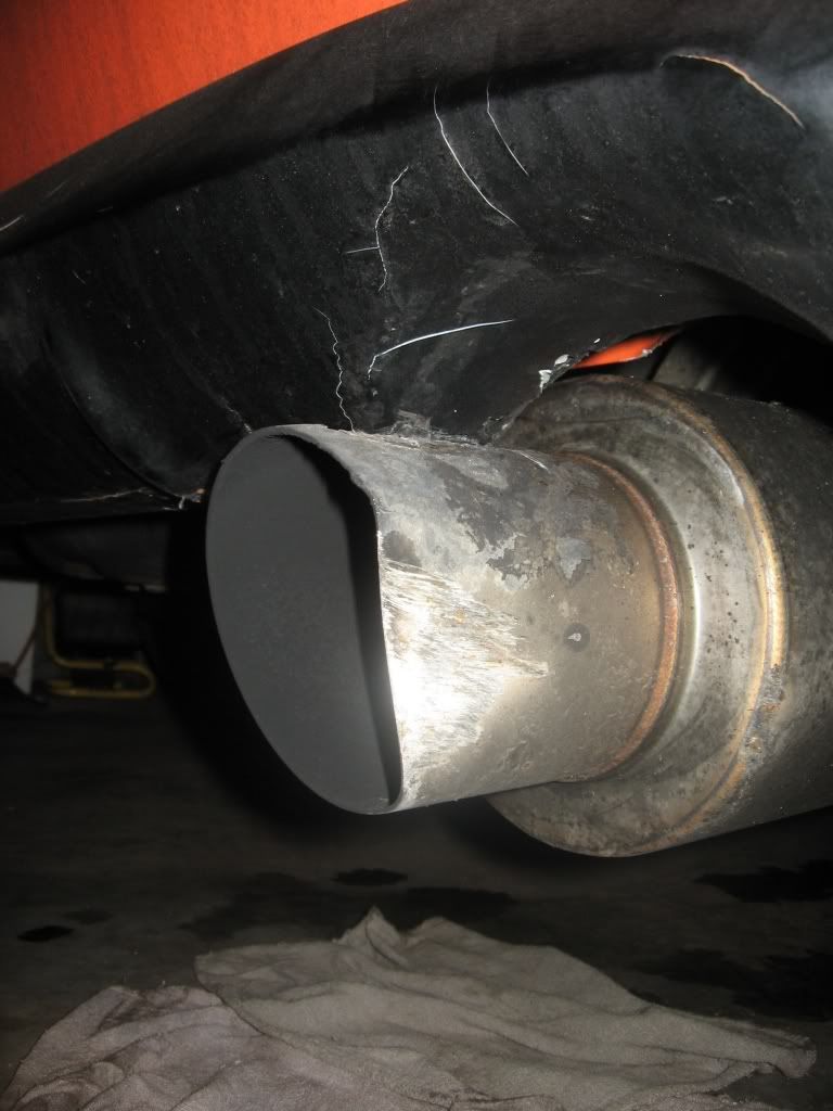

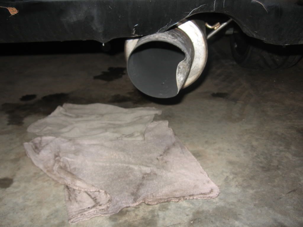

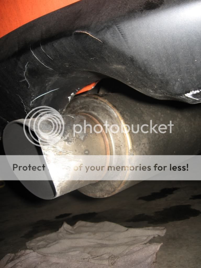

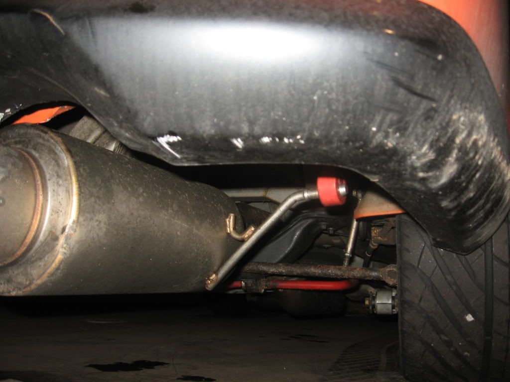

So its Sunday the day after i popped the motor and i go to the shop that has my car. I walk to it and walk to the back to make sure everything ok, and its not (hand). The axle back is completely shifted to the left and there is a huge dent in my tip. Freaking great. So i call the tow truck company and there is nothing that can be done atm. I would have to call on monday.

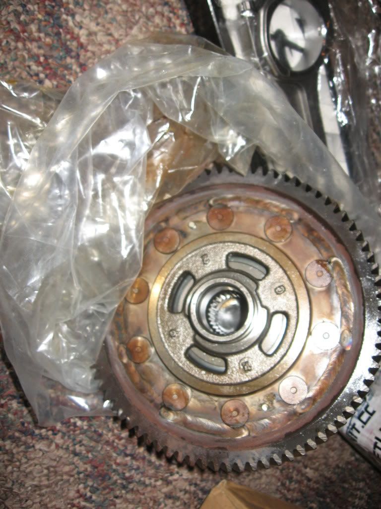

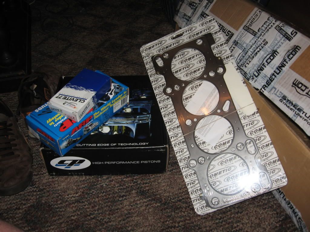

Well i figure out what im doing and yes flame if you want i dont care i went with SU cause i was able to get a great deal. My order was going to consist of a build a block kit, BC racing coilover w/ the extensions, updated welded LSD and a new timing belt.
Motor specs:
# Brand New Block
# Oil Squirters

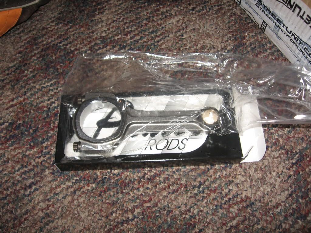

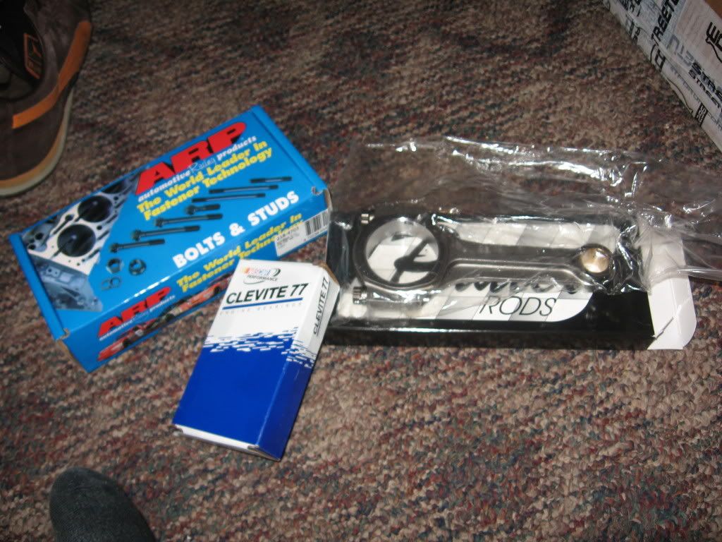

# Forged Rods:Pauter Rod Set
# Rod Bearings:Set of 4 Clevite Bearings

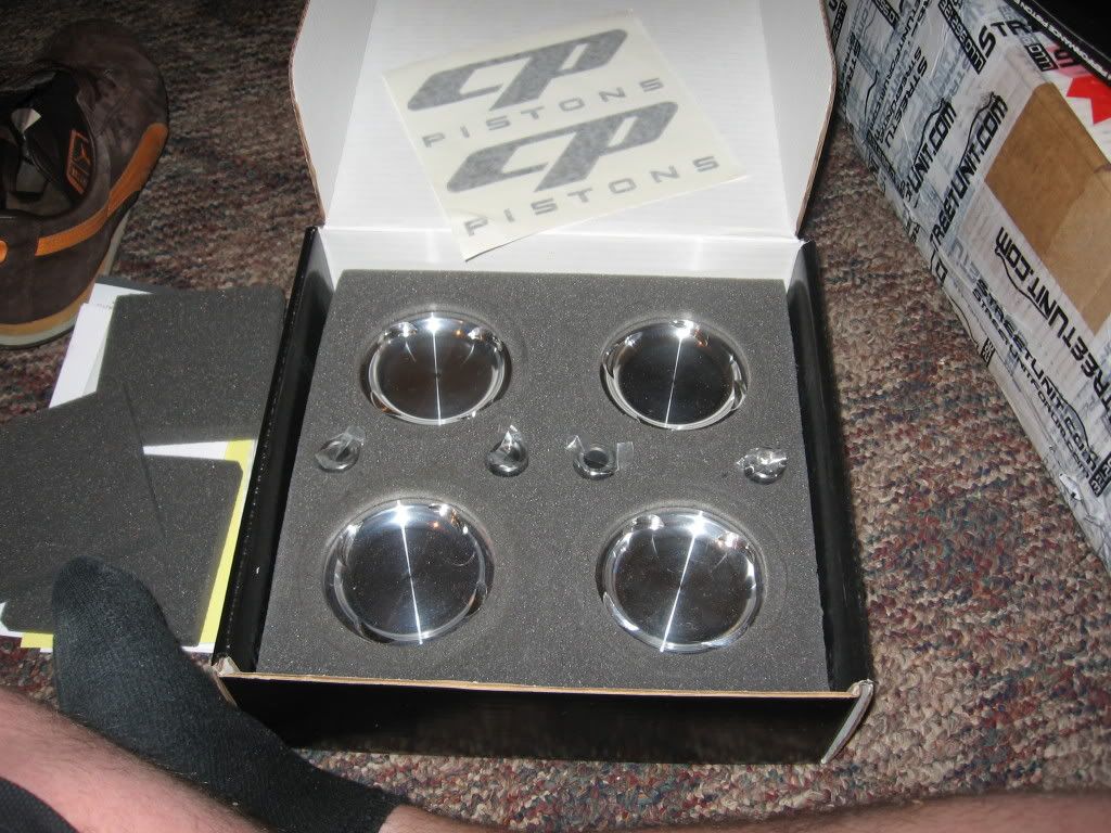

# Piston Kits:CP Pistons: 8.5:1 CR/STD Bore
# Head Gasket:Cometic: 84.5mm/STD Bore
# Engine Gasket Kit:Yes w/o OEM Head Gasket
# Main Bearings:Clevite Set
# Thrust Washers:Clevite 2 Sets
# Head Studs:ARP Stud Kit
# Oil Pump:Yes Please
# Water Pump:Yes Please
# Cylinder Head:No Thanks

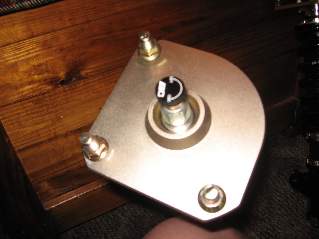

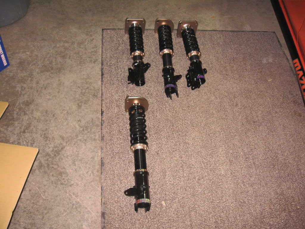

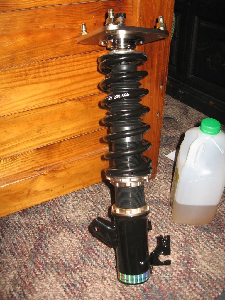

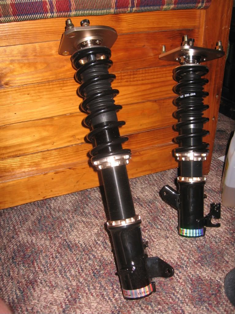

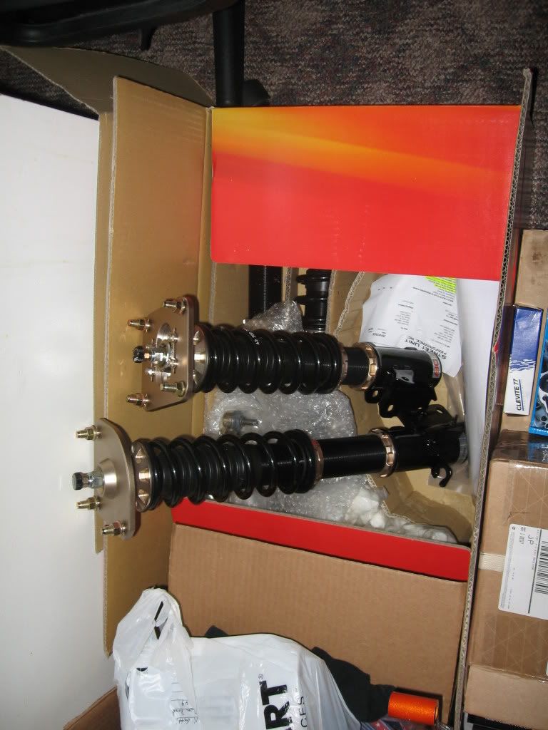

BC racing Coils
Front Upper Pillow Ball Mount - Included
Rear Upper Pillow Ball Mount - Included
Front Adjustable Camber - Yes
Rear Adjustable Camber - no
Front Spring Rates - 440
Rear Spring Rates - 220
30 Levels of Adjustable Damping Force
Fully Height Adjustable
Mono-Tube Design For Maximum Performance
One Year Limited Warranty
The extensions i mentioned im getting let you adjust the rear damping with out having to take off the read deck lid for those of you wondering.
im going to be ordering the rear camber plates once they get more in stock, they are 195 a set.

So i talked to the tow truck company and they are saying that there is no way they did the damage and they wont be covering it, so that means i have to take them to court to get them to pay for a new exhaust, cause after what i just bought im broke as hell and there is no way im paying for something that i did break.

Today my coils w/extensions and extension are getting shipped. My block, gasket kit, oil and water pump, timing belt and a few other things are getting shipped from mazda in NC, so that stuff should be in shortly too. The clevite bearings and apr stud kit should get shipped out next tuesday along with a couple of other thing.

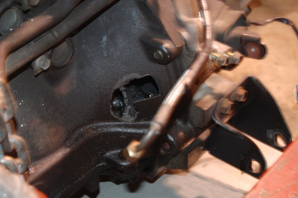

I also talked to my mechanic today and he informed me that i pretty much wrapped my rod around my crank lol. So that means that i have to get a new crank now but my head should be ok.

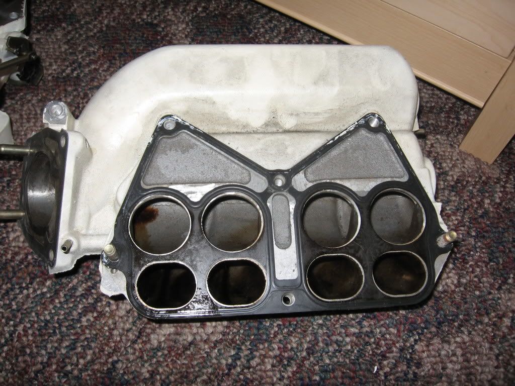

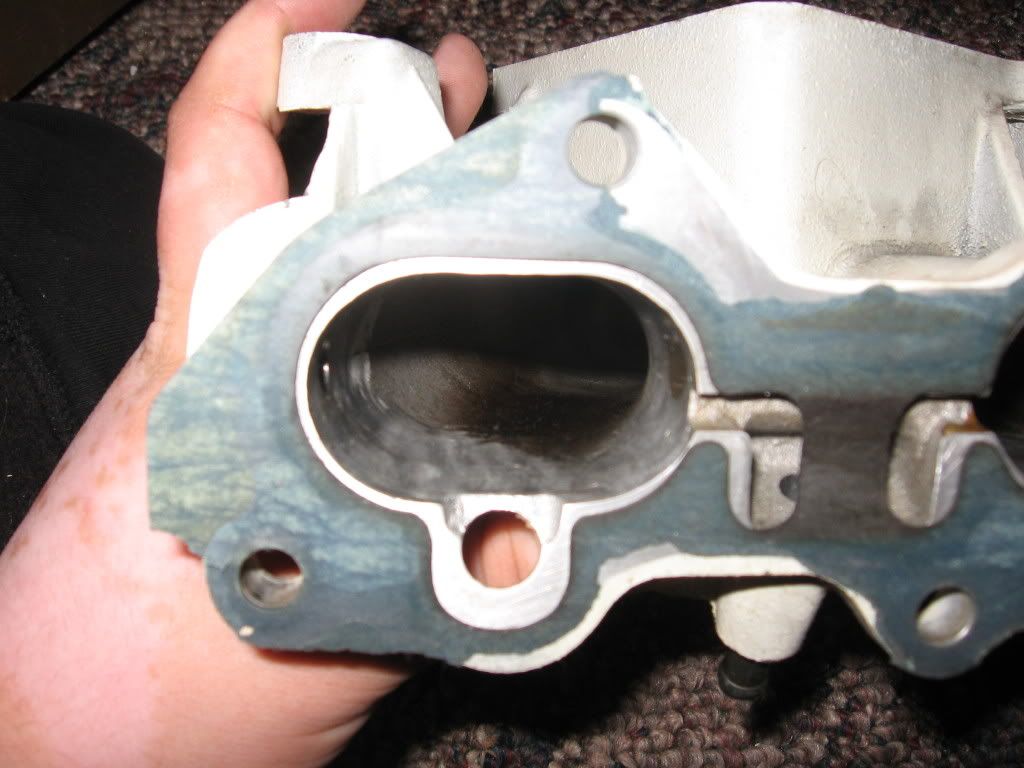

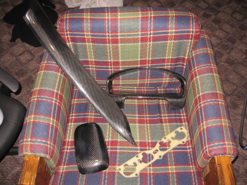

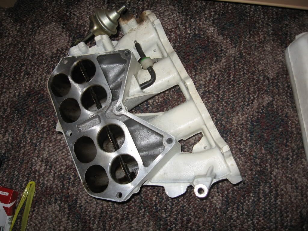

Some DG CF interior pieces and NSN intake mani spacer

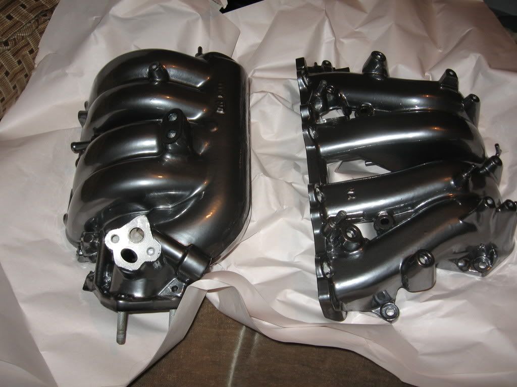

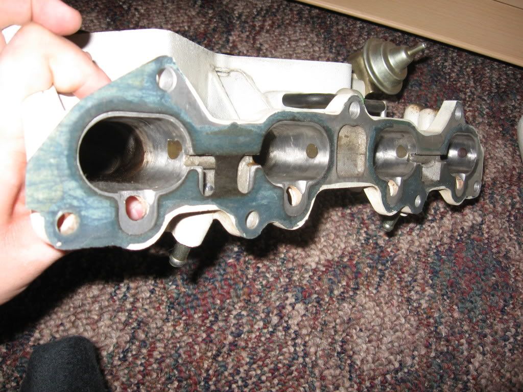

Stock intake mani PnP and the VCTS removed, going to get painted black before installed.

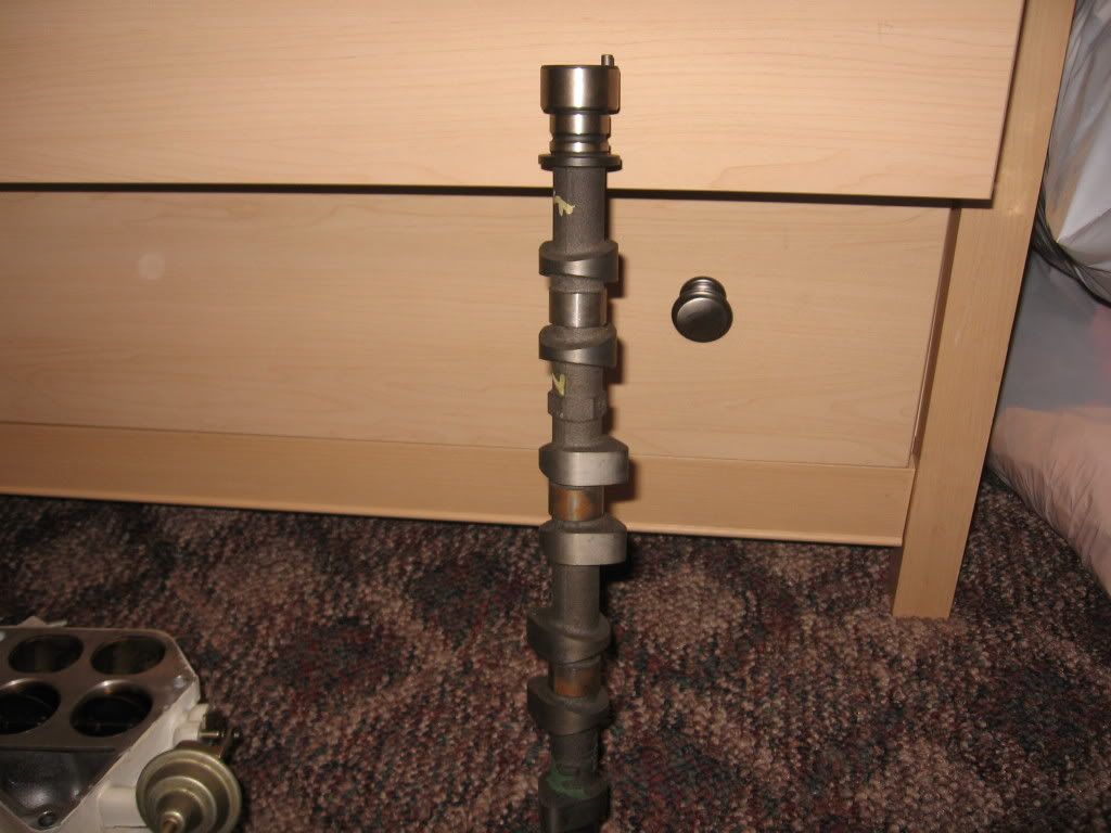

J-spec intake cam

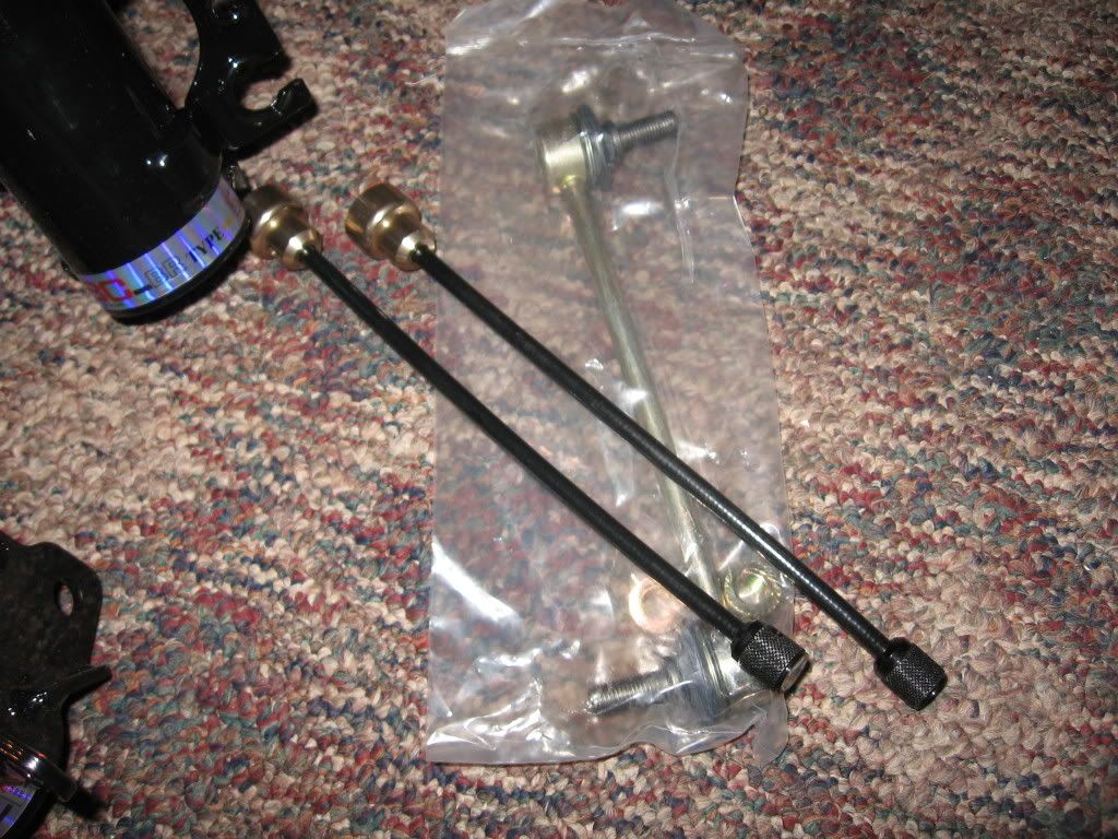

These are the extension for the rear and the new front endlinks.

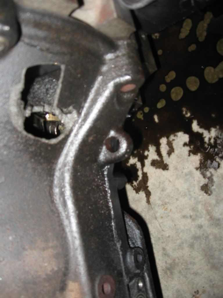

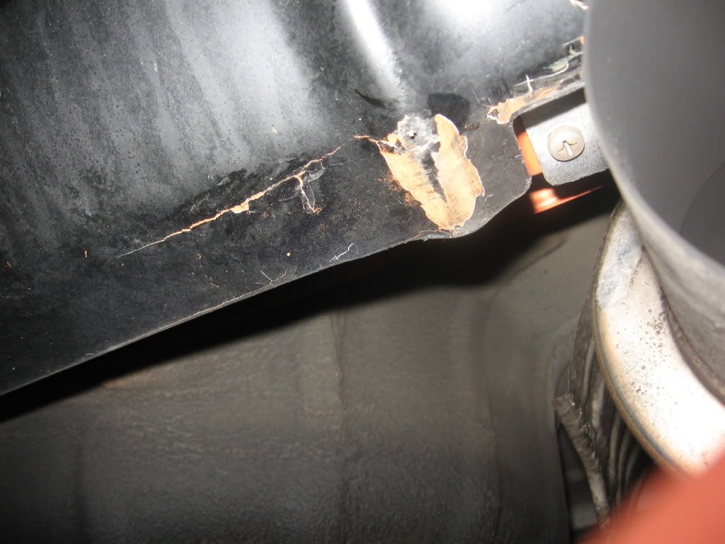

Pics of what the lovely tow truck driver says he didnt do to my exhaust.

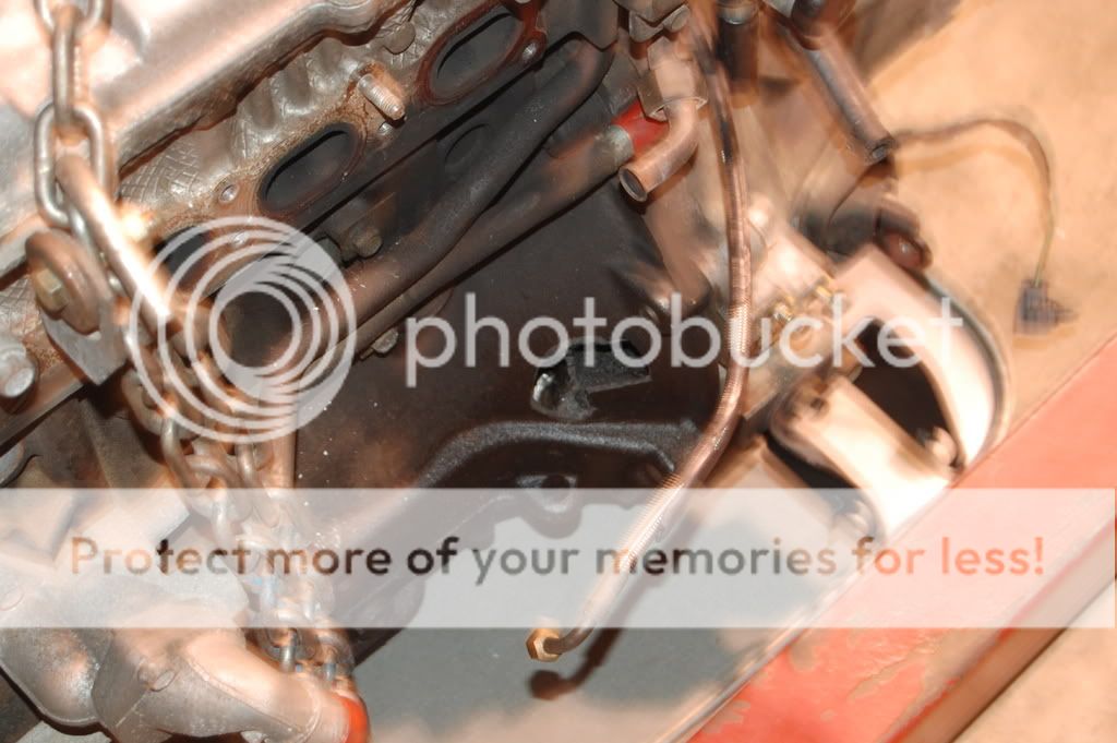

Shots from the shop thats working on my car.
Look at that nice lil hole haha.

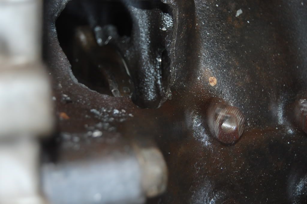

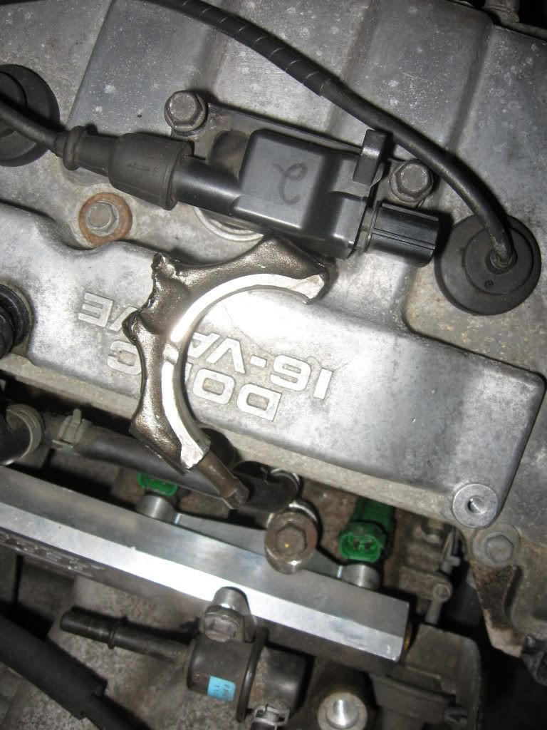

If you look close enough you might be able to see all the lil pieces in there from the block and rod
Here is a piece of my rod, not sure how they got it out of the motor though lol, didnt get a chance to ask lol.

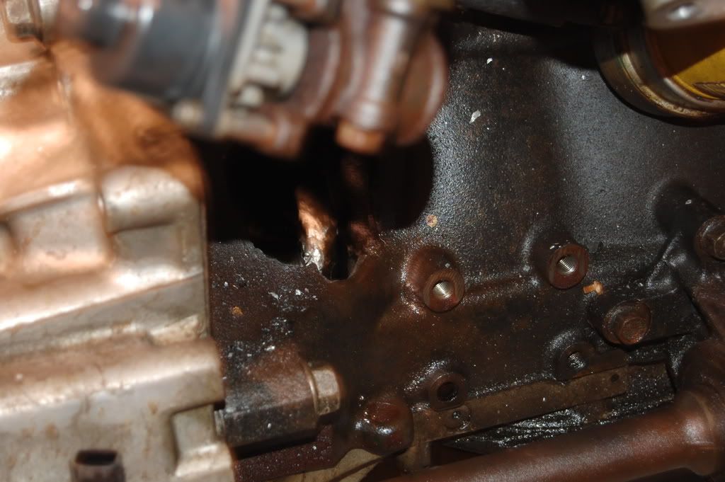

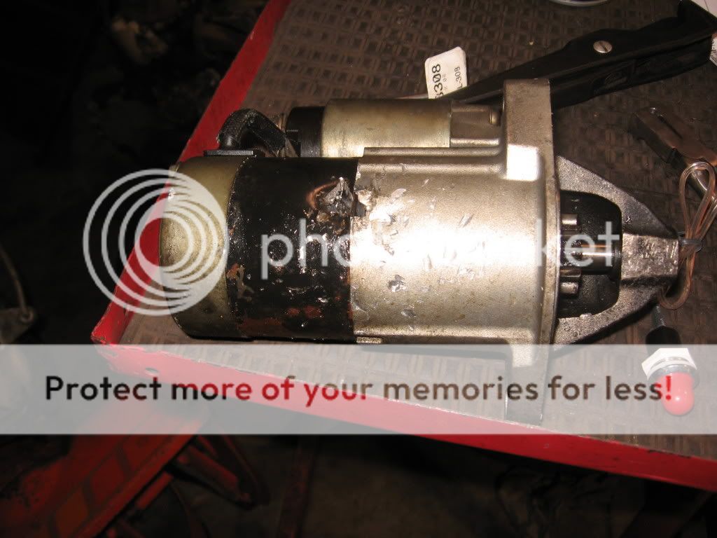

Pic of what the rod did to my starter.
1/7/09
New Block, water pump, gasket kit and oil pump came and i got those over to my mechanic, also got some pics of the motor, the first two are of the hole on the other side of the motor. This one is def. alot bigger then the first hole i had pics of. You can see straight threw my motor threw the 2 holes. They are straight across from each other haha. My buddy can get my a brand new Windage Tray for 300 and might be getting a brand new OEM crank for 100 bucks. Once those two part are bought i will have everything to get the motor down.

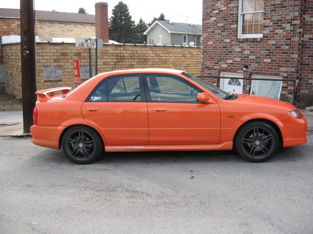

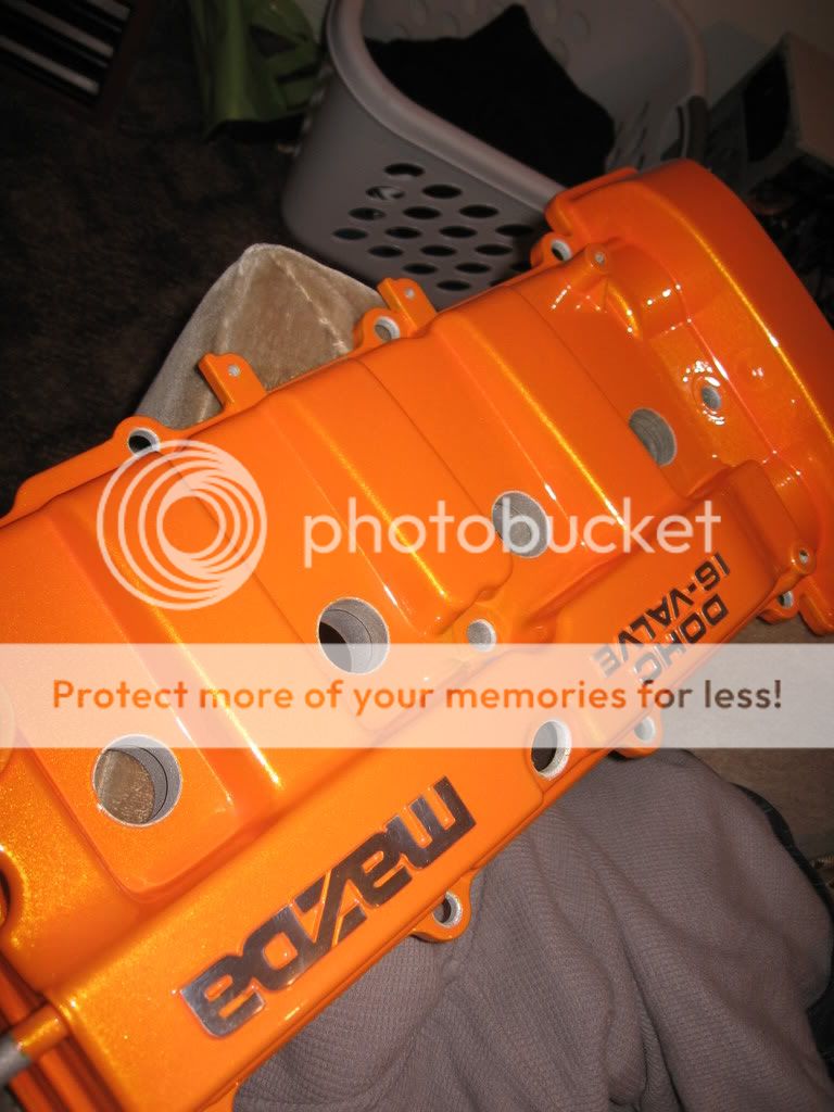

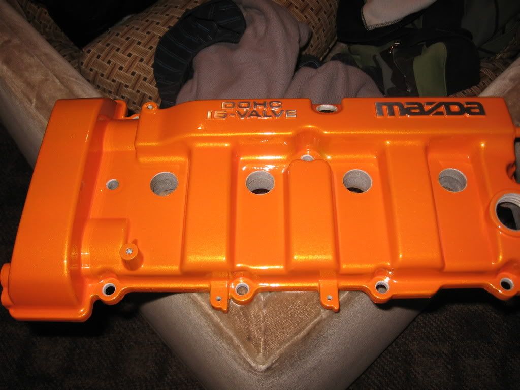

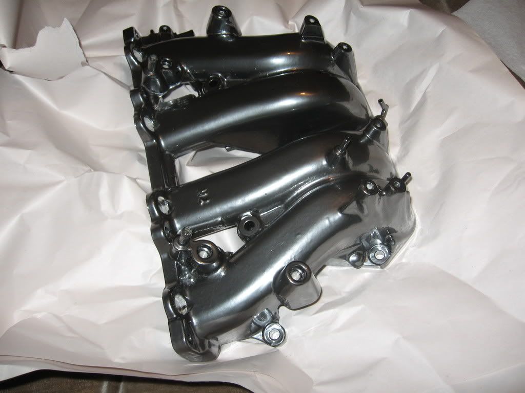

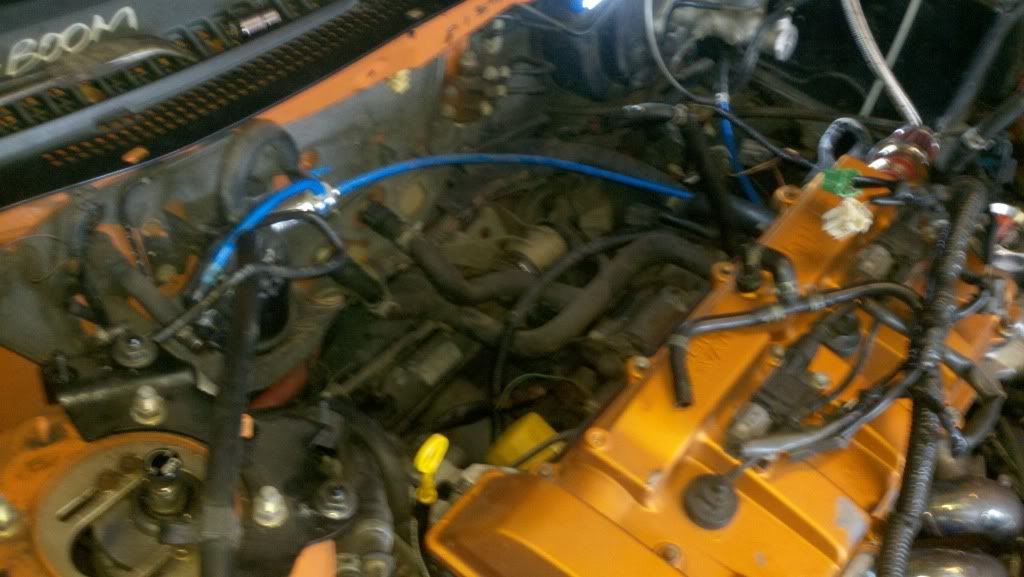

Well my VC is done and i dropped off my intake mani to get powedercoated black chrome and i also got pics of what im rocking now, def. no MSP haha but still not bad. This is the same color of orange that im using for the wheels.
The polished letters are a lil dirty btw
I also talked to my mechanic and the head is out should be done this week, im hoping to be running next month.
2/28/09
Got my intake mani back, no longer white yay

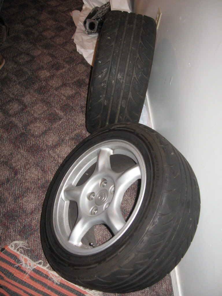

Set of bridgestone potenza for AutoX, only using 2 of them for the rear

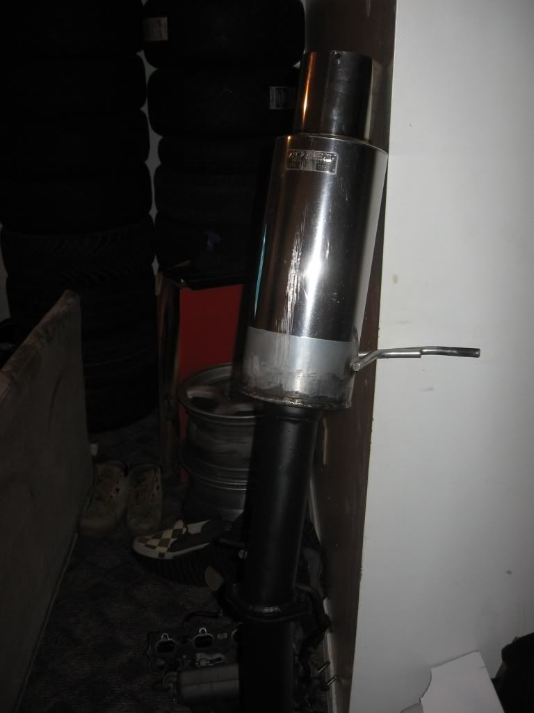

ApexR1 Exhaust

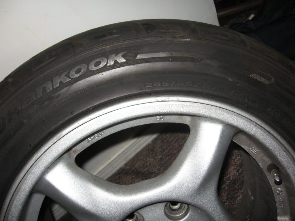

FD wheels and the 245/45/16 tires im rocking for AutoX
Then the rest of my tires and rims i have in my living room haha

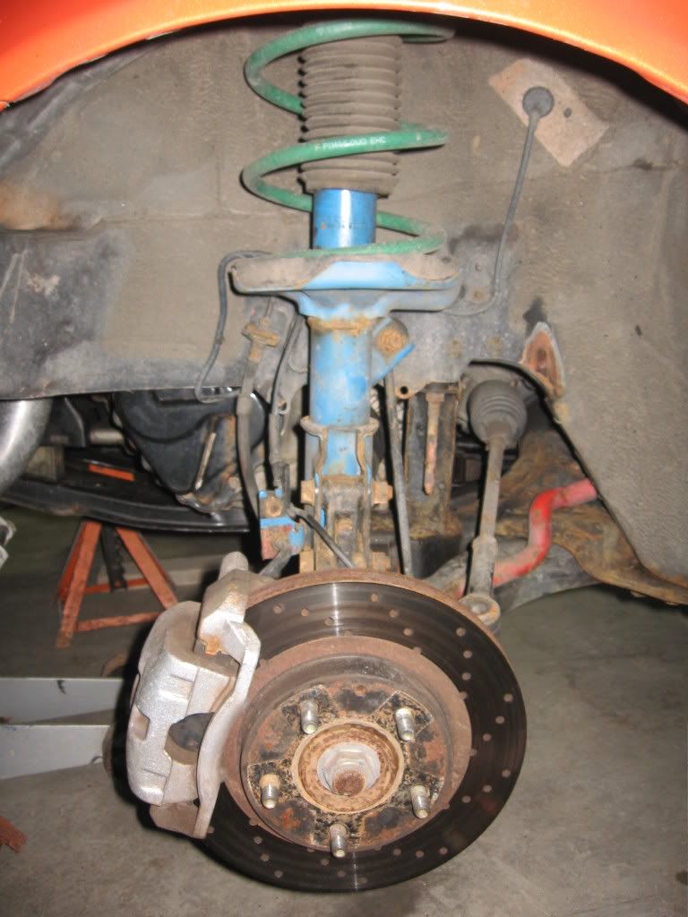

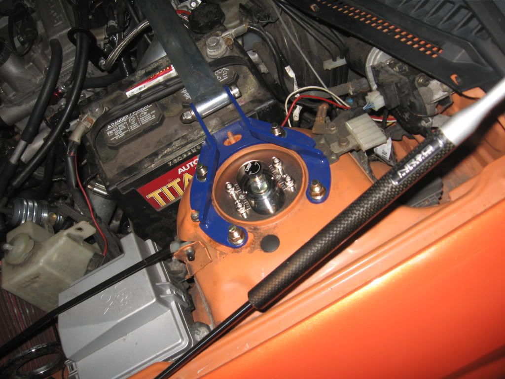

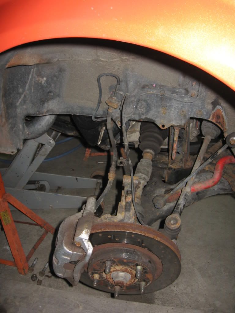

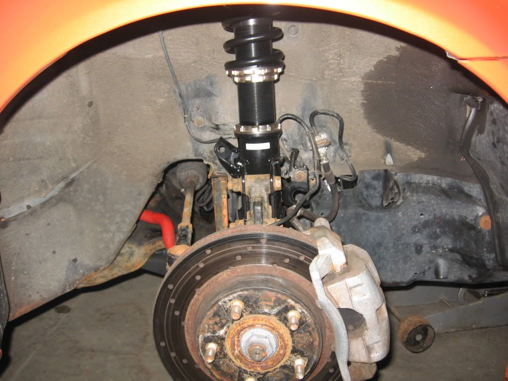

BC Coilover install pics
Also the night my mirror was killed by a mopar lover, still think it was on purpose
Then a fat half Italian hitler brought justice to the night by steeling all the beer from the mopar lover
Coils got installed 3 or so hours after the motor was finished

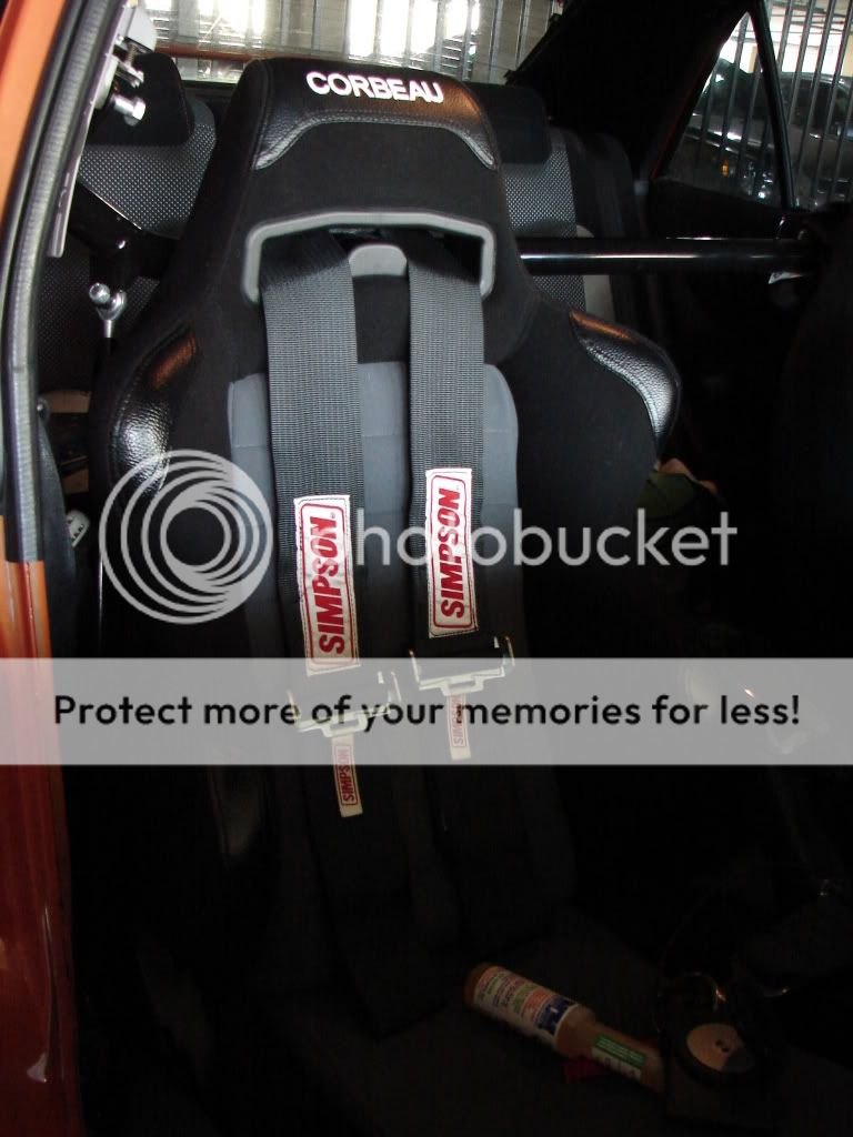

These seats got installed awhile ago, but finally got some pics, also installed a MR2 harness bar, still needs a lil tweaking but is working out great.

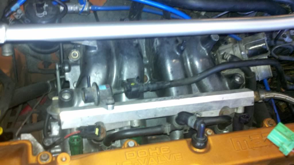

Pics of the 505 Intake mani and failed attempt to running 245/45/17s up front
your head gasket and pistons dont match it says .20 bore over on the gasket and pistons are standard bore idk if it was a typeo or thats what you ordered
have your head pressure tested. I thought mine saw fine also until I put the car back together and found out it was cracked. I had it pressure test and they said it was good to go. After I pulled the head I sprayed carb cleaner on the #2 cyl. valves and it leaked right through. You might want to try that. My .02 good luck with the buid
i just turn the head up side down and pour some gas on the valves. its ok if they seep a little bit but they should not leak a whole lot.
ya it was a typo lol
but ya im going to have the head checked out to make sure its all good.
