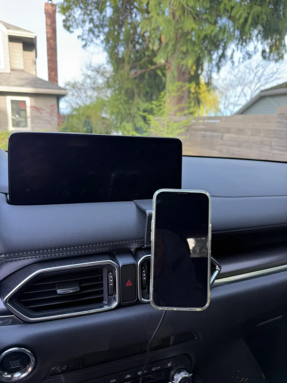

Soon I'll be installing a mount from Proclips that puts it up on the dash just under the screen. Along with a magsafe charging adapter.

Ok, my new setup is a Proclip mount with a Scosche MagSafe charging mount. It leverages wireless CarPlay which is a bit laggy, but the convenience is awesome and I like the mounting spot. I have used Proclips for years -- probably bought 10 mounts. Good stuff. The Scosche uses a branded 40w cigarette-plug charger (that has two USB-C outputs) and seems to actually increase my phone's battery while driving using Google Maps wirelessly.
