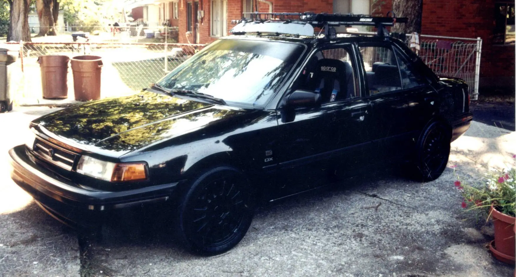

ther is a idle adjustment screw on the throttle body, dont adjust the cables..this will work if its a little high, up to 1000rpm...on mine i think the air idle controller valve got stuck open and it was like 4000rpm..... so what i did readjusted the throttle body door so that it shuts all the way and adj the idle srew till it was normal... drove the car like that for a few years before i sold it.. send me pics of your throttle body and ill show you where the screw is if you cant find it..
