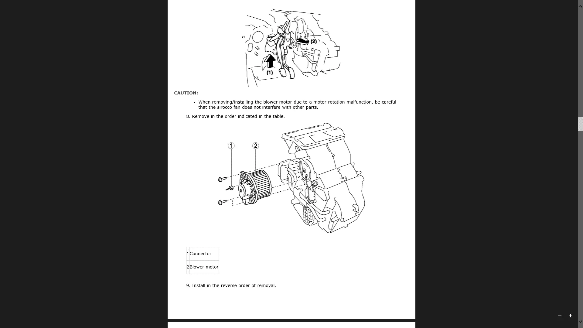

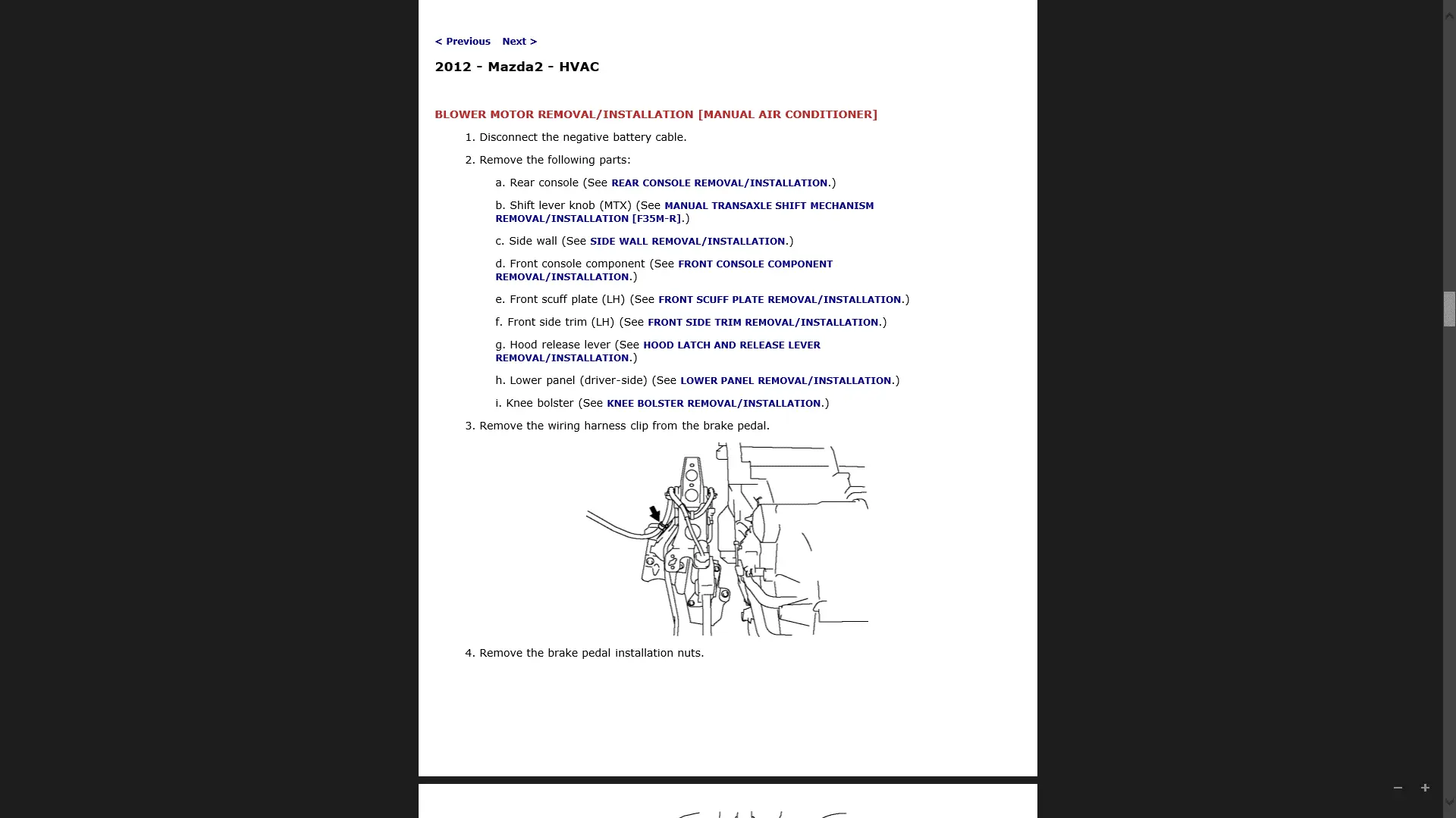

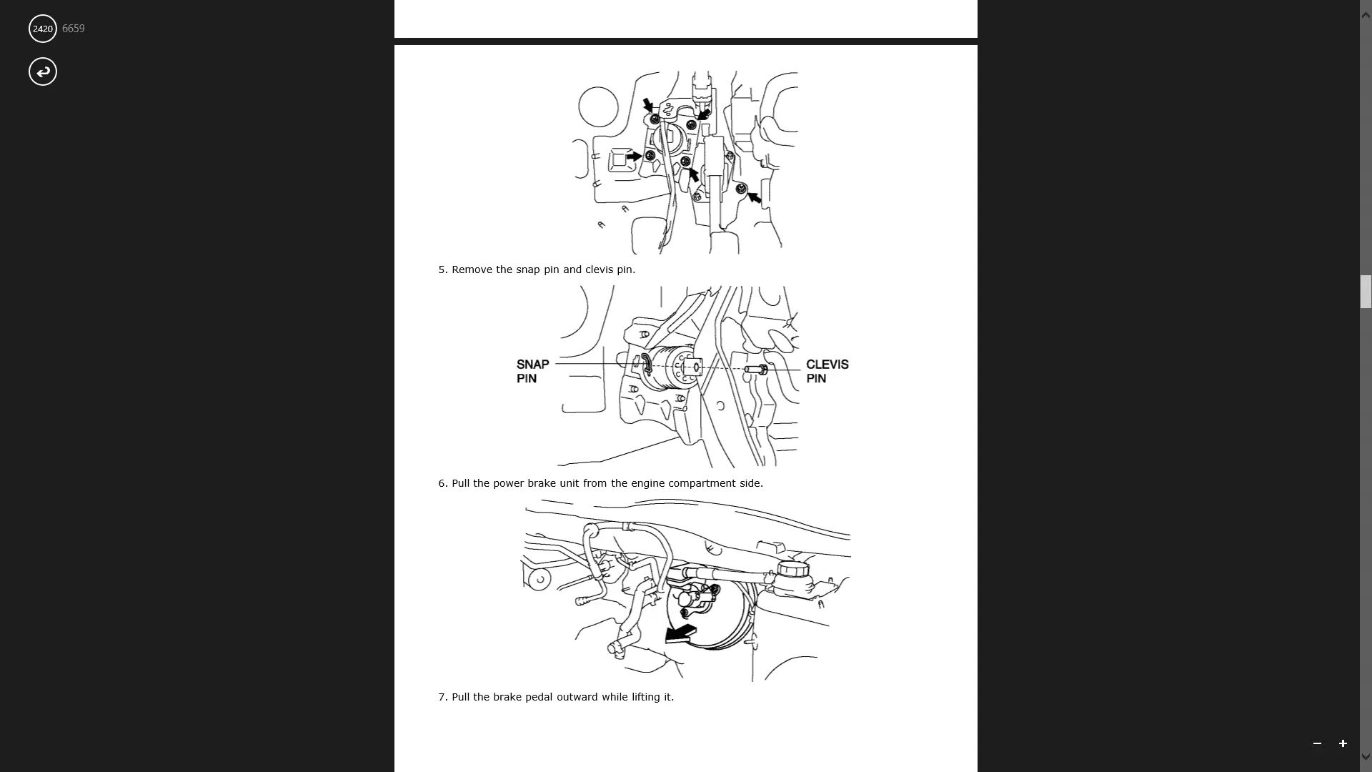

Hi all,
not sure which category this would fit into... but i have a problem with some leaves stuck in my fan blower. it makes a noise every time i turn the fan on.
has anyone had this problem before? I know many say that you just wait until it dislodges itself.. but it's too annoying and i can't wait for that to happen!
where is the fan blower located? what's the best way to clean the leaf out? so far, i have already cleaned out the cabin filter box - there were tons of dry leaves there too
Thanks in advance!
Hi, I am not sure if it worth it, since it is in an odd place (notcool) but here is how the service manual (for 2011-13) cars says to do it not sure if it will work with your 2008 model (sadbanana)... good luck though (thumb)
thanks! really appreciate that. i guess i'll try and live with it.. and when it becomes unbearable and i feel ambitious i'll make use of the manual :)
