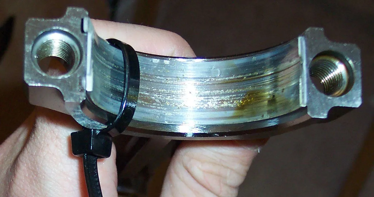

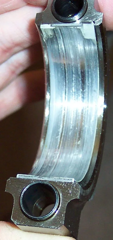

Here are pics of my worst (#4) rod bearings...
Did you run adjusted bearing tolerances? Tighten them down from the stock clearances? Or did you run standard tolerance. Was there any oil port cleanup done and what viscosity oil and so forth were you running?
