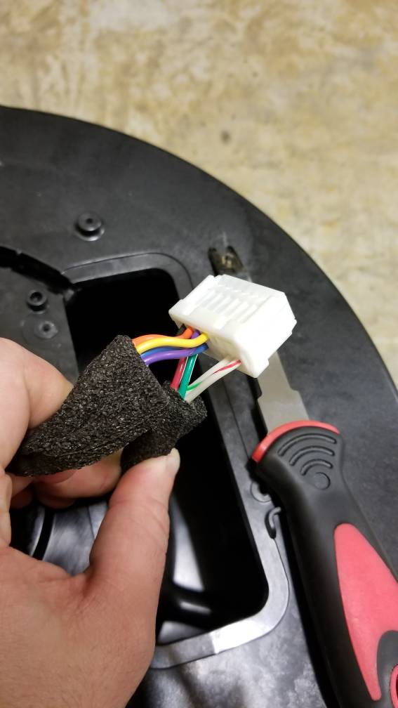

Okay, for anyone that is curious, the cable that connects the bose spare tire subwoofer to the rest of the harness in the trunk, all of the wires needed to install a sub are there:
red is subwoofer +
white is subwoofer -
green is remote 12v
then run power to the battery and ground to chassis ground and you're done. The system works great and sounds good. Hope this helps someone else looking to install a subwoofer in the 2018 bose grand touring cx-9!
red is subwoofer +
green is remote 12v

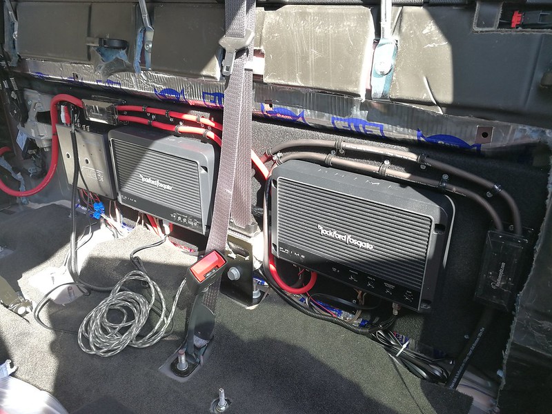

I have a 2000 watt amp and everything needed to install some subs, all I need to do is tap into those wires leading to the sub and I’m all set?
yes, you'll need a line output converter obviously, but the LOC negative signal wire is to the white wire in the harness, positive signal wire is to the red wire in the harness, and remote power on for the amp is to the green wire in the harness. you'll have to run pos to the battery obviously, and ground the negative to the chassis.
Ok so I took on the project yesterday, ran power wire from the battery, grounded with the bolt on the back seat, and tapped into the wires you said to with the converter and connected the rca cables. For some reason I can’t get it working. I’m wondering what I could be missing.
did you connect the remote power wire for the amp? you mentioned everything but that. whats it doing? is the amp even powering on? or powering on, but no sound?
This should be the same for my 2020 touring CX9 with 12speaker Bose system huh? Can you tell me what kind of LOC you used and how you connected it (or just post a pic)? Also, is the Bose amp&sub still working along with your additional amp and subs?
i'm not sure, you'd just have to check the wiring harness. i'd guess if its the same, then it should work the same. I just used a cheap LOC off of amazon, something like 12 bucks? And how it's connected is literally in this thread, each wire, further up. the factory bose amp&speakers work just fine.
