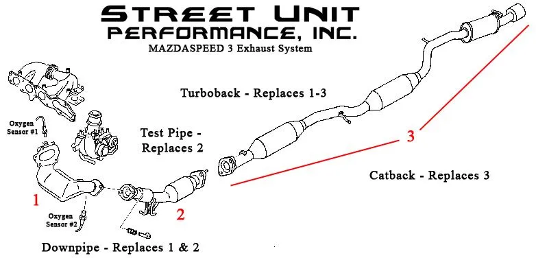

Also, while talking to the guy at SU, I mentioned my next mod being a downpipe. He suggested this:
http://www.***************/SURE_Motorsports_M3_Track_Pipe_MAZDASPEED_3_p/sure0400.htm
Description says "track use only". What's the difference between a race pipe and a down pipe? I had looked at a Cobb downpipe. Looked totally different to this. Suggestions?

This image explains it all:
