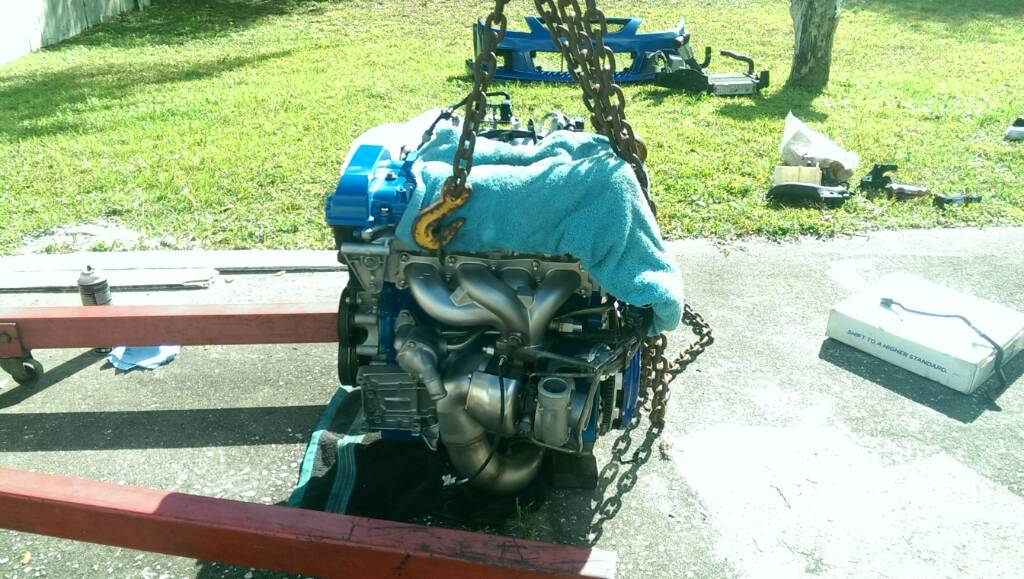

Just bought a mazdaspeed protege drove it for 2 days then heard an exhuast leak. Exhaust manifold is cracked and 2 bolts are broke off in the head....... Where is the best place to get a manifold that wont crack. Any other advice would be appreciated thanks

I have had two of the OEM Callaway manifolds welded where they were cracked and they have held up fine. They crack because the hardware holding them in falls out, if you replace the hardware and repair the cracks it will likely last at least another 10 years.

Hornsfan you are exactly right 2 bolts are snapped off in the head and another bolt head has snapped off.
Looks like the cylinder closest to the timing chain is leaking exhaust from the lack of bolts.
I'm really tempted remove the manifold and weld it after hearing your experience with it. Did you replace your bolts with mazda stock bolts or arp or something else.

I have ARP but the stock hardware will work fine despite the originals failing. Don't waste your time with the ebay mani they will all fail before long, I know from personal experience. If you can spring for an aftermarket mani I would go for it, I try to justify the money I spend on my car compared to what its worth despite how much I love it. But unless you plan to build your car and run over 300whp a repaired stock mani will do you just fine. You have a good plan so far, first get some good plugs and do a tune-up to ensure everything is running properly. I recommend the ebay fmic kit, relocate the MAF and a good quality BOV (makes a HUGE difference over a knockoff), then get a boost gauge and an SS-AFC. Make an SRI out of a leftover pipe from the fmic kit and stick a new filter on the end to save yourself the $300 vs buying an intake. Then look into upgrading the exhaust, at least the midpipe and if you want a more aggressive sound, delete the cats and resonator. After that get some solid motor mounts and maybe delete the VTCS if you like. Then you can get into the real fun of a boost controller to run a couple more psi and tune the AFC. You would not believe how these cars run with just those mods:fmic, intake, exhaust, mounts, afc, boost controller.
Mine cracked 2.I am replacing mine with a ebay chinese special SS manifold.I got it for under 150 dollars shipped so it wasnt that much but it wont be install until i get it back from my welder.He is redoing most of the welds and adding some more bracing to it.My welder is one of my best friends so im really not spending a lot on this.I also went on ebay and for under 30 dollars i got the correct length ss studs and 8 points locking nuts.The oem manifold will get fix 2 and save in case i need it later.
I got the exhaust manifold removed, had to remove the oil line at the engine block side since could get a wrench on turbo side. Drilled and removed 3 broken bolts out of the head, this car is stock except for forge wastegate. Tried removing intercooler pipe, seem that there it some sort of crimped fit on it never could get it off just turned it out of the way. Went to the dealer and got a MLS exhaust gasket since auto zone didn't have a MLS available

I welded the exhaust manifold and drilled the broken bolts our of the head.
Bought a new MLS gasket from the dealer and got some 10.9 grade 8 m8 x 1.25 x 30mm bolts from auto zone.
Runs a lot better now.
