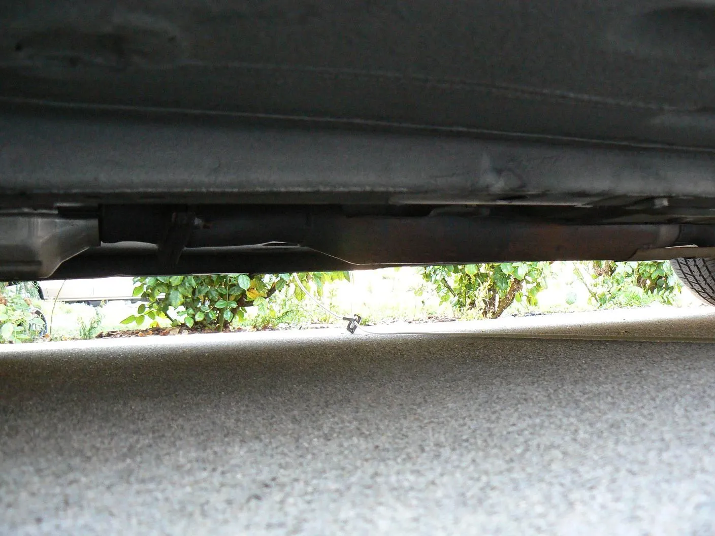

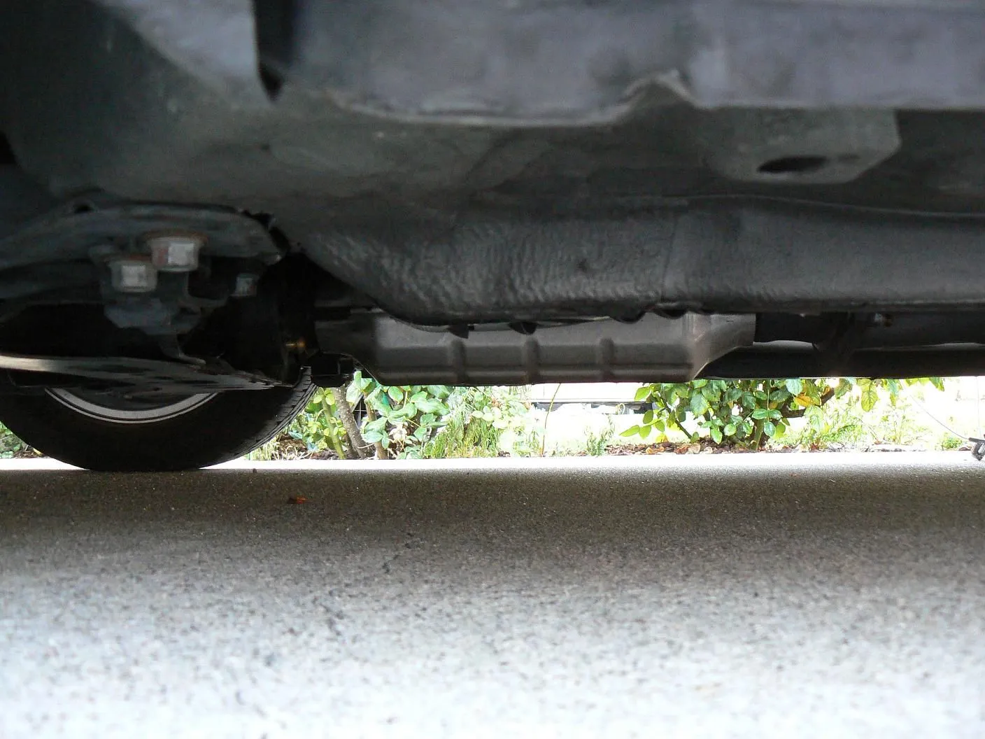

I've got an '02 LX sedan. Every where that I've read indicates that all Protege's have the same exhaust, with the exception of the axel-back portion. Even the shop manual online shows only one exhaust. My sedan, however, looks different. If you look at my exhaust, you'll see what I mean. I just got a catless midpipe too(it's on the way), but i don't see how it's gonna work here. lol My cat-ed midpipe is a very short section, and after that it's one long pipe that contains the resonator, and it just keeps going until it reaches the axel-back portion. The SLS midpipe that I have on the way says it'll work with any Protege exhaust too. What's going on here?

you're over thinking it - the cat-less mid-pipe replaces that short section where your cat is, not the whole exhaust. if you bought the SLS pipe, as soon as you get it in your hands, you'll see where it goes and what it replaces.
LOL I wouldn't be surprised if I was. Just the same(indulge me here), the pics of midpipes that I see make them look so much larger than that tiny little section. Like the MAM for example. There's an old pic I just saw where two dudes are holding midpipes, and the pieces look so much longer. Maybe I'm missing something obvious? And yes, I know it doesn't replace everything after the cat. :D
Look closer! It runs over the front crossmember and bolts to the pre-cat section. I made my own catless midpipe then bought the SLS one but I think it was like 40" long same as stock. The only difference between proteges is the P5 has a longer straight section in the catback. And the MSP and MP3 that came with the racing beat catback which are still swapable.
D'oh! You're right. My bad! I really shouldn't think about anything like this right after work all night. lol (hand)
