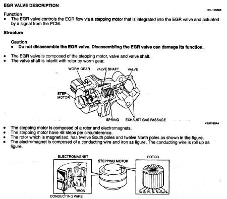

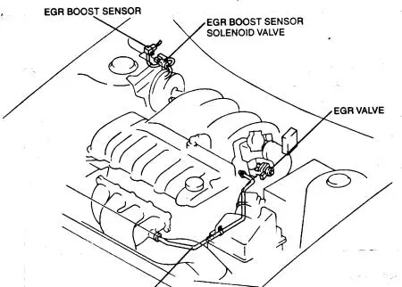

I still need to know WHERE the egr is on our 99 protege 1.8Ls! Anyone that can help me out with a picture or detailed description will be my hero! (the how-to on cleaning the egr is great, but thats a 2.0l protege and my egr is NOT where they show.)
Score!
