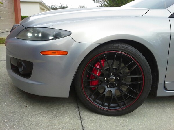

there is a thread about someone fitting EVO VIII Brembos on a speed3
Brembo's on Mazdaspeed 6
EVO-X brembos on MS6
Anyways, so onto the good stuff

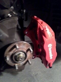

the fact that this brakes cna be modified to fit the MS6, and the MS6 are direct bol-on to the Protege, leads me to believe they will be able to bolt up to the protege with minor modifications.
now, while eating crap on facebook i came across a post from a friend of mine prasing his new brake setup on his RX7...and guess what..they were EVO8 Brembos on his FD.
now, these are bolt-ons wihtout any modifictaions on the FD using G37 rotors.
So...putting one and one together...the FD brakes will fit the protege with minor modifications.

i'm getting a set for 100$ to test fit...

Both evo and FC calipers bolt straight up to the protege but you will require custom rotors or hats. This used to be a fairly common swap "back in the day".
