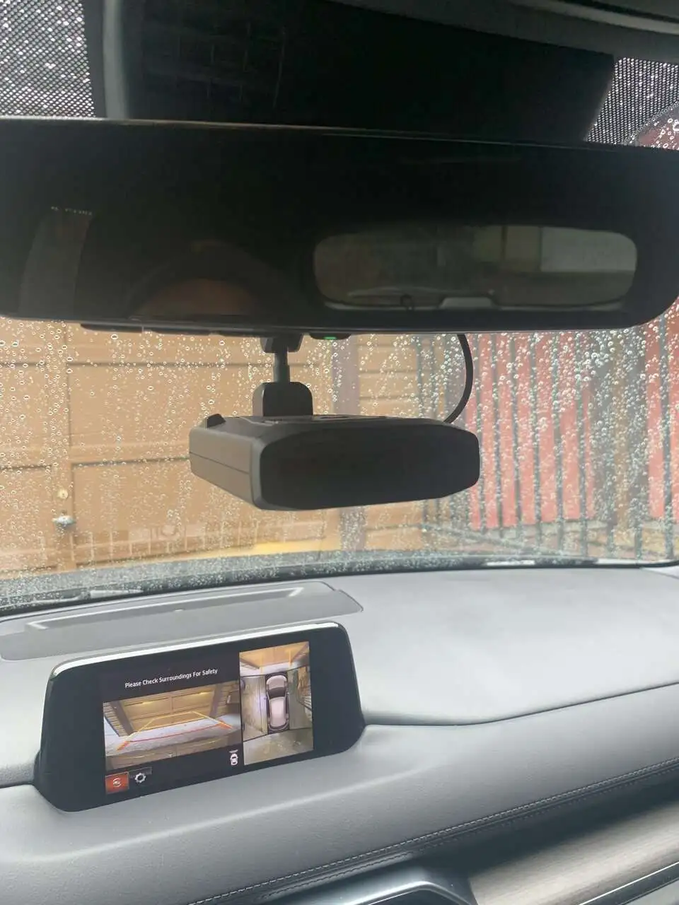

2019 CX 5 signature
Escort redline 360c (came direct from escort with latest firmware 1.9)
Mirror taps: MTX-1015, RJ-11, 15" Long (from amazon)
Mount from etsy (Escort MAX 360c IX Ixc Alloy Radar Mirror Mount for Radar | Etsy)
Notes:
-Does not come with a mini usb to connect to computer
-I removed the rear view mirror plastic stem cover in order to ensure a secure mount fitting
- using voltmeter, black was ground, purple was “hot start/accessories”
