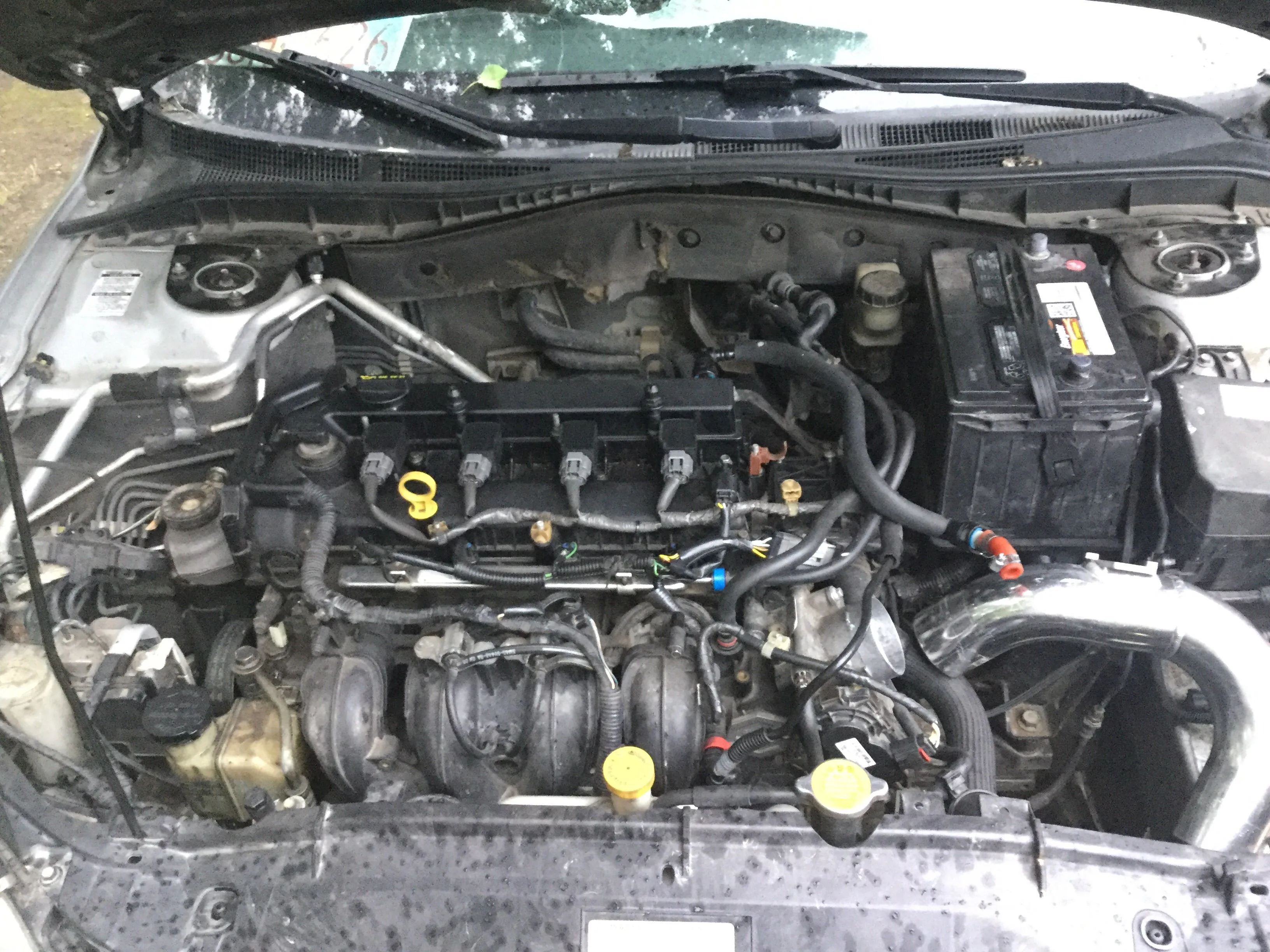

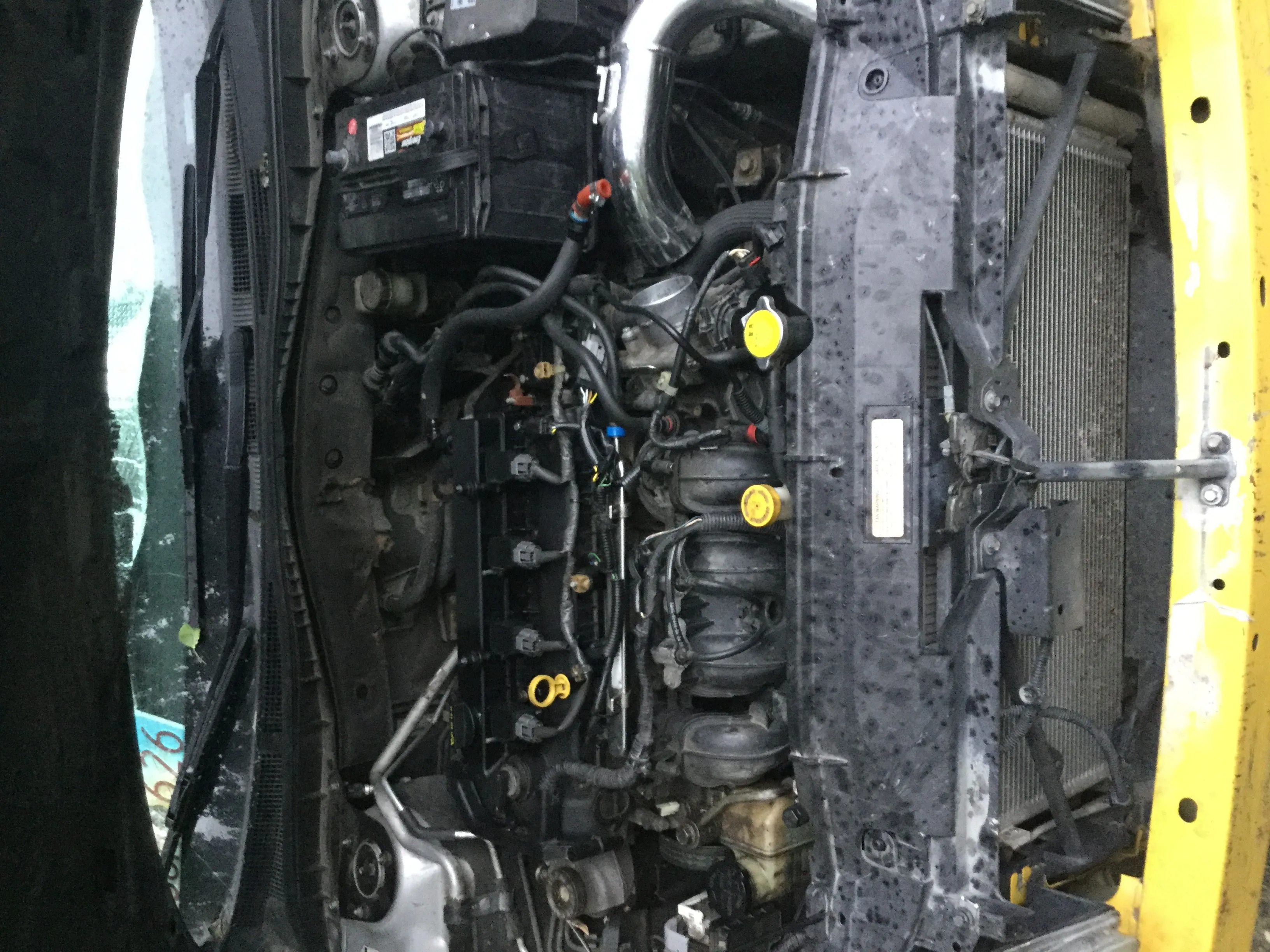

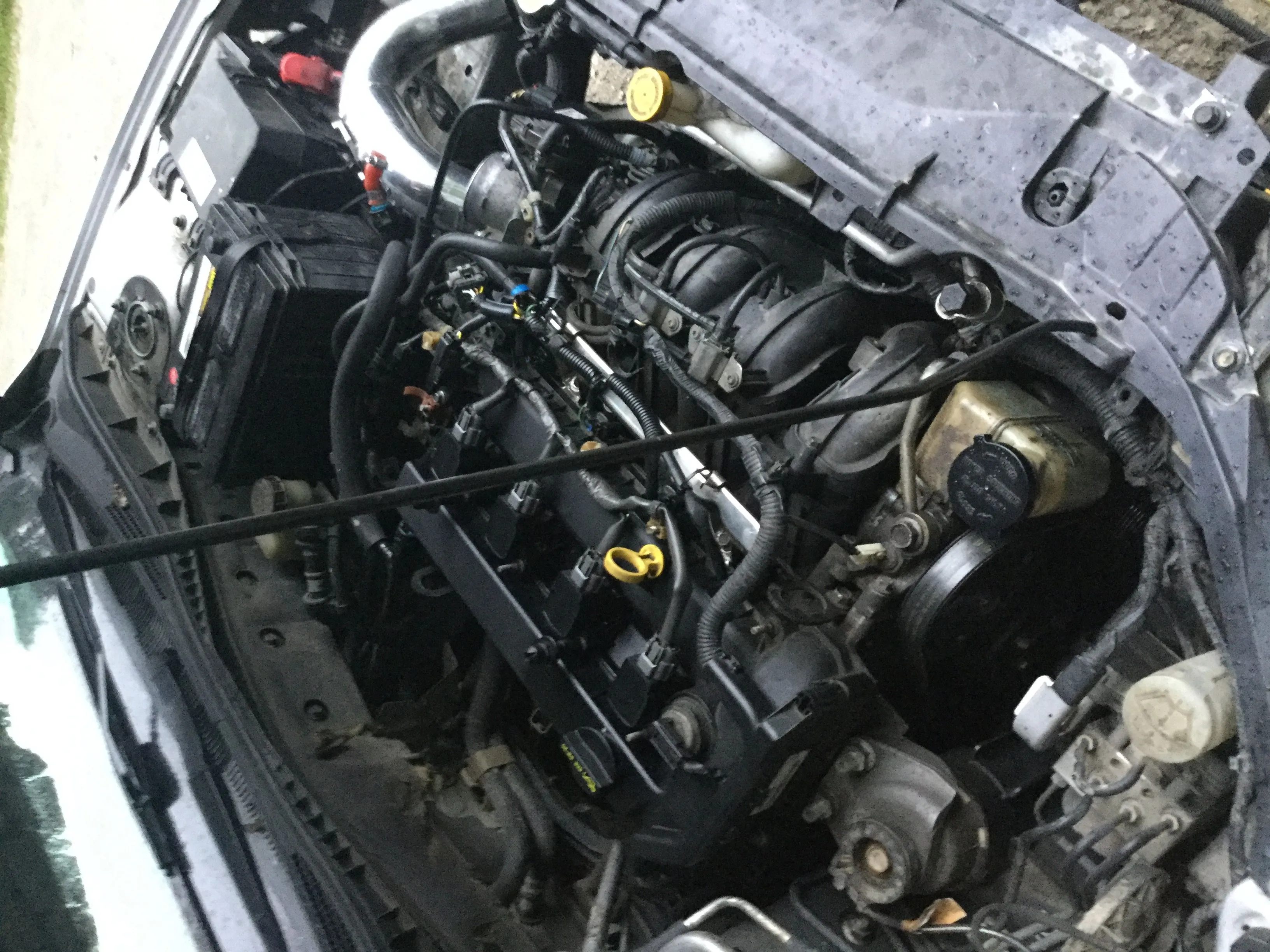

So I just bought a 06 Mazda 6 and I was told when I bought it that the guy put a 2010 Mazda 3 motor in it. The 06 Mazda 6 stock has a 2.3L and the 2010 Mazda 3 has a 2.5. Now for one I'm not 100% sure what motor is in it and I need to know. There*s a 2.5 stamped on the block but not 100%. When I purchased the car the clutch was slipping(taking extremely long to get into each gear and severely lacking acceleration. Because the motor swap I am unsure which clutch kit to purchase.
Any help would be so very greatly appreciated...

Hello again and welcome...Glad you got your post up...If possible, posting some pics of your engine bay (you can add them to your original post) might help those most familiar with this sort of swap in assisting you...Hope you find the information you're looking for...Good luck!

Embedded the pics in your post for you so it's easier to see...Hope someone comes to the rescue here...
