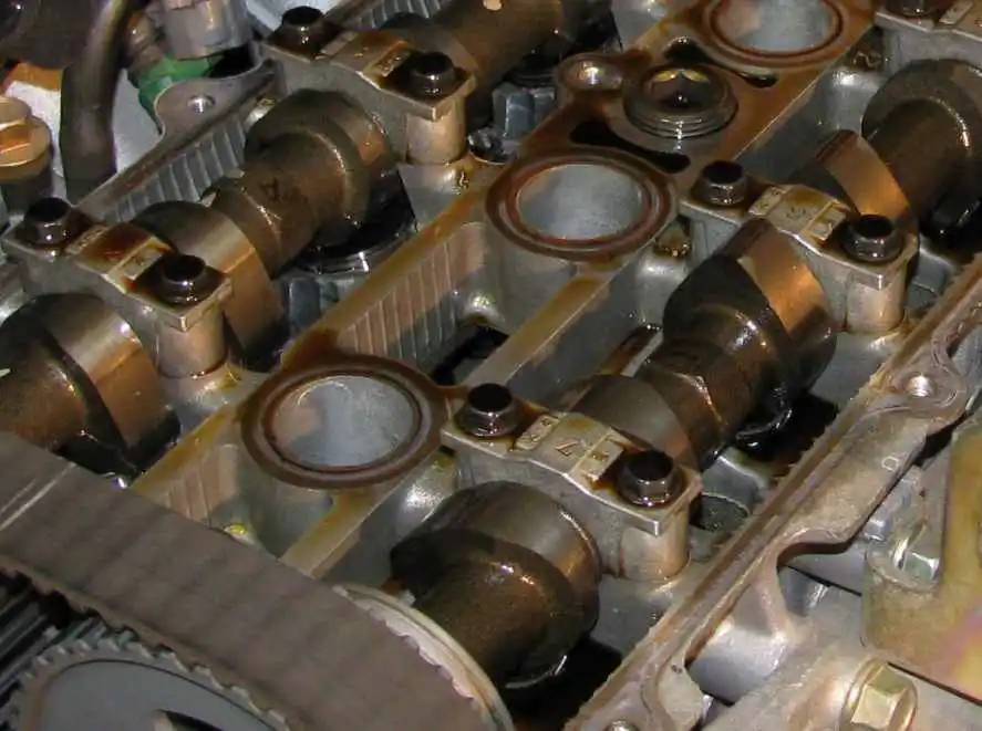

this was our P5 after 100,000 miles I wasn't loyal to any brand of synthetic at that time but changed the oil every 3,000 miles. It took less than 3 qts each time with it so it wasn't that expensive to do it and we didn't put a lot of miles each year on the car but the end results look good. I never ever ran any sort of cleaner through the crankcase either.

Nice, not that 100,000 is a ton of miles for a Mazda. Changing synthetic oil at 3K miles is a lot of wasted oil (unless driving only 3K miles a year, changing annually of course).
Nice, not that 100,000 is a ton of miles for a Mazda. Changing synthetic oil at 3K miles is a lot of wasted oil and time.
yeah, but I hated the little tiny oil filter it had on it and it took half the oil my CX5 takes which also seemed like too little. Probably overreacting but I never expected the top end to be that clean inside. Figured spending so much of the time with it in 90-100 degree heat and short trips it was better to error on the side of overcautious,
