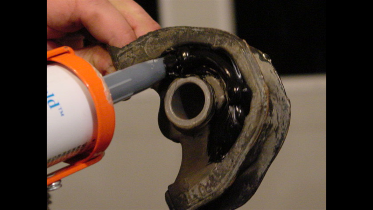

Just do this..
Window Weld.
"so I can replace the rubber mount and put in some urethane inserts."
If you're replacing the rubber mount then just hack out the old one...
Yep, did the window weld trick to the front and rear mounts lol, have the AWR inserts for the side mounts, haven't bought a new mount yet, just wanted to see if there were any tricks in getting the shaft out of the original, but I think it'll be a hack and whack job 😊

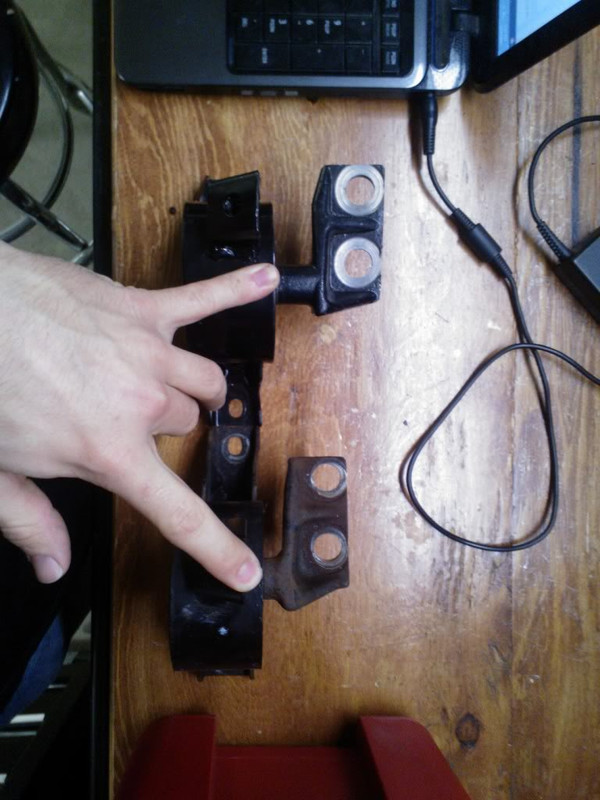

Update time.

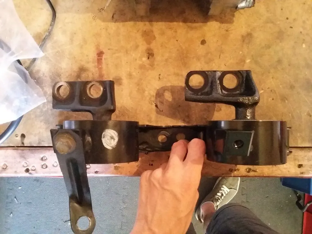

bought a new mount off a reputable dealer that was specified as a MT mount, turns out it's not :(
Grrrrr, will try and return it, otherwise will press the original cast piece out and swap it over
Also did more reading, apparently the AWR inserts will squeeze over the shaft, so no need for cutting, yay!
The used one came with the shaft.
It will probably fit. The mount and shaft are matched.
As far as I know, either entire mount including the shaft will fit either a standard or auto transmission.
Try it the way it is.
You'll know if everything lines up.
As far as I know, one mount has a shaft that is about 1/2" longer but the rubber mount is offset by that same 1/2".
It's when you swap shafts that the alignment goes off.
It kinda makes sense because it's not like the whole engine sits 1/2" closer/further away from the engine bay between the auto and standard.
Used mount (lh side) is the one from the car, RHS is a brand new unit advertised as MT :( the hole centres are about half an inch out, so what you've said makes sense :)
Will try and swap it over, hopefully the dealer has a MT mount in stock!
