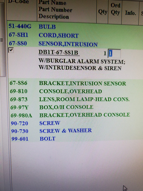

Strange, the online one for cx5 seems to be generic. For example, it refers to headlamp washers and we don't have those in US. That's why I thought this caused confusion with the whole theft system topic.
That below is the EU cx5 details of the intrusion sensor which we don't have in US.
there is no such item in US.
