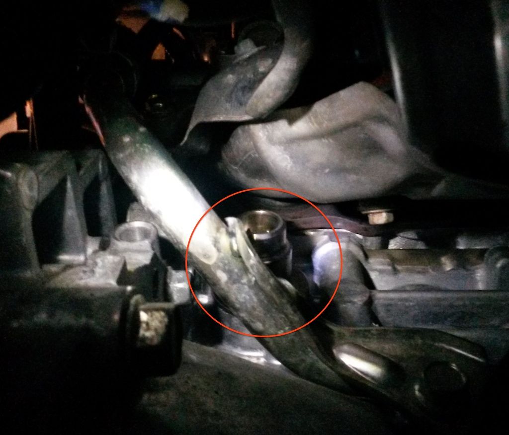

In other news, now that I've had a bit of time to cool off I took a look under the car to assess the situation. I'm going to give the shop some credit in that the freeze plug hole is a PITA to access. It's on the back of the engine, but tucked underneath the exhaust manifold. So in a way it was worth the $160 I paid them to save me the frustration (and probably half a day's time) I would have gone through installing that part alone.
The cable wiring was still complete BS, so I pulled the cord out of the car and reinstalled it the way the instructions show, with one exception. Since it's a pain to plug the cord into the heater element, that kind of dashed my plans to remove the cord during the summer so it's not flapping around on the front grille. What I did instead was bundle up the length of cord that would have gone through the grille and velcro tied it around the washer bottle filler neck. That way it's tied up and out of the way when not in use, and to use it, it's as simple as popping the hood and pulling the cord out, then closing the hood with the cord coming out.
Here's the heater installed in the block, but without the cord attached.
