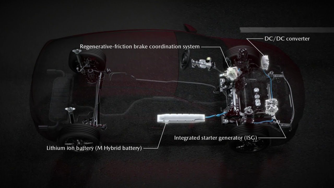

I've searched the forum but didn't find any information about e-SkyactivG that I have in my 2.5 NA 2023 CX-5.
Do anyone have any documentation, links or information that they can share about what it is, how it works and what the under passenger battery is used for?
I have i-stop configured to turn off after car starts as i don't like that feature :)
Thanks for any information/links :)
Mild Hybrid in the Mazda makes i-stop very smooth, because it does not use the starter motor, but the Integrated Starter Generator which is part of the Mild Hybrid System. Therefore I would recommend to use i-stop.
Brake energy is stored in the battery and used to assist the motor when accelerating.
