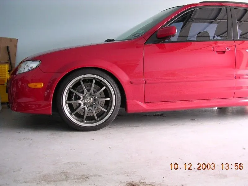

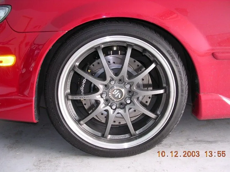

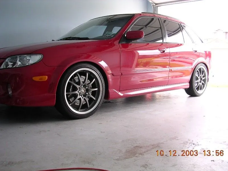

I have yet to get this kit as planned (engine build up...took up my time).
But...one of our local members installed them and the ease of installation was unbelievable.....very straight forward.
Here is a pic....note the RX-8 Rims.
