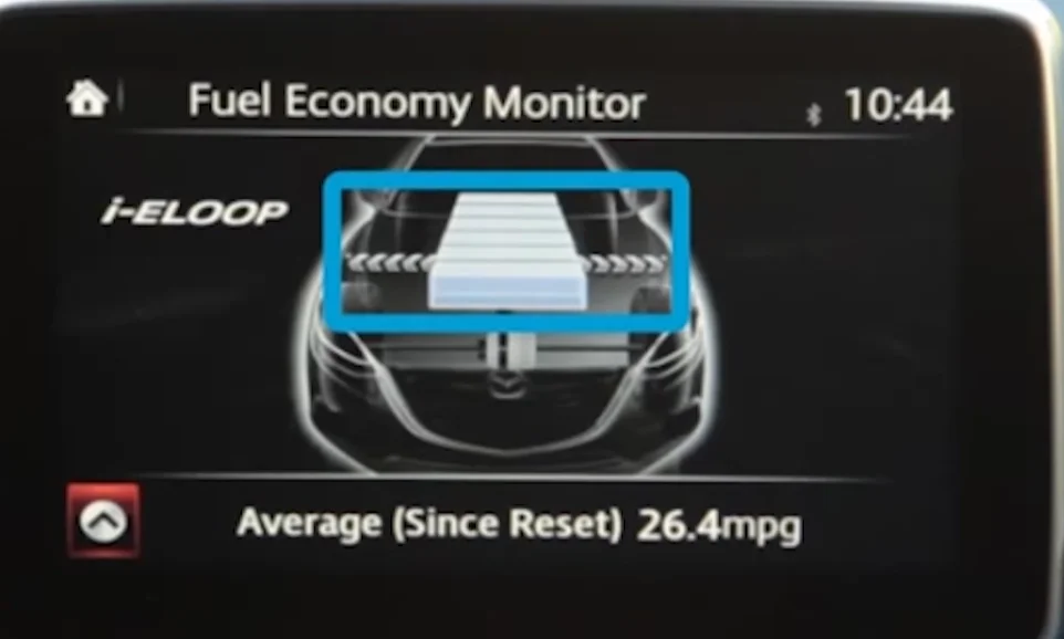

We went ahead and replaced the i-ELOOP capacitor, which immediately resolved the voltage instability. After that, I checked the Fuel Economy Monitor and noticed that the i-ELOOP logo and charging animation were completely absent. As far as I can recall, they were never present when I first bought the car either. For reference, below highlighted in the blue square and the text saying i-eloop is what i am missing.

- Is the missing i-ELOOP animation in the Fuel Economy Monitor due to i-ELOOP being disabled at the IC level?
- Or is it possible the previous owner/dealer did something deeper—effectively “removing” i-ELOOP from the infotainment display?
