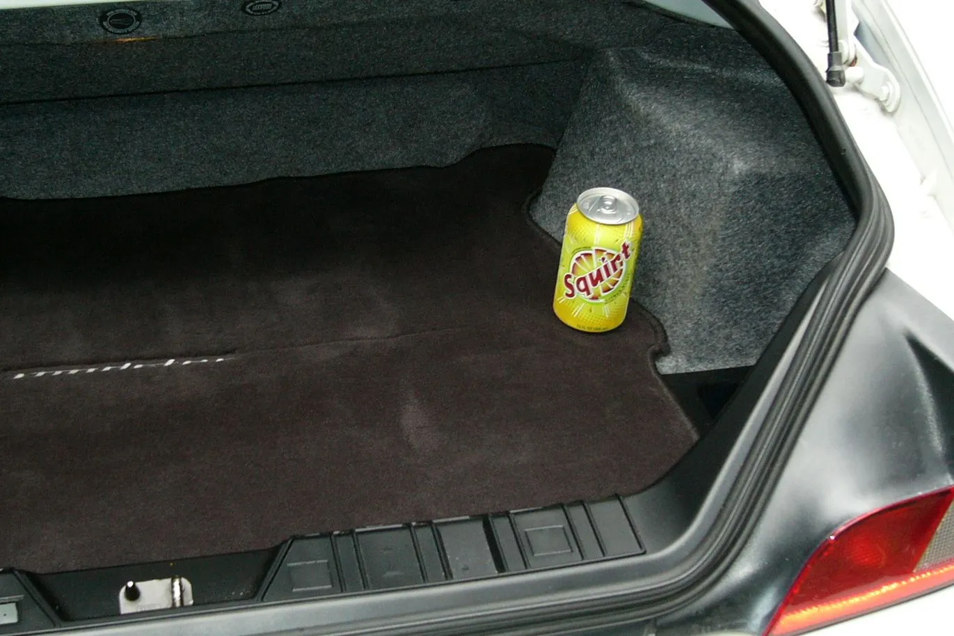

Maybe I'll post a pic of the spot for fun tomorrow.
Here is pic 1...factory spot is behind the soda can (for size reference)...

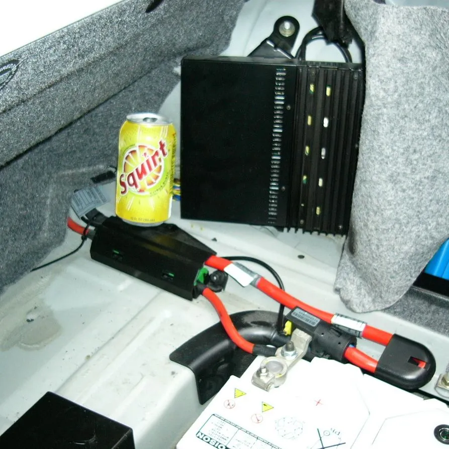

And pic 2...factory so-called amp behind carpet next to battery. Re-measured it and it is as stated before.
That isn't much space and its not a great design for cooling but I think the smaller of the MTXes will definitely fit. The larger one might fit but its hard to tell without using a ruler. Mounting any amp will be difficult. You don't want any metal to touch or noise will be introduced into the system.
Cut out a 1/2" board as large as you can to still fit behind that carpet. Remove the amp and bolt in the board, you may need to get creative with the spacers and make a bracket or 2. Then put that carpet back, mount the new amp onto that board that is now behind the carpet. This will give you alot more room and better cooling.
