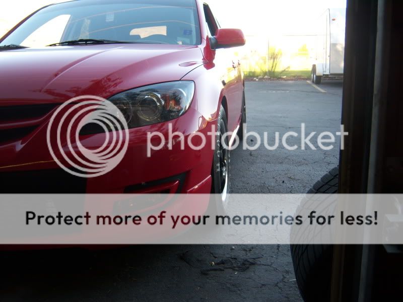

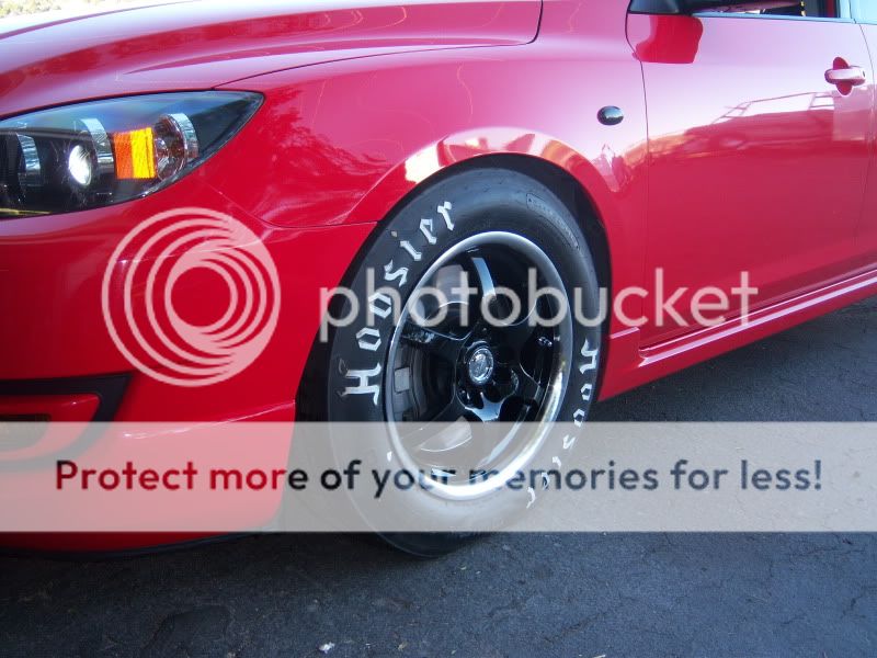

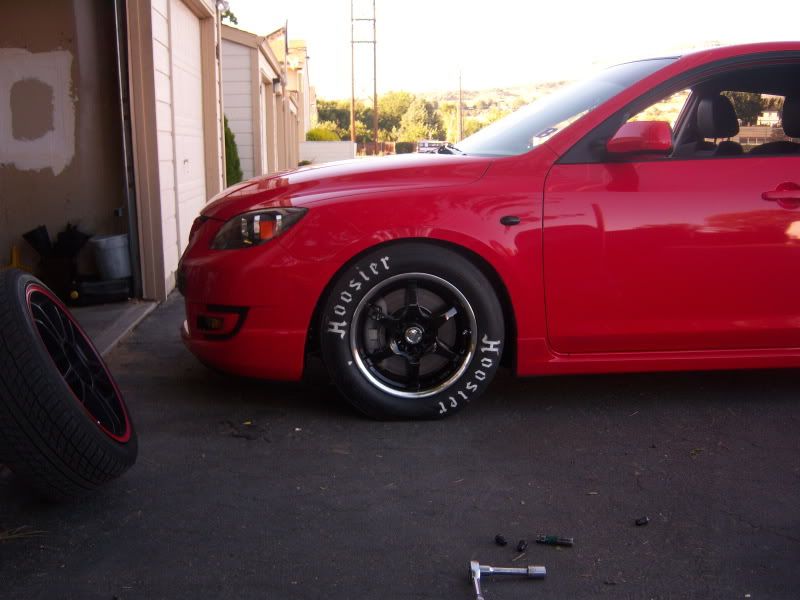

Hoosier quiktime pro 26x8.5x16. Super lightweight mounted on these raceline wheels in 16x7.5. These should work just fine. Hoping to hit some 1.65 60fts on these badboys. The last time I was at the track was on 24x8.5x15 m&h slicks. Got 1.75 60s out of them but just not enough sidewall and to short. Have to hit 5th gear. The 26s will allow me to go 115-120 in 4th gear. Stay posted for good stuff. LOL
H&R springs. Ptp rear engine mount. these are 16in wheels. 15in wheels will fit with billet adapters. Thats what I ran last year. Worked killer.
Jebus, with a good launch you should be running mid 12's at least. What's your best 1/4 mile trap so far?
Looks good too!
12.5@109 on 24inch slicks. Now I have 3071r and these bad boys. I wanna get that 11 second slip the mazda community has been waiting for.
