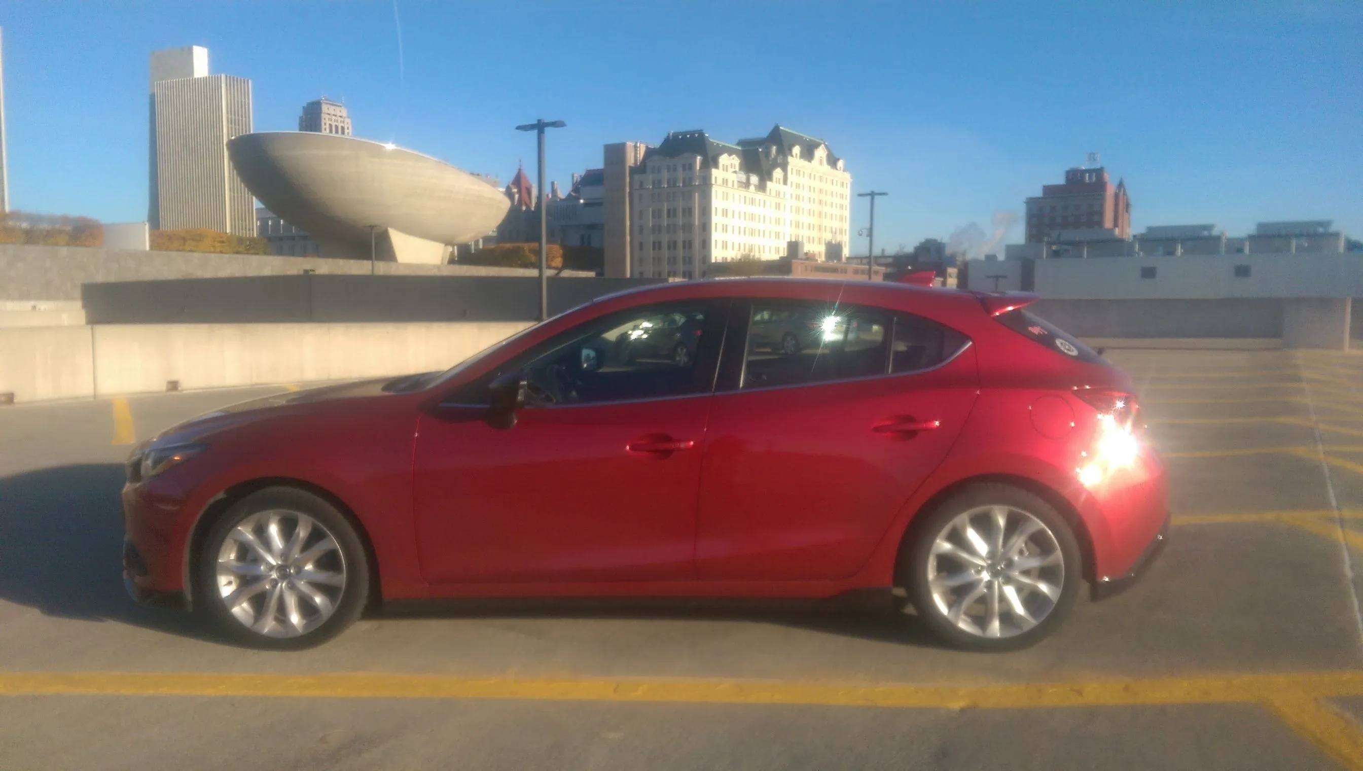

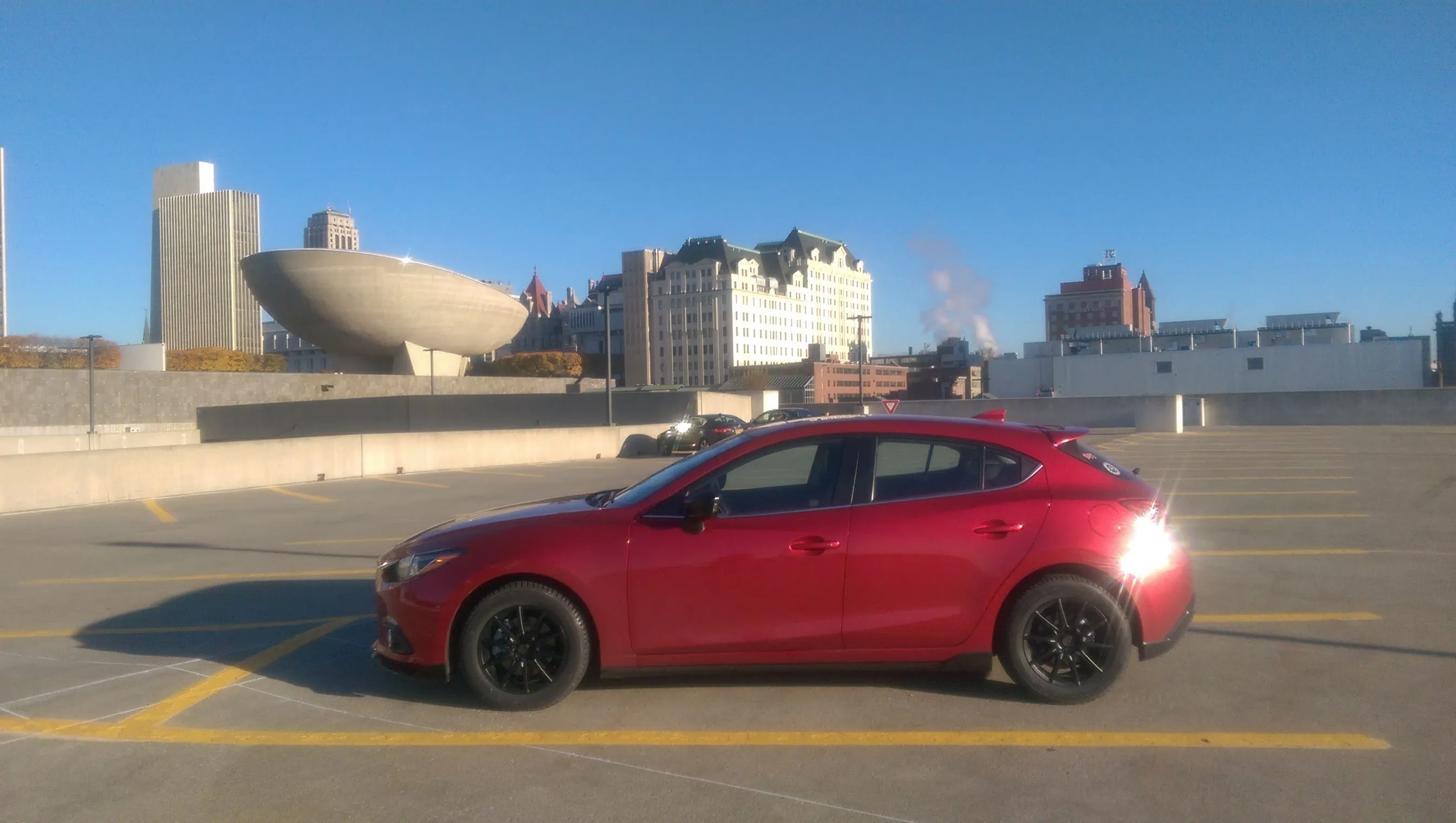

Before and after. They were put on yesterday afternoon. So far, the only thing I've noticed is the quiet.
