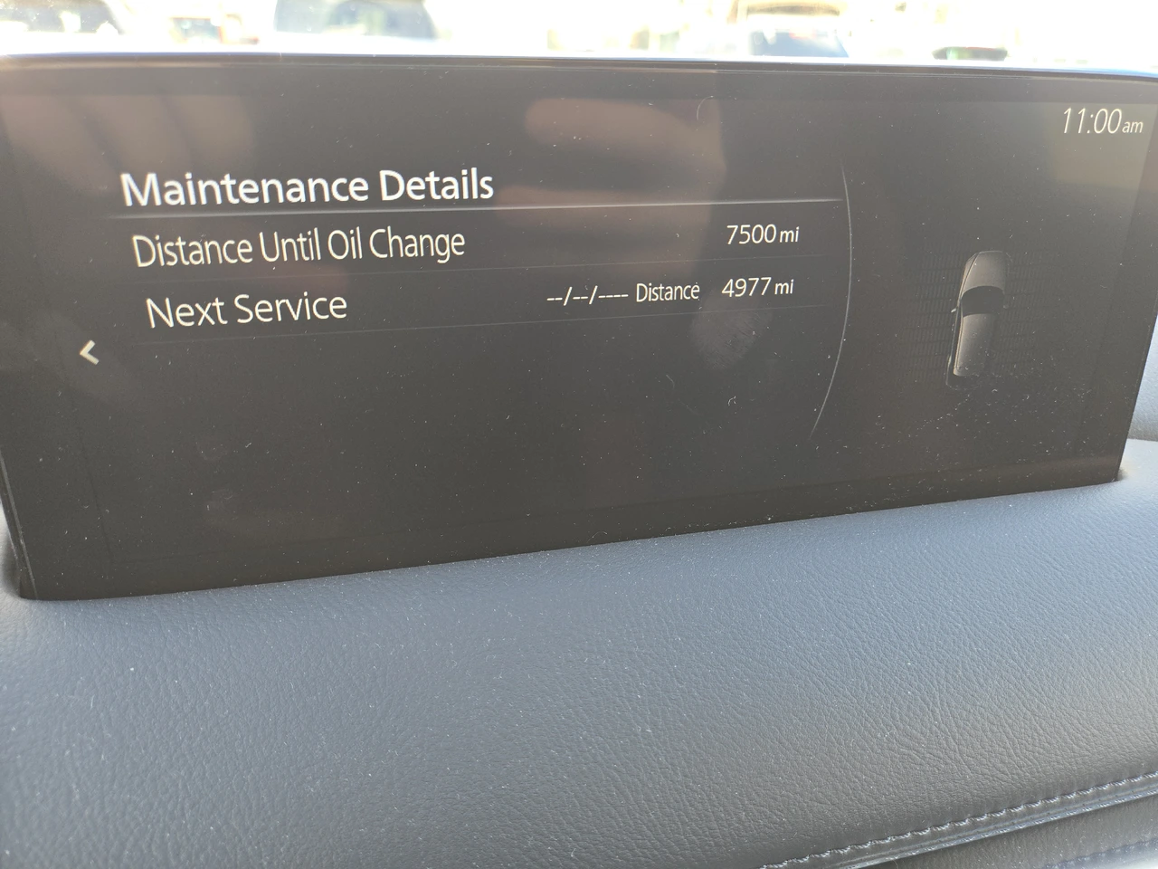

Does anyone's USA CX-5 "service due in" indicator on dash display numbers in km despite miles label?
I recently bought a 2024 Carbon Turbo (I'm in the US) and changed the oil at 1,500 miles.

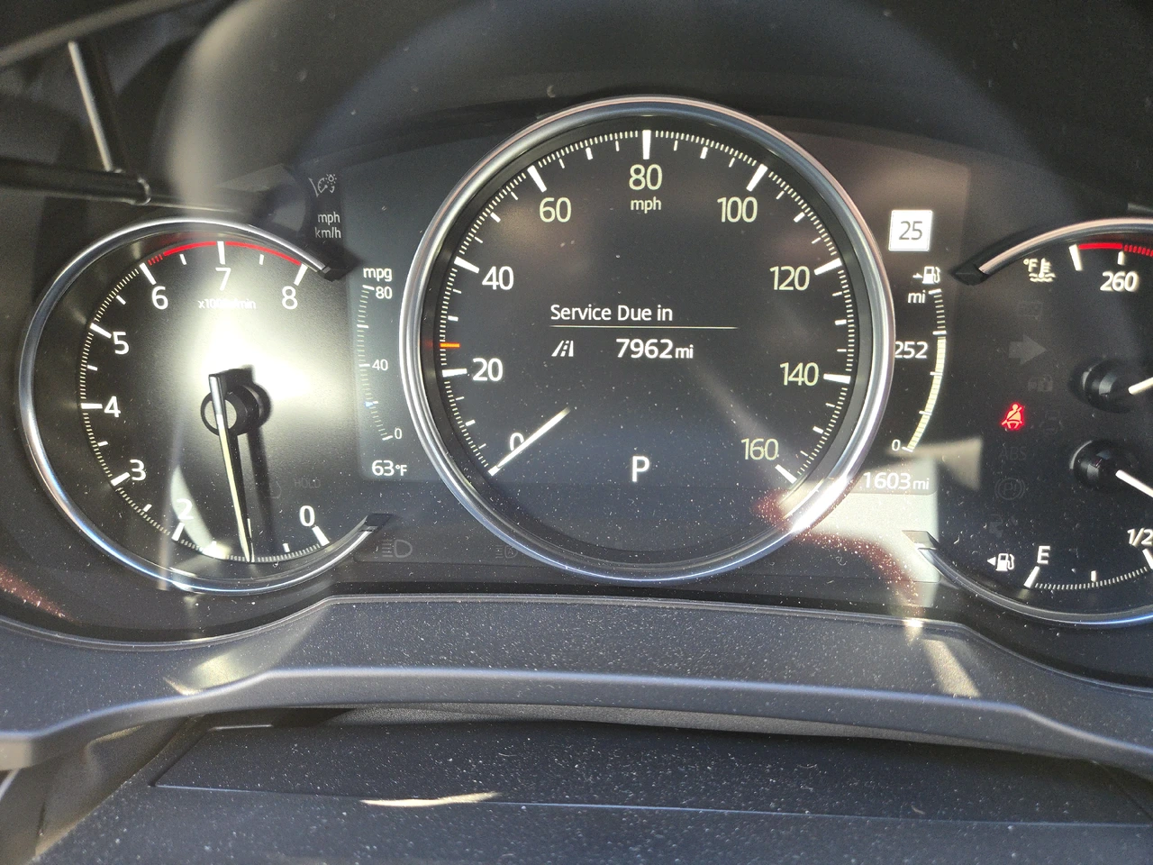

When I bought the car, it showed 12,000 on the dash for "service due". When I changed the oil at 1,500 miles it showed 10,000 for service due on the dash.
From my understanding the factory setting is to change the oil every 7,500 miles. This translates to roughly 12,000 km which is maybe why it showed 12,000 on the dash when buying the car.
After changing the oil, I reset the interval in the infotainment center to 5,000 miles. I then looked at the dash and it showed service due in 8,000. 5,000 miles is roughly 8,000 km.
Is the "service due" on the dash measured in kilometers while in the infotainment center it's measured in miles?
I can't find any info on this subject and want to make sure I'm not going looney. Thanks.

There's definitely something funky about it. Look at the service due per dash compared to the next service date that I set at 5k miles. I drove 6 miles and it was correctly accounted for in the infotainment center but on the dash it shows 10 miles. One km is what, .62 miles? From what I see the dash "service due" shows miles but is being calculated in km.

I am not sure why there are different numbers but by looking at your pictures the answer for your question is straight forward: miles. Every single number shown in your pictures has "mi" after. I have second gen infotainment and this looks like the third gen/10' screen infotainment and I am not familiar with it.
Speaking about the different numbers, I see that you have set the next oil change and the next service. I prefer to set just one, the next oil change and that's it. Now, your car has only 1584 miles on it so I assume you're still under the dealer warranty and you want to take advantage of it.

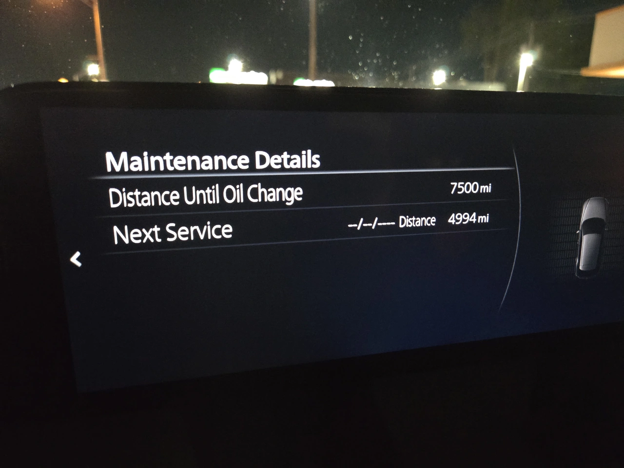

If you take the bottom number, 4994 miles , and multiply it by 1.6 you get 7990.4 kilometres with the ratio 1 mile = 1.6 km. But the actual ratio is 1 mile = 1.60934 km. If you do the math now, you get 4994 miles = 8037.064 km. So, yeah, something is funky there.

My guess is there's a conversion glitch in the dash for "service due" at a ratio of 1.6 km (maybe the software rounds) per every mile. 5,000 miles x 1.6 = 8,000 km. Here are two pics from just now which give further evidence to the conversion rate glitch I just mentioned.

If I leave it at automatic, the dash will display 12,000. What is 7,500 miles x 1.6? 12,000.
Problem solved! First and foremost, there was something wrong with the dash. I bought the car with 15 miles on it. So it either happened during that period or came from the factory like that.
I changed the service interval back to automatic and 12,000 showed back up on the dash. I then changed the setting to kilometers which caused the dash to change except for the 12,000, but instead of miles next to it, it now showed km. I then changed the settings back to miles and the 12,000 changed to 7,500. I had a good feeling at that point. I changed the service interval to 5,000 in the infotainment center and 5,000 popped up on the dash. Woohoo!
Long story short, the "service due in" on the dash was running and set in km even though it was labeled miles and the fix was to go into factory settings and change to km and then back to miles.
