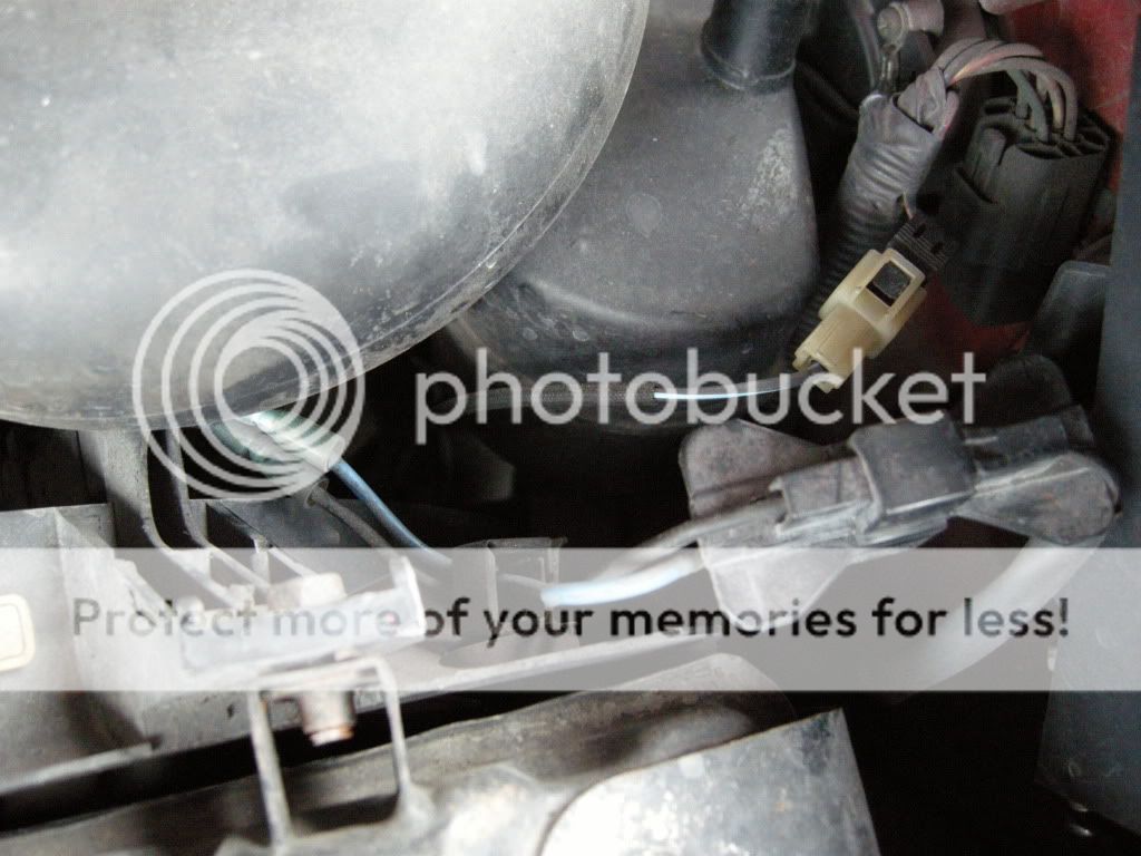

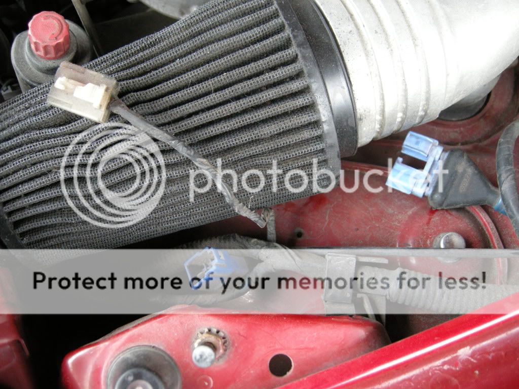

I'm going to include 2 pics.. these are 3 plugs that don't go anywhere..
And here is a pic of what the splice looks like. Any help in identifying any of these plugs would be a huge pointer into the right direction for me. The large connector is what it's plugged into.

I couldn't scrounge up a wiring diagram, but we did actually happen to have a 92 miata in the shop I could peek at. One of the tech's informed me that the wires in your first and second picture actually have nothing to do with the radiator fan. From the first picture,
From Right to Left:
The light blue connector piece on the far right is actually used with the airbag system.
The royal blue connector piece is used to toggle the check engine light.
The white piece on the far left with the longer wire would be connected to a cruise control unit if it was present. It would appear from the pix that your car does not have cruise control?
Hope that helps!
Evan
Evan,
If you could peek under the hood, yes, that would help. 2 owners prior to me, the engine was replaced, so, there's a good chance, none of that was ever hooked back up.
Its just the last thing that i want to do is wire a hot switch to that fan, and stick it in the car..lol. Plus, I hate splcing wires.. If i have to make a switch like that, i want to make sure it's semi-permanent.
From the second picture, it looks as if the fan is connected properly (large black connector).
The small white connector in the second pic is for the A/C clutch.
