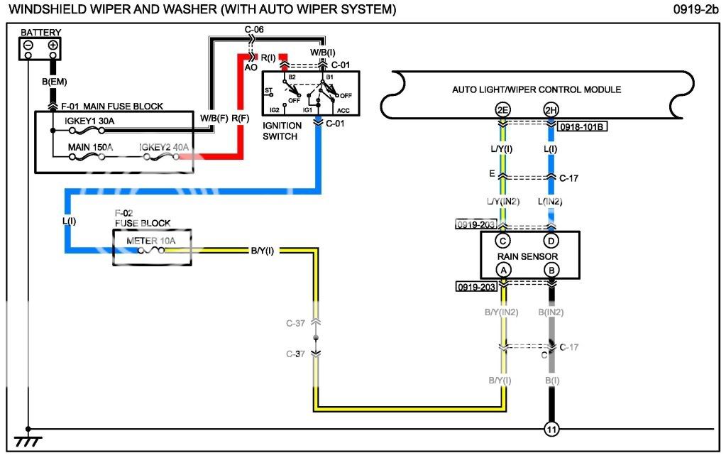

Nice DIY! I tried every wire in the console to get one that was 12v and switched on/off but couldn't, and hence ended up at the fuse box.
This is from AllDataDIY. Notice the (Y) IGN power wire up by the rain sensor module. Not sure why someone would need ACC instead of IGN. I have not tried this, but I cannot see why it would not work.
