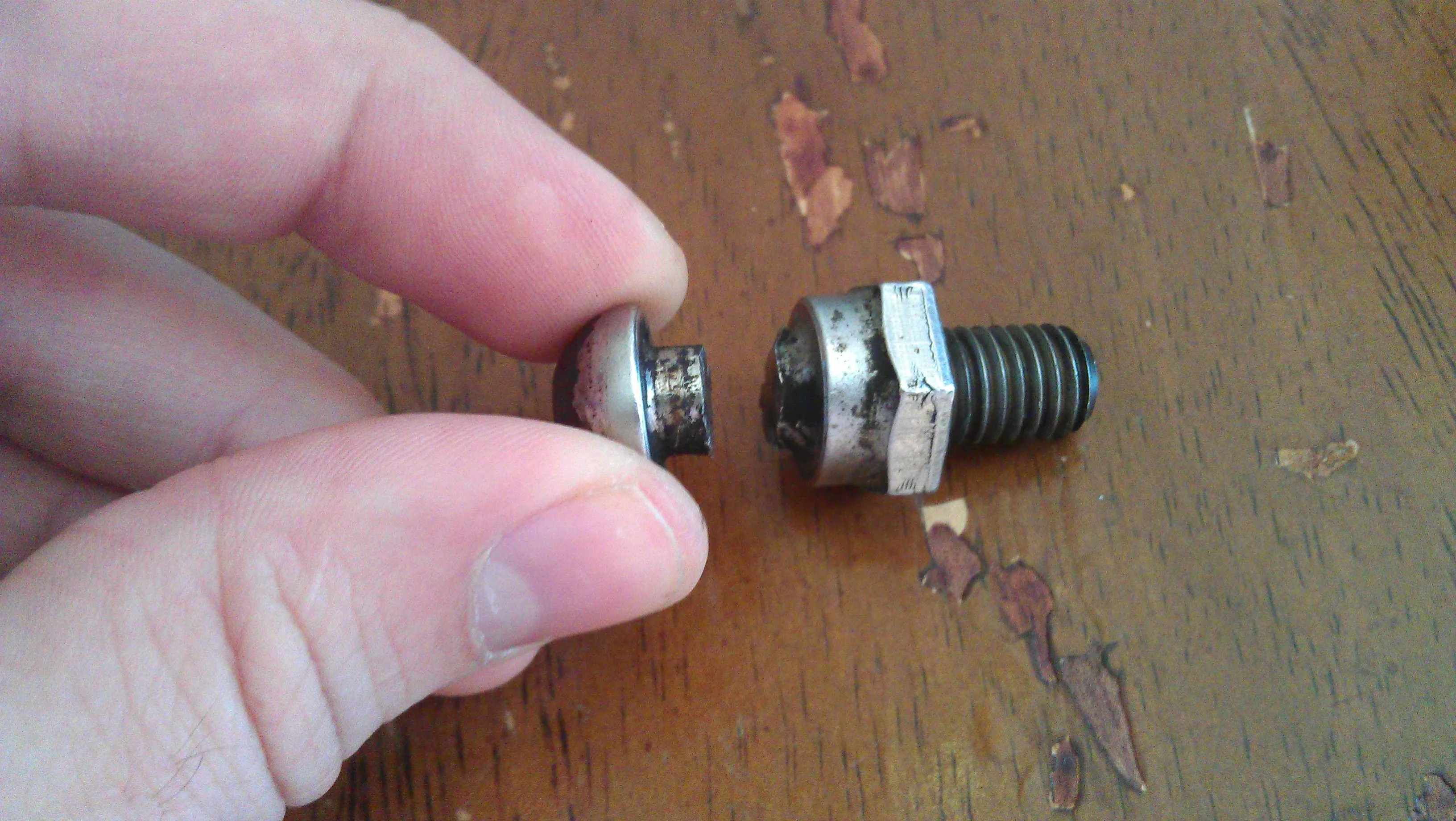

My clutch peddal went to the floor. I found that the fork (clutch release lever) is loose which causeed the slave cylinder to extend out and I lost fluid. Why would the fork be loose? Has it just come out of place? Can I put it back in place without dropping the transaxel?

on Mine the pivot pin had snapped. Out Mechanic said that there have been problems with the stock pins, and now they are replacing them with bigger / tougher ones. Here is a pic of my pivot pin:
Perhaps yours has broken too, so the fork is not sitting on it.
Turns out the fork is broken. I am going to go to the auto wrecker and see if I can pull one. I hope I can put it through the hole and I don't have to drop the transaxel.
Thanks for your reply and picture.
