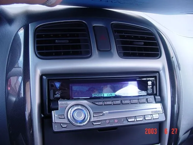

I had the same prob b4 it got stolen. I replaced it w/ Kenwood-KDC-MP922.
