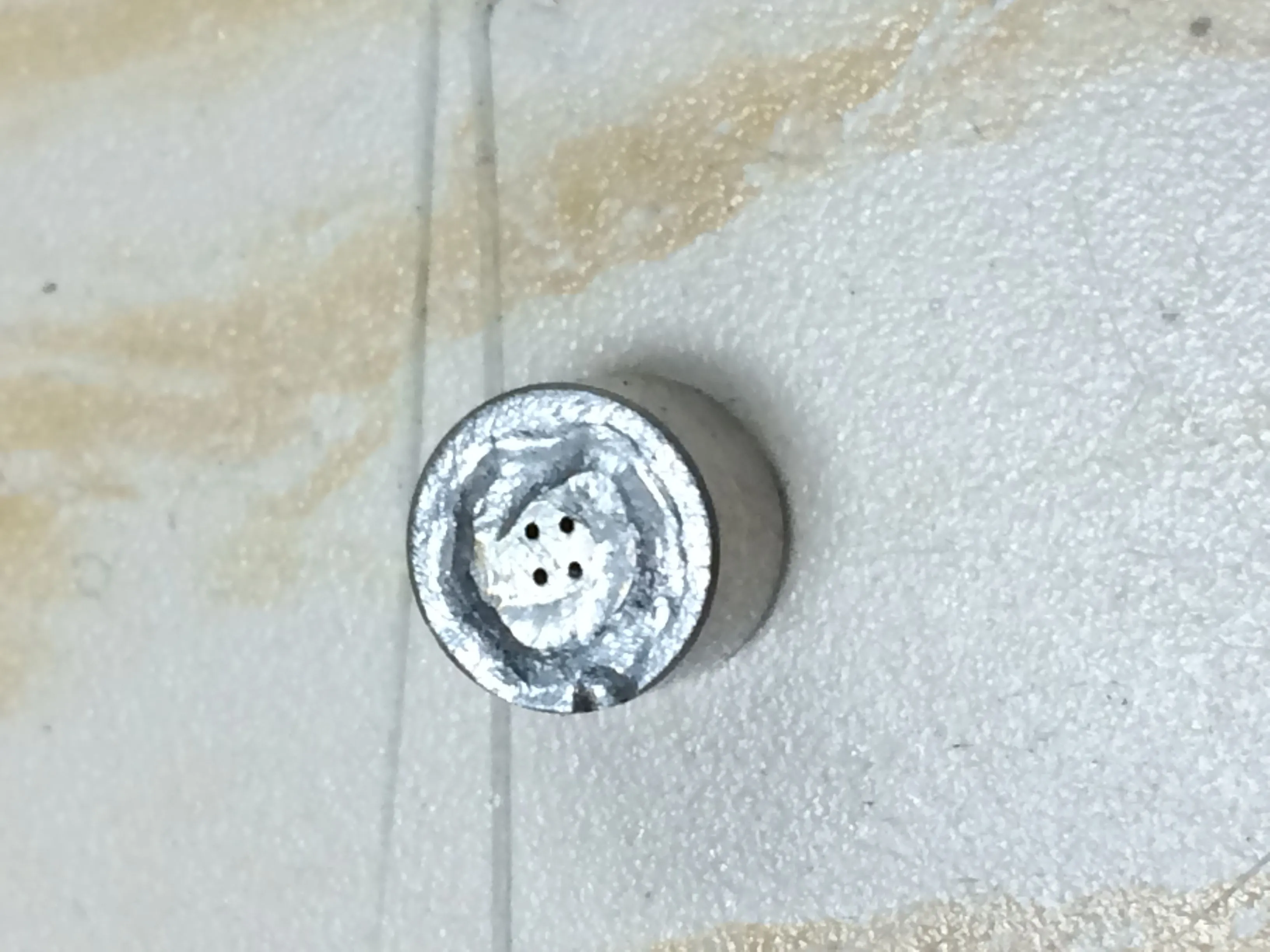

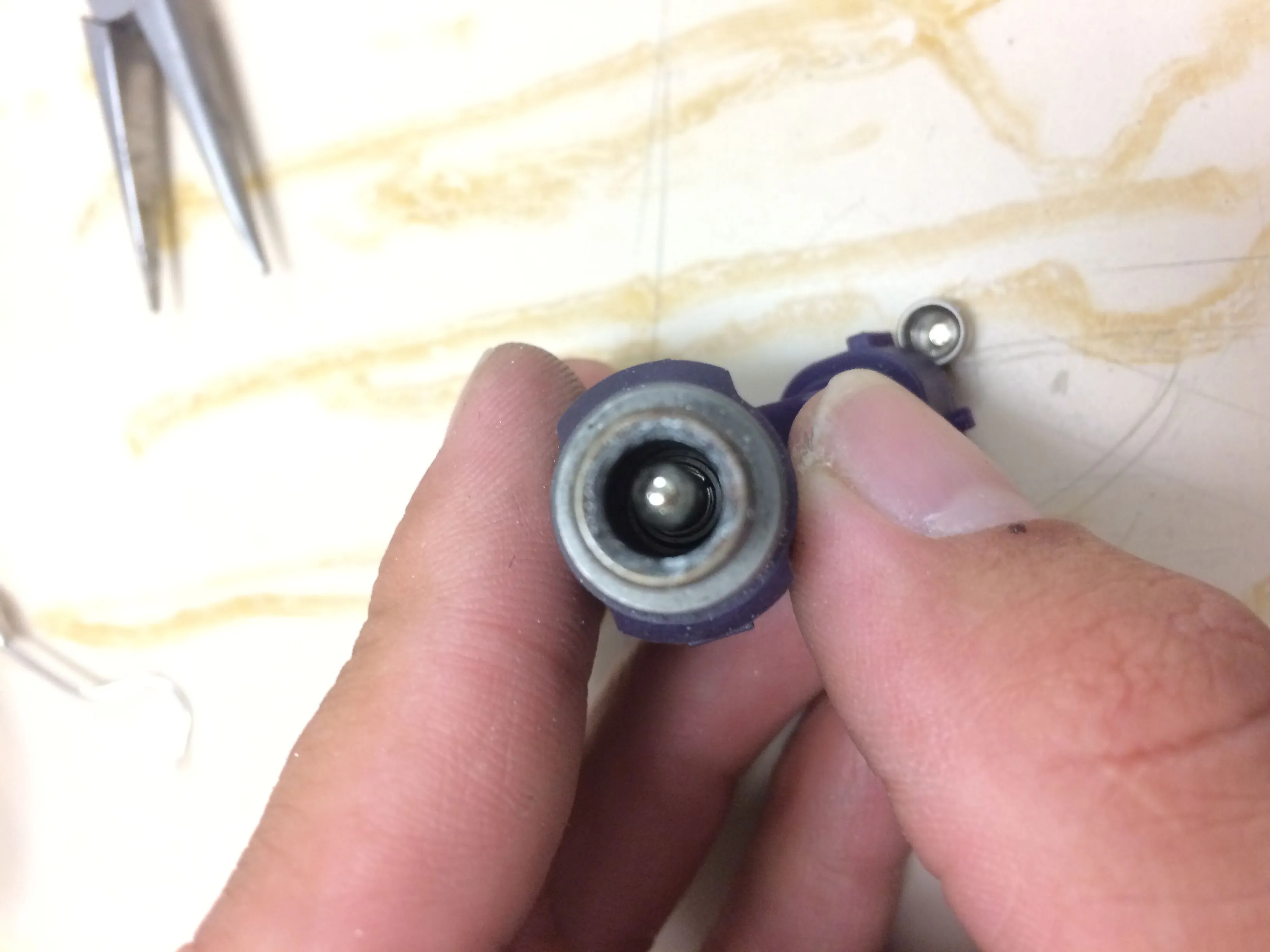

Fuel injector caps are a restrictor and help change the spray pattern, but it looks like our OEM injectors in fact don't have such caps. The "cap" is actually the entire piece and once removed you can dissemble the whole fuel injector. try and clean that out of a cylinder head... yea no thanks.
Here's my experience decapping these injectors.

Was worth a shot. If this was possible, I'm pretty sure the WRX 440cc injector wouldnt be such a popular mod when desiring more fuel
Yup makes sense after the fact, now does anyone have a set of WRX 440s or STi 565s up for grabs?
