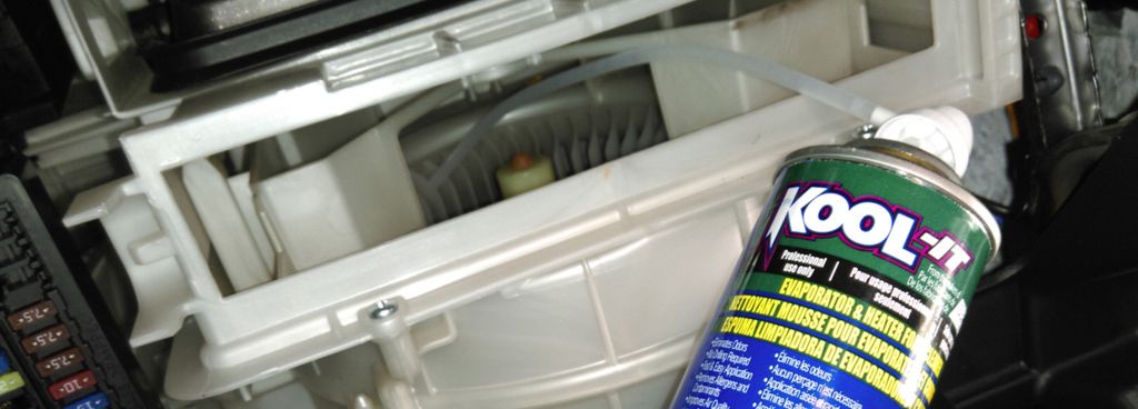

Just curious - have you used the LubeGard Kool-It product yourself?

Hi Pete,
yes, I've used the Kool_it with good results to get rid of the mildew smell,
I couldn't get the Kool-It tube thru the drain tube at the undercarriage,
so I fed the Kool-It thru the fan blades below the cabin air filter,
but I think the vacuum method will work better for you since that will actually suck the particles out of the system
give it a shot, nothing to lose and maybe save $$$ from an evap cleaning, hopes this helps you and you resolve your dad's CX-9,

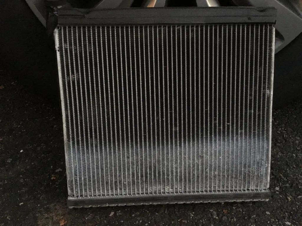

I got the 9 back last night. After discussing the issue with the mechanic, we agreed that it was probably best to replace the heater core along with the evaporator core while the dashboard was apart since it only raised the cost of the repair by about $150. Since the bulk of the cost of this repair was labor time to remove and reinstall the dash I thought it made sense to do the heater core too......especially since the vehicle is over 8 years old and has 133K miles.
The total cost was just over $1K - by far the priciest repair I've ever paid for on any vehicle. But I know others that have paid a heck of lot more for other types of repairs (engine, transmission, etc.) so I'm not going to complain because I've had very good luck with all vehicles I've ever owned.
I had him save the evaporator core for me. It's bigger than I would have imagined - it's almost 12" square. You can see a transition of color on the core, which I assume might be the area (on the bottom 1/3) that may have been sitting in water for a long time due to the clogged drain line. He told me that area had a thick coat of white powder on it but during removal, most of it fell off.
I'm still surprised that others here haven't run into this issue, but I assume it must be related to the amount of time the evaporator drain line may have been clogged.....IF that's really what caused the white powder. In any case, a good reason not to let the issue go on for very long.
