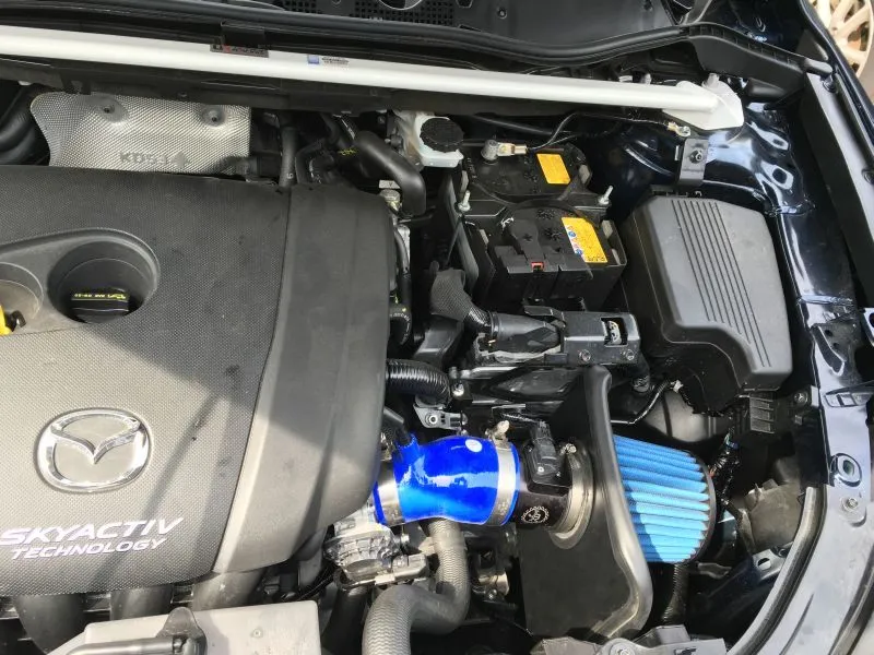

Mod 1: JBR SRI Intake Looks great and definitely louder!

Mod3: Ultra Racing Strut tower brace.

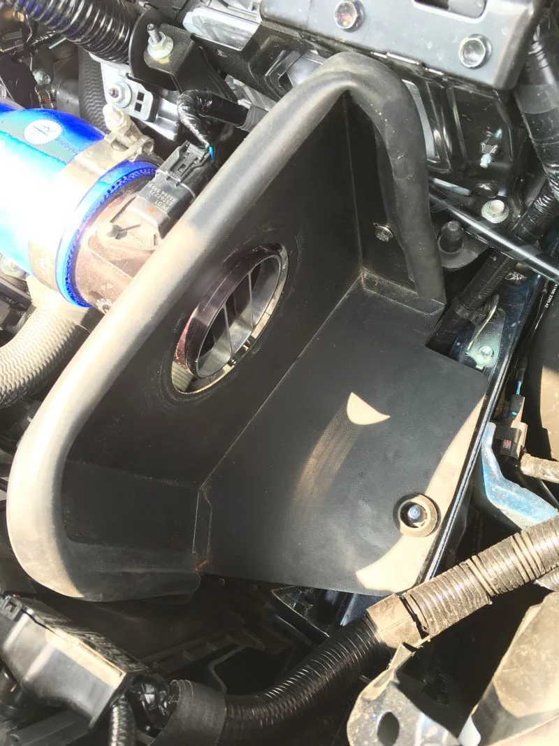

Modified K&N shield from my Mazda6 to work in the CX-5!
Shield itself required zero mods, just needed to trim the filter opening seal as the JBR filter was larger in diameter.
I know it's not a perfect seal from engine heat but it's a LOT better than before!

Now to duct some outside air to the box!
I trimmed the hood seal to allow air in the box area.
Thinking about trimming the area above the fog lamp for more cool outside air!

Yes, the SRI needs a heat shield for summer,,,, Modifying my K&N shield from my Mazda6 to fit the CX-5 to help until something better comes out.

Cs has an air box oem style for sris
