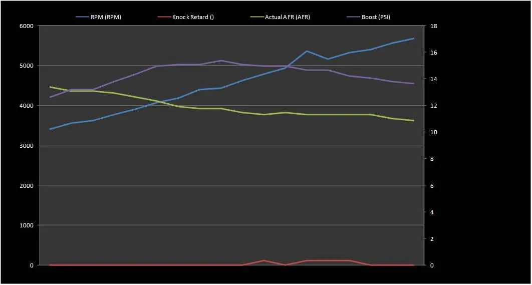

i ran a few of them but was still trying out how to figure this ap out. heres 1 and i cant seem to find out why my boost sucks so much dick.

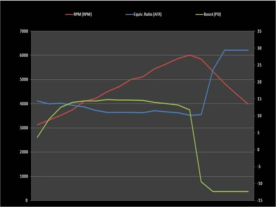

it was something like....40 degrees out and i couldnt get any run to hold boost above that 15.5 mark. i checked all my clamps and such and cant find anything wrong. this was i believe a 4th gear pull. should be full boost. idk.
also what would be considered an unsafe knock. i get a spike upon normal driving once in a while and i did a run from launch-5th gear and had a knock of 5.6. i know some people run near 8 sometimes and im quite sure 5.6 is nothing to worry about esp since it doesnt happen all them time but just wanted to ask. still getting used to learning the ecu s***. thanks.
i couldnt run the stage 2 sf 93 map because i hit fuel cut so imrunning the stock map on cobbs site. i have cobb dp. 3" custom tbe 1 cat and muffler. sri. plugs. motor mount.
There is nothing wrong with your boost. That is how much you get on the stock map. Why would you expect more if your not running a cobb tune? Get a fuel pump and run the cobb map. Part throttle knock is normal and nothing to worry about. If you get above 2.0 at WOT then its a problem.
alright. yea i figured i would be getting something like 16 psi through WOT until the drop off at around 5800. waiting to buy the pump so i can get her purring like a kitten.

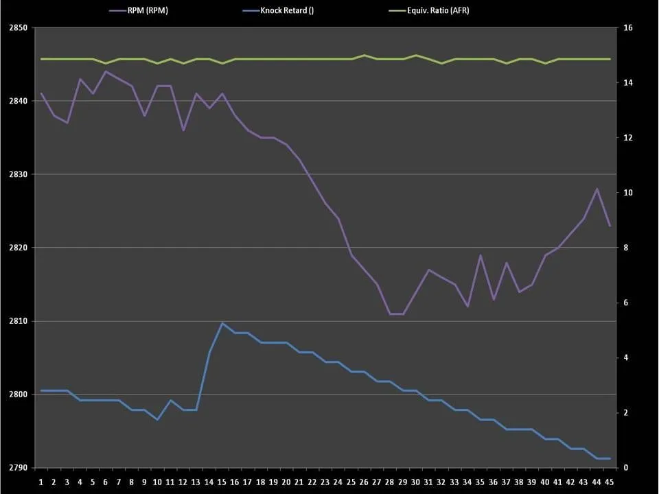

ok so i ran some more data logs this morning on the way to work. 3-4 3rd ger pulls, a 4th gear pull, and cruizing at 75 under light load up small hills. i gotta say....im not a fan of the knock that comes with small hills on several occasions. i was hitting 6.7 and it was bouncing around from 1-6.7 for more than a few seconds about 4-5 times in a 35 mile hike. ill post some of the logs when i get home from work. im not going to say it was the fuel because i shop the same fuel from the same place in a heavy traffic area. 93 shell v power. keep in touch and let me know what you think around 5pm.
wow im not getting knock like that with my tune, i got occasional but only for about a second, kinda like a spike and then its gone.
on hills I will get sustained knock retard up to 5.9. If you are running the stock map it has nothing to do with the ap.
so with the tune that should be corrected for the most part correct?
and does this happen if you bough tthe car off the lot? thats something mazda probably should have looked into am i wrong? im pretty sure a knock of 5-6-7 over 100,000 miles is fatigue galore on pistons n' rods.
part throttle knock retard is caused by the ecu trying to maximize fuel mileage by pulling timing. The 5.6 knock you saw likely occurred when you let off the gas. Spikes are usually false readings. If you were getting consistent knock it would spike and add timing back slowly.
commenting on your earlier post that would explain why i got a spike of the 6.7 kncok and it returned over the course of about 3-4 seconds. slowly making sense to me. im going to keep picking your brain dread. your a mountain of knowledge for me. lol.
Knock retard does not necessarily mean that you are getting detonation. Christian has told me several times that KR at part throttle is normal and nothing to worry about. The ecu pulls timing to conserve fuel while cruising and that is what you are seeing. KR at wot is bad on the other hand. you don't want anything over 2.0
